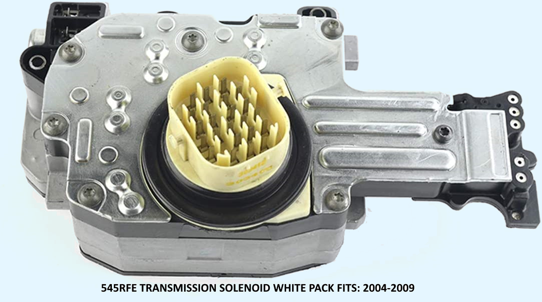

You probably should start with a good full transmission service, new Mopar filters & ATF+4, and replace the Shift Solenoid with a new one.

P2706 -- General malfunction with the transmission Shift Solenoid Circuit.
Possible Causes:
    1. Dirty or Low Transmission Fluid
    2. Dirty or clogged transmission filter
    3. Defective transmission valve body
    4. Restricted hydraulic passages
    5. Transmission has internal failure
    6. *Faulty shift solenoid (*most common)
    7. Faulty or damaged wiring
    8. Faulty TCM
    9. Faulty Shift Solenoid Circuit
    10. Shift Solenoid harness is open or shorted
    11. Corroded or damaged connector
    12. Shift Solenoid Circuit poor electrical connection
