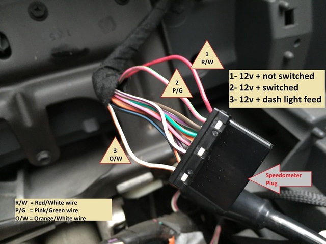

For the short term, I went with Glowshift's boost-only gauge. It works great and seems to be a quality piece as compared to the cheap-o ones I previously posted about. To what fuses or wires did you connect your red and yellow and orange wires?

I pulled the speedometer cluster and tapped into the wires feeding the connector.
Used the unused blind threaded boss on the intake to connect the boost pressure line. See pictures
Drilled a small 1/8" hole into the intake in the back of the threaded boss, and then re-threaded the threads to 1/8" NPT's. :wink:
