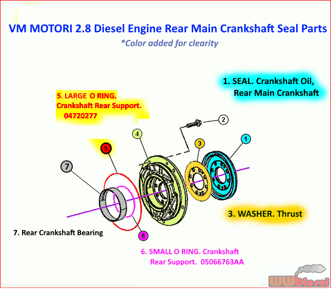

looking for advice on correctly installing the small orange. I got the idparts kit with the rear main seal a big o-ring, and a small o-ring. the big o-ring and seal are self-expanitory, but the small o-ring doesn't seem to have a groove to seat it in the new main seal. any help would be appreciated.

You could contact CaptainDean (message or email him) on this forum, he probably has the most experience with rear main seals on this engine that I am aware of.
Maybe this will be of help?

Thank you. I need to double check that I switched over the thrust washer properly.
