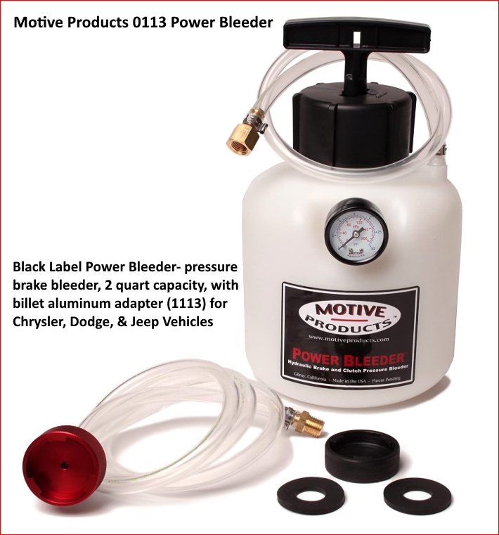

I just flush them using a Motive Products Power Bleeder model 1113 for Mopars, nothing special required.
Suck out all the old fluid out of the brake reservoir, refill with new Dot 4 fluid and then using the power bleeder bleed each wheel until new clean fluid is observed. :D
