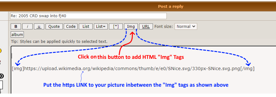

fjdiesel wrote:
Here is a pic of the 40 from a couple weeks ago. Its at a rest area on a little 2 lane on the MN/SD border.
Your picture is not showing.
You must post your picture to one of the web picture hosting services first, and then post a link to the picture inside the [img]Link[/img] HTML Tags
You can click on the "Img" button in the menu above to insert the HTML Tags.
It should look something like this:
[img]:https://upload.wikimedia.org/wikipedia/commons/thumb/e/e0/SNice.svg/330px-SNice.svg.png[/img]
