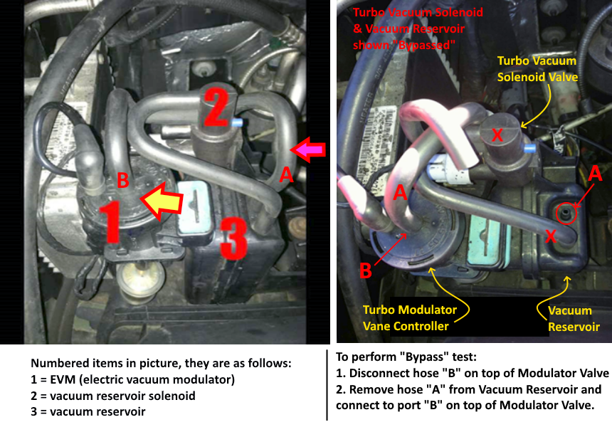

Check all your vacuum lines and hoses very carefully going to the turbo controls, vacuum solenoid, and vacuum modulator valve, and especially the one from the vacuum modulator over to the turbo actuator. The factory vacuum lines can get holes in them or the plastic ones can get briddle and snap or get to hot and collapse preventing proper turbo vane control. (See second picture below of bad factory vacuum lines/hoses) Replacing all the factory vacuum lines and hoses with silicone ones is a good mod as the silicone ones are impervious to heat and oil and won't collapse.
You can also do a vacuum solenoid bypass test to make sure the turbo vacuum solenoid is not causing problems. See pictures below.

Only had time to bypass the vacuum solenoid and that provided no change in symptoms. Tomorrow I'll dig into the intake side and see what the situation is. I see that intake elbow kits for these trucks are still readily available so maybe it's time to just bypass all EGR stuff. We're in PA anyway, so no emissions requirements for diesels.
