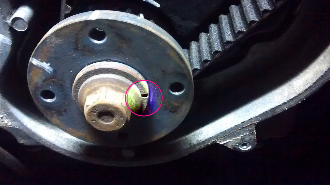

I knew I would be doing this, just was trying to put it off for another 22k or so! I'm at 278k and curiosity got the best of me. This is more a story than anything, so far I think I've got it handled! (mostly thanks to all the info on this site)
It started with a lack of power when taking off, like really bad turbo lag. Mostly did it when it was really hot out, like me, she just doesn't like that weather. I thought it was the turbo, so since the guy I bought her from had given me a spare, I put it on. Seemed a bit better, but it wasn't real hot out yet. Well, it got hot and the lag returned. Then last week it started squealing around 2-2400rpm, sounded exactly like a serpentine belt squeal, but would do it without the belt on, and unplugging the vacuum from the turbo made the noise disappear. So I decided to put the other turbo back on, as it was clearly not the source of my lag problem. I'm not sure what's wrong with the new turbo, it's tighter than the old one and everything looks perfect...
Anyway, I got the old turbo off and started eyeing the engine, I've been suspicious of rockers for some time and 22k is a long way off when I'm not driving a whole lot. Since I've also got some time on my hands...
So I decided to "inspect" the timing belt. Previous owner said it was done at 200k (no reason to doubt that), but I don't think they did rockers or anything like that. What I also don't know is how long ago 200k was. I don't remember if he told me or not, my memory is kinda fuzzy. So down to the timing belt I tore! And I get to it and it's not terrible, but I don't know, seems kinda iffy. So I debate whether to just do it now. I line up the timing marks from the last time the belt was changed, and uh oh... the crank bolts are not where I expect them from what I've read here. and no, the pin (well, drill bit) won't fit the crank hole... turn it back until it will and the crank is where I expect (keyway at 3o'clock), but now both cam paint marks are one tooth to the left...
Well ain't that something? So I try the cam pins (just feeling with a allen key) after much fiddling, it seems like the exhaust cam is right and the intake is off by a tooth, or maybe they're both off by a tooth (which would match the paint marks), I can't tell 100%, I really need the proper pins.
So I debate buying the tools and correcting the timing or the belt kit and just being done with it. or should I look at the rockers while I'm in this deep? After much deliberation, I decided to just buy the tools, correct the timing, and see what happens. So bright and early the next morning I go out, ignore all that, and manage to pull the cam sprockets (without the correct tools) and then the intake. I had a fit with the #4 injector, and all 4 were missing the o-rings, so now I need to clean the holes out. Hopefully nothing too bad fell in, I washed the engine before I started and blew out what I could before I pulled the injectors, but the holes look kinda muddy... Also the #4 crush washer didn't come out with the injector, so I have to retrieve that later.
I only found one bad rocker (roller was loose), but 5 bad lash adjusters (looked like the little retaining caps have been hammered?), so I decided to play it safe and just do them all, so it's all ordered and hopefully will be here by next weekend! Still a lot of prep to do before then, but maybe among all this I'll fix my lag! Gotta keep my little Jeep happy!
2005 Jeep Liberty Sport CRD 4x4 278k

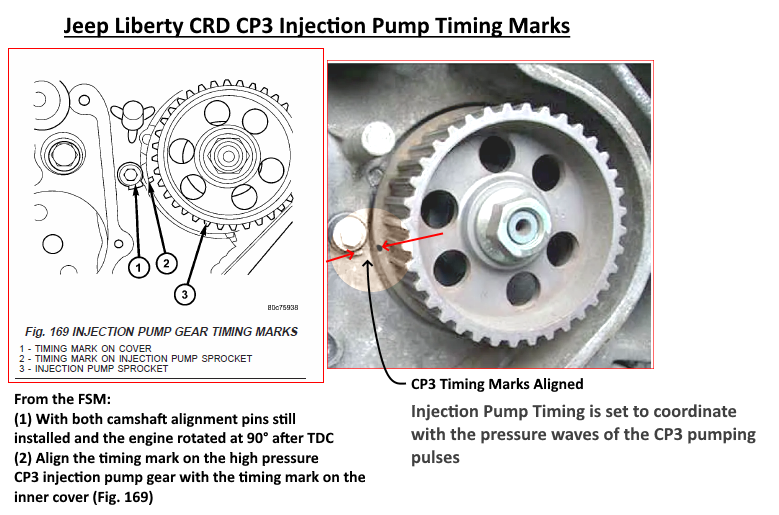

be sure and align the timing mark for the CP3 injection Pump when timing the engine back up.
Crankshaft timing mark/dimple.
