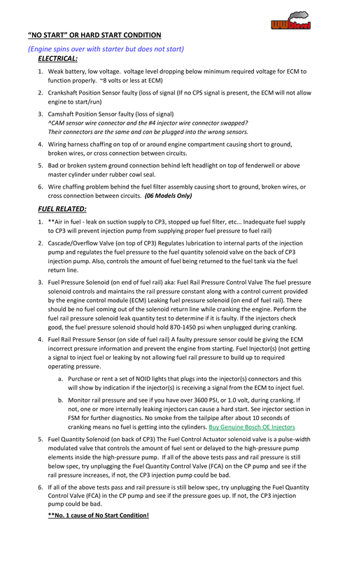

I found this (thanks again WW): https://postlmg.cc/vc761TZs and will work through that today. My question is thus: To rule out the CPS can I swap his with mine (2005) without any issues?

05 & 06 CPS are the same, swap away.
When a no start condition happens, you need to determine if it is a fuel starvation related issue or an electrical issue which is preventing the ECM from injecting fuel.
Have you tried pumping up the fuel filter head to ensure the CP3 is getting plenty of fuel? Also could be a stopped up fuel filter?
No fuel return from an injector during the starting sequence is normal. There should not be any!
See this:

I took that list with me and going through everything easy I saw #6 and went DOH!
And also realized there's a CRANKSHAFT sensor as well as the CAMSHAFT sensor...
Didn't think about pumping up the filter head, another easy try before I have to dig in to the harder stuff.
