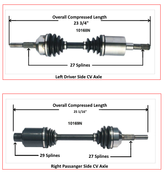

Front – Driver/Left side - NCV 940085-- CV Driveshaft Compressed Length 23.74 in.
Autozone: Line Duralast Gold:> https://www.autozone.com/drivetrain/cv- ... 401987_0_0
Front – Driver/Left side: 10168N -- CV Driveshaft Compressed Length 23.74 in.

Thanks for list of suppliers. Went with NAPA as they have been good quality and price in past. Hope they still are. My passenger side CV axle replacement was NAPA, so should be a good match.
Really wanted an American made part, as all Chinese stuff is hit and miss. But from what could see, nothing was listed as American made.
Even Moog is made is China now. But Moog parts still appear to be higher quality than most and higher quality than OEM Jeep parts.
Also made sure NAPA was CV axle was stock length. Saw thread where other member had gotten longer than stock lengths and it caused problems.
