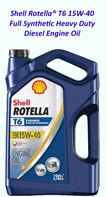

If you reside in a location where temperature allows, you are better off to run a heavier weight oil in your diesel engine to provide better protection.
Many owners run 15W-40 Full Synthetic like Shell Rotella T6 :D

Well oil certainly can be a Pandora's box; :ROTFL: :banghead: :dizzy:
Everyone has an opinion about what is the best oil for their engines and then along comes an Amsoil salesman pushing his brand oil.
Bottom line, do your own research and use the oil that best fits your needs and you are comfortable with.
My thoughts since you asked!
You simply don't hear of trucks with larger diesel engine running any 0w or 5w anything weights, they run heavier weight oils like 15w40 or 15w50 for millions of miles over the road hauling freight.
The only reason Chrysler/Mopar recommended using 0w-40 or 5w-40 oil in the Jeep CRD was to try and meet CAFE standards set by the EPA for the 2005 & 2006 models. It certainly was not for engine protection and longevity beyond warranty mileage! :furious:
Several years ago, quite a few owners including myself switched to using Shell Rotella® T6 15W-40 Full Synthetic Heavy Duty Diesel Engine Oil in their Jeep Liberty CRD. I now run this same oil in my Dodge Cummins, and my diesel tractor, I was running 15w50 Royal Purple in them but the Shell T6 is more cost effective.
from Shell wrote:
Shell Rotella® T6 15W-40 Full Synthetic Heavy Duty Diesel Engine Oil is designed and formulated to provide improved performance compared to conventional and semi-synthetic products.
It is suitable for virtually all modern low-emission heavy duty engines and older hard-working diesel engines. With its wide range of specifications and approvals from many of the world’s leading engine makers, it is an excellent choice for on-highway fleets, general haul, construction, agriculture, public-transport operators and diesel pick-up trucks.
Shell Rotella® T6 15W-40 Full Synthetic Heavy Duty Diesel Engine Oil is designed and formulated to deliver
    • Exceeds wear protection API CK-4 standards
    • Improved wear protection for diesel engines
    • Increased protection against oxidation
    • Enhanced deposit control/cleanliness
    • Better low temperature flow
    • Excellent corrosion control.
Shell Rotella® T6 15W-40 provides better cold cranking properties and low temperature pumpability at -15C compared to conventional and synthetic blend products. That means it reaches critical engine parts faster in colder temperatures.
