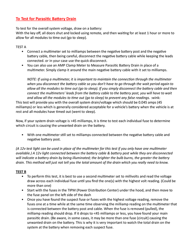

See this guide below, and watch the YouTube videos on how to properly test for parasitic drain on a battery. Hopefully this will help you find your drain. :D
Good luck! :banghead:
There are plenty of YouTube Videos if you search which shows how to check for parasitic drain on a vehicle's battery.
Here are a couple samples:
https://www.youtube.com/watch?v=lRcj1fQ ... FmUQ%3D%3D
https://www.youtube.com/watch?v=jnQ3qCY ... FDWQ%3D%3D
Test for Parasitic Battery Drain
