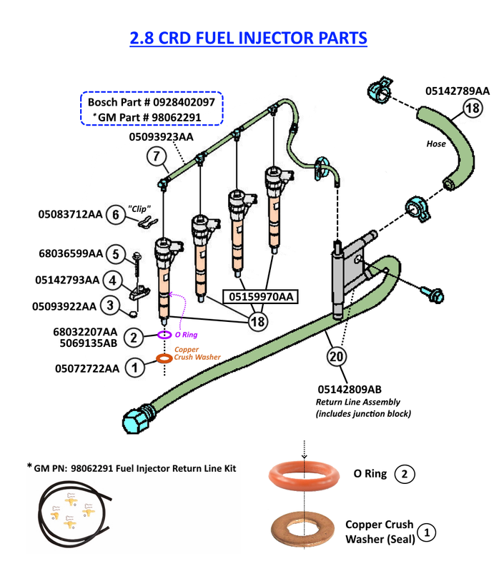

I am looking to see if there is a specific part number or a generic size to buy for the fuel return hose the goes from the solenoid to the distribution block?

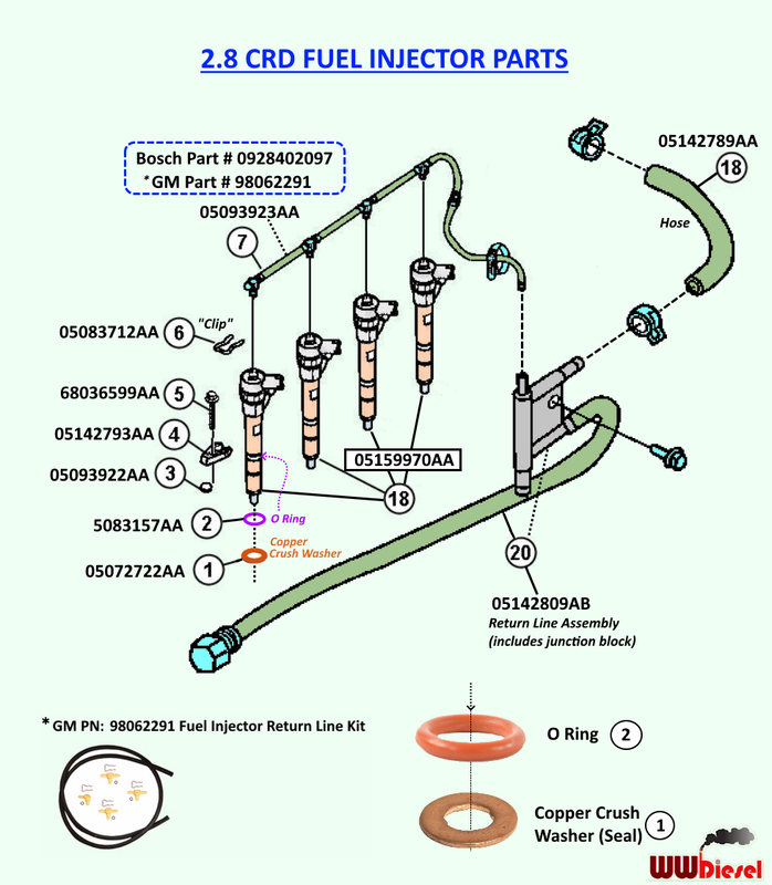

Injector parts:
 Post subject: Re: Fuel line part number
PostPosted: Tue Jul 19, 2022 6:30 pm
Joined: Wed Feb 20, 2019 2:58 am
Posts: 90
That answers that, of course it isn't available anymore, I'll take it down to the parts store and find a soft replacement and see how it goes.

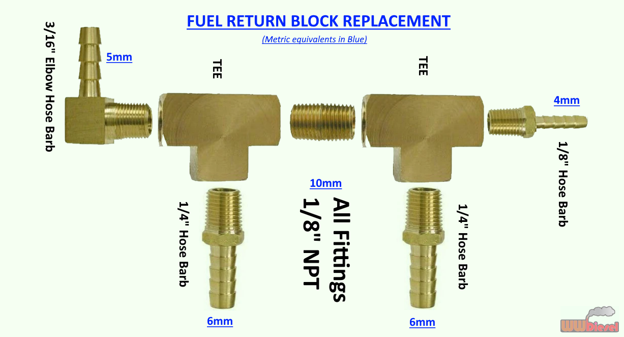

Any good "Diesel Rated" hose of the correct size will function without any issues.
I believe the size is 5mm or 3/16" hose? Remove your old hose and use it to match up some new hose at the parts store.
NAPA should have the correct rated hose and size you need.
Be REAL carful of that plastic return line junction block, they are notorious for breaking.
If it breaks, you can make a new one out of a couple of brass"Tees" and some brass hose barb fittings.

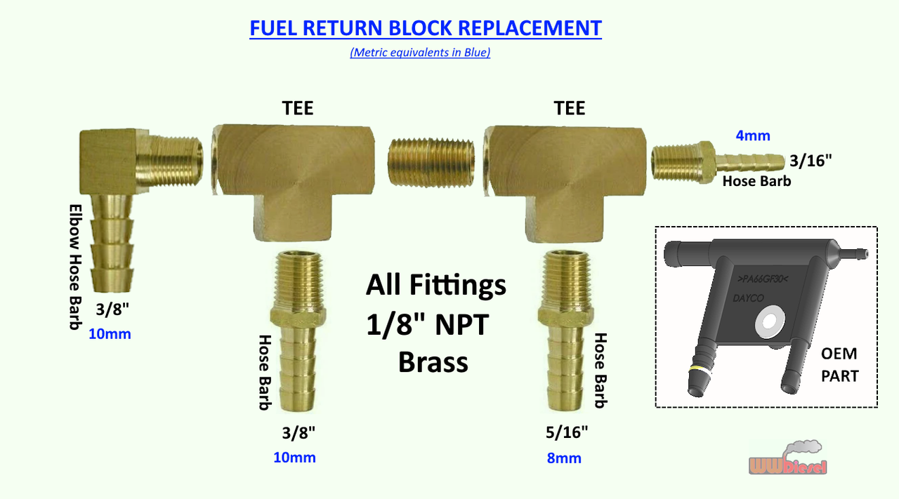

OEM: Fuel Return Block. Part Number: 05142809AB See image 2 below
Home made Fuel Return Block out of brass fittings:
Fuel Return Block:

Just a little question, why did you use a 3/16" elbow instead of a straight one ?
Did you change fuel return line rooting ?
PostPosted: Sat Oct 07, 2023 11:30 am
Posts: 7387
Alexis wrote:
Thanks a lot !!
Use what you like!
Elbow just seemed to make more sense to me for hose routing.
Nothing wrong with using a straight fitting, it would work just fine as well. :wink:
