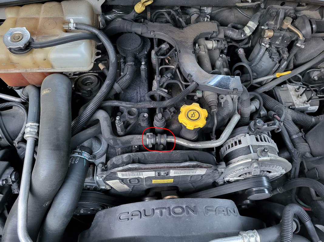

I'm trying to identify what the tubing is for on top of the engine, directly behind the timing belt cover area, but before the first injector. (At least I think that's what I'm looking at.) I have a situation where I'm getting some gases pulsing out of that area. This is right where that tubing goes from hardline to rubber hose (at that connection). I was thinking that this must be part of the CCV, but it doesn't connect back to the puck. I can't actually tell where it goes, and I can't seem to find any info on it in my factory service manual either.
So does anyone know what this thing is, and where it goes on both ends? (It runs in the left-right direction. Left-side / passenger-side is the rubber part. Right-side / driver's-side is the hardline tubing part of it.)
In my case, I think the hardline tube is cracked or otherwise broken because it seems like the connection to the rubber hose is still solid. But I can hear the clicking/rattling/pulsing when the engine is running and smoke/gas vapors are puffing out of that area.

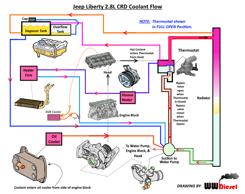

If its the 5/8 hose, it is the coolant return hose from the EGR cooler.
It is a rubber hose that connect to a Y metal fitting. (picture below)
If you are getting exhaust gases out of it, it means the EGR cooler has failed internally and allowing exhaust gases to be pumped into the engine cooling system.
See diagram below.
Best option is to block off the EGR exhaust feed tube and do away with all the EGR cooling lines.
Or better yet, totally remove ALL the EGR CRAP!
Post some pictures if you can, it would help positively identify what you are referring to.

Excellent diagram. I still need to purchase the Viscous heater delete kit from you.

It's been a while, but I'm finally getting back to this. Let's see if the picture link works. I am getting some kind of exhaust leak coming from this area (circled in red).
What is this tube/pipe?

That is the coolant return pipe from the EGR cooler on the drivers side of the engine. If you are getting exhaust out of this pipe, it means your EGR cooler is leaking and allowing exhaust gases to enter the coolant side of the cooler, or your head gasket has blown or you have a cracked head and exhaust gases is being pumping into the cooling system via the EGR cooler hose that comes off the center of the head. Exhaust and coolant should never mix!
No matter the culprit, it is not good for the engine. Exhaust gases being pumped into the cooling system will make the engine overheat.
Most either simply remove all the EGR crap off the engine or blank off the exhaust feed tube so it becomes a non-issue..
Are you losing coolant level in the coolant tank, liquid level dropping?

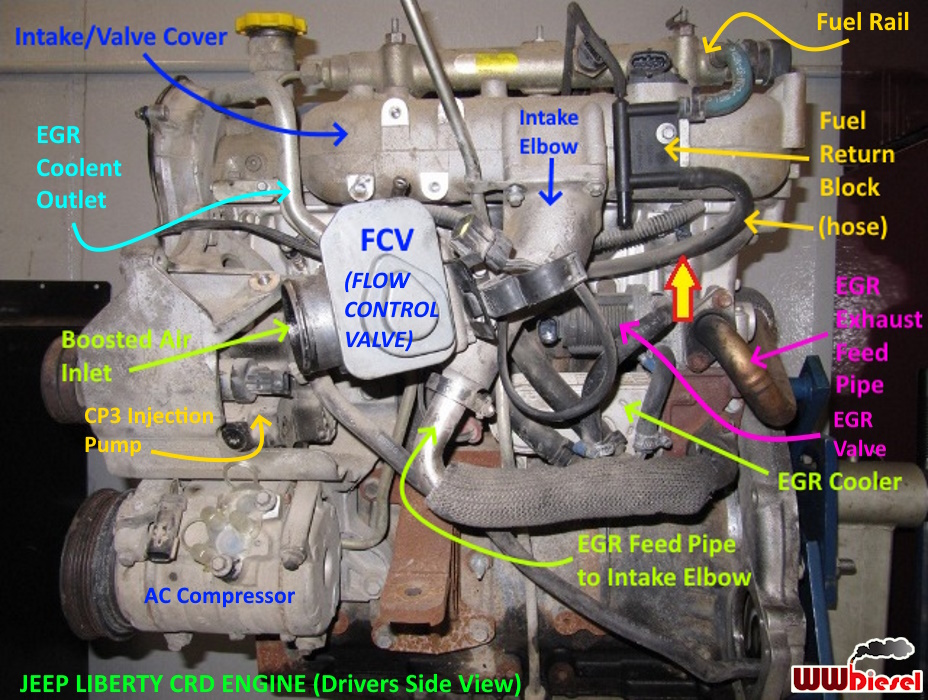

Maybe this will help you identify the EGR parts?

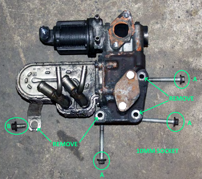

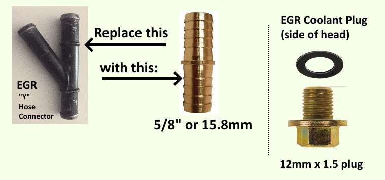

Eliminate the EGR cooler and all its associated plumbing (hoses) by removing the coolant hose fitting in the center of the head and plugging it with a *plug.
[*](12x1.5mm oil drain plug available at most automotive parts stores)
Remove the "Y" fitting on top of the engine where the return hose for the EGR cooler is connected by installing a simple straight 5/8" hose coupling.
The EGR valve & cooler is easy to remove, just four bolts holding it to the side of the block.
See pictures for details.
Need more help, just ask! :wink:
