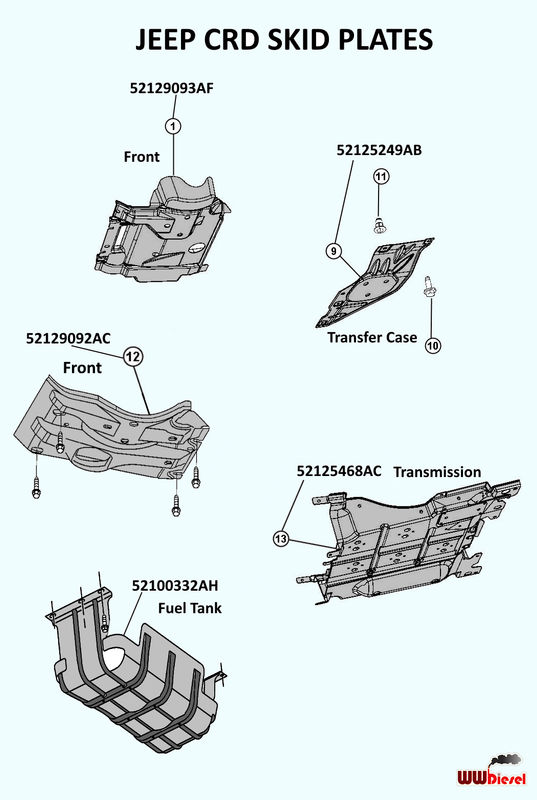

Were skid plates an option? Or came on certain models?
Are CRD skid plates the same as gassers?
I'd like to have a tranny and fuel tank plate but every KJ I check in the Pull-A-Part is naked.
Thanks,
1998 XJ 4.0L, 2" lift
First Jeep: 1962 Willys CJ-3B

I made my own out of some 1/8" sheet metal. The factory ones are not made out of very thick metal!

Factory Skid Plate Part Numbers:
Belly Pan Front Skid Plate, PN: 52129093AF [Without Front Suspension Skid Plate]
SUPPORT ASSY. Front Belly Pan PN: 52129290AC
TRANSMISSION SKID PLATE, PN: 52125468AC
SKID PLATE. Transfer Case, PN: 52125249AB
Fuel tank skid plate PN: 52100332AH

The skid plates are the same for the gasser and CRDs. If you can find them they will bolt right up. At most you will need to install rivnuts or nutzerts for the bolts to tighten too.
Like WW did, I too made a skid plate for the transmission and transfer case. But I have the engine skid plate and gas tank skid plate from a gasser and used them on my CRD.

Good to know that gassers are the same but I've checked the ones when I'm in the yard and no luck yet.
I do have a 1/4" piece of aluminum I was considering using. I'll take your dimensions WW and see if it is wide enough.
