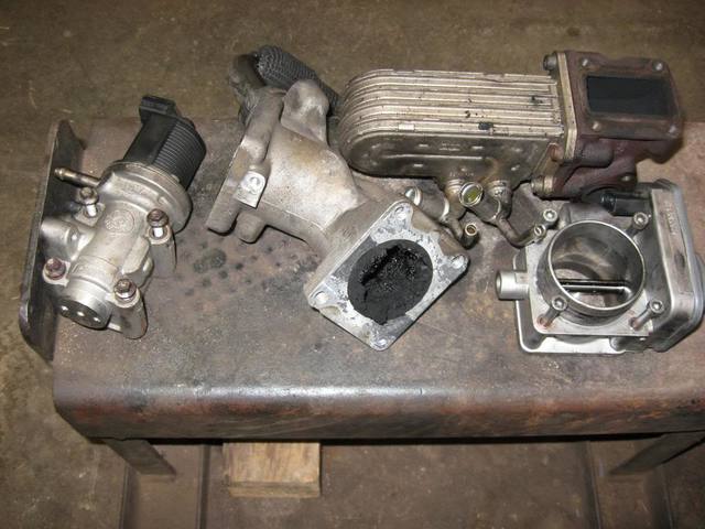

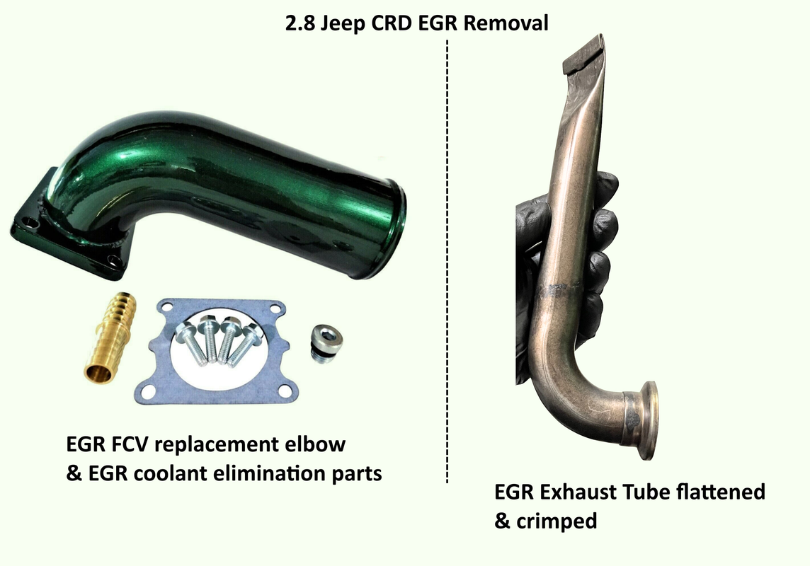

If you can remove ALL that EGR crap, it makes working on that side of the engine so much easier and your engine will love you for it. :D
All the EGR crap removed:
EGR Removal Parts
