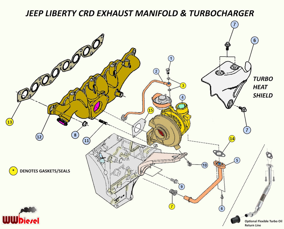

I found a mechanic and it’s the turbo. I ordered a replacement from Sasquatch parts. I’m only a few weeks from returning home from deployment and I’m mechanically inclined enough to where I feel comfortable replacing it myself. Anyone know what gaskets I may need to order when I replace the turbo?

PostPosted: Tue May 13, 2025 1:56 pm
Posts: 7387
IDPARTS.COM
https://www.idparts.com/turbocharger-c-29_117.html
1. Turbocharger Gasket
https://www.idparts.com/turbocharger-ga ... -3202.html
2. Turbocharger Oil Return Line Seal Kit
https://www.idparts.com/oil-return-line ... 10348.html
3. Turbocharger Oil Feed Line Seals
https://www.idparts.com/turbocharger-oi ... -3589.html
4. New Copper Pinch Lock Nuts M8 x 1.25
Optional: New Flexible Turbocharger Oil Return Line (comes with flange end gasket only) would still need to order #7 on diagram, Turbocharger Oil Return Line Bottom Grommet
https://www.idparts.com/turbocharger-oi ... -3208.html
FLEXIBLE OIL RETURN LINE

The task is easy to do. If you have the chance I would download the service manual an take a look at how its done and then maybe look on youtubevesity and see how others get it done. I can pretty much do it with my eyes closed. TIP: To get to the bottom bolts for the oil return line, it helps to have a couple of long extensions and a unversal joint or wobble head. Come at it from the bottom once you take the turbo charger support bracket off.
