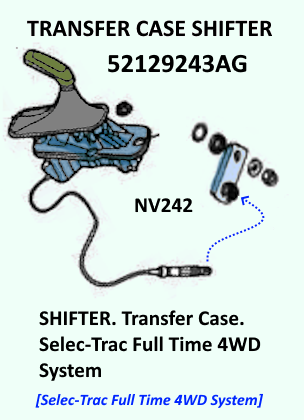

I found a cable part #52060462ag on the forum but I can't find anywhere it works on a Liberty CRD.

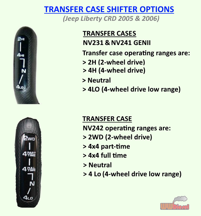

Which transfer case do you have, depending on model, there were three different options used in the Jeep CRD.
231, 241, & 242. They use different shift lever assemblies depending on model.
Command Trac System versus Selec-Trac Full Time 4WD System

I have the Np242.

DOES NOT FIT A COMMAND TRAC TRANSFER CASE!
Must be a NV242 Selec-Trac w/full time 4x4 available.
