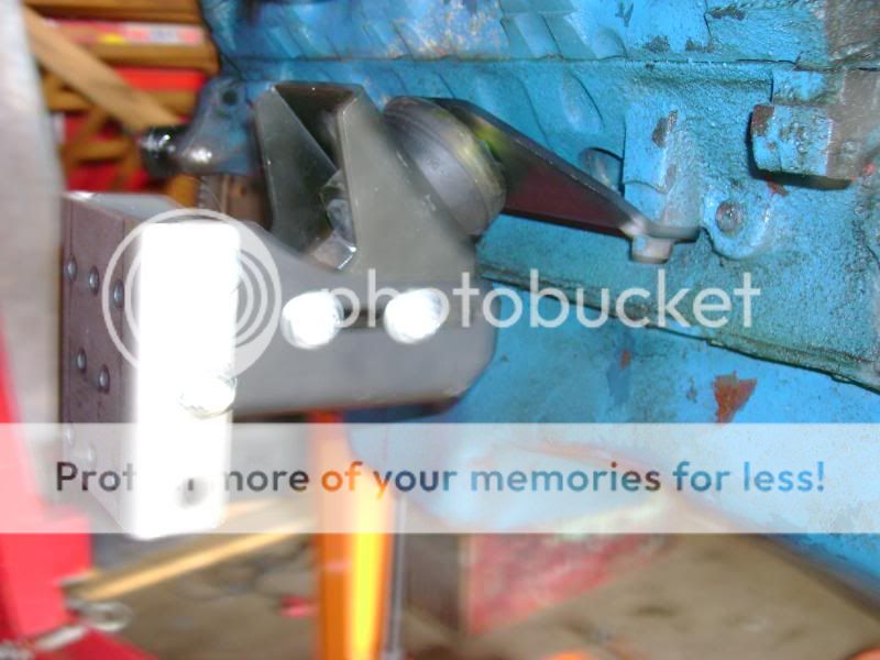

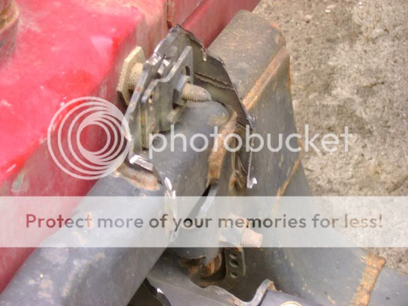

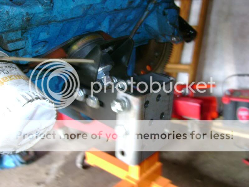

So I started cutting on the cradle today! No turning back now! Got the Pass side factory mounts cut off and ground down and ran out of cutting wheels for the grinder!!! :roll:
I'm leaving the side locating bolts in for now. Mine came with them, I think '03 on up doesn't have these so don't really know how necessary they are. I won't be able to use them with the cradle drop anyway. They may come out before it's done, but for now I'll leave them alone.
Moved in to the garage and started mocking up the Novak motor mounts. I need to modify them too. They will only adjust in to 26" and our cradle is 24" . There is room on the mounts to narrow them 1-1/2" - 2" per side so I've got room to play a little.

Just ordered these this morning from Novak Conversions. $307, except for the trans & transfer case the most expensive part so far.
This brings the total to $1588 so far. I could have saved some more money by fabbing my own motor mounts and maybe buying a less expensive brand of gauges.

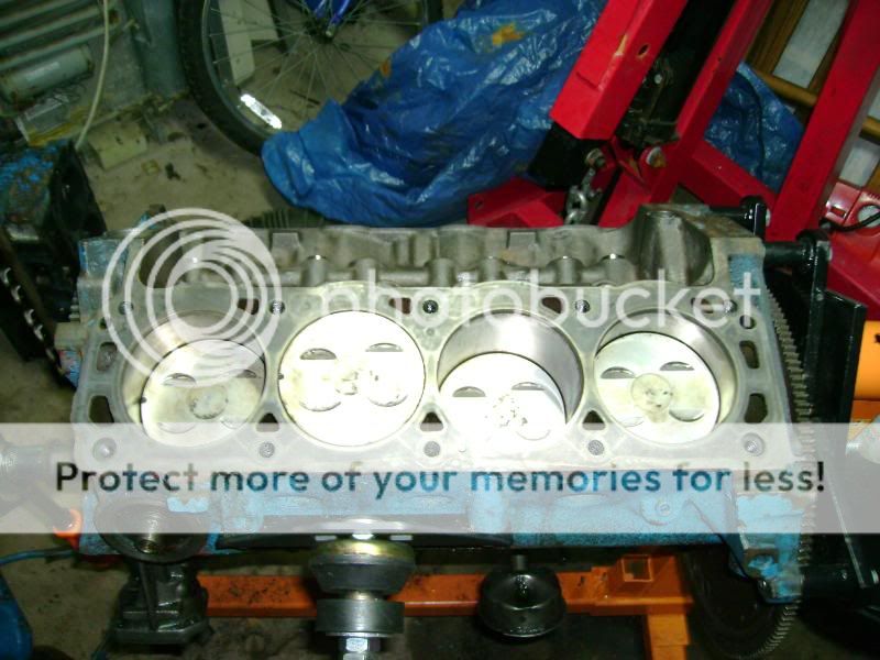

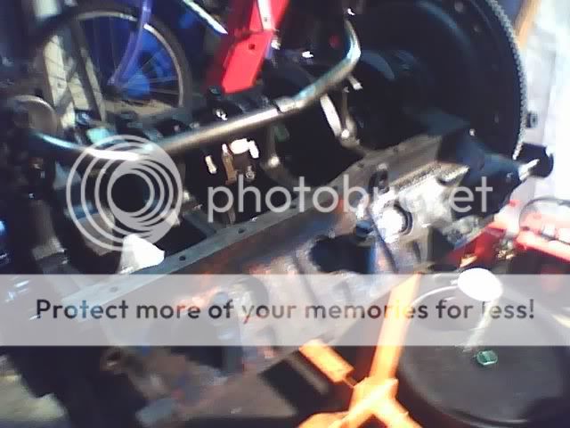

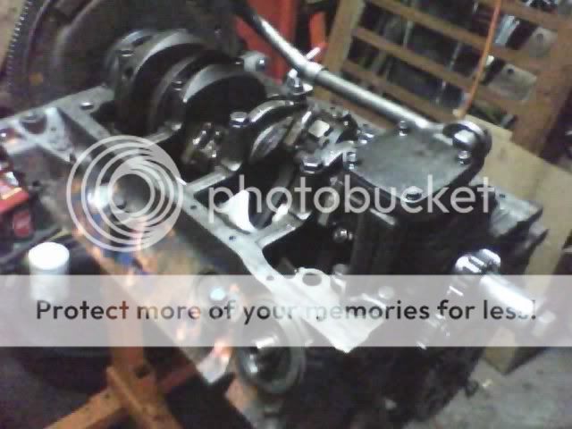

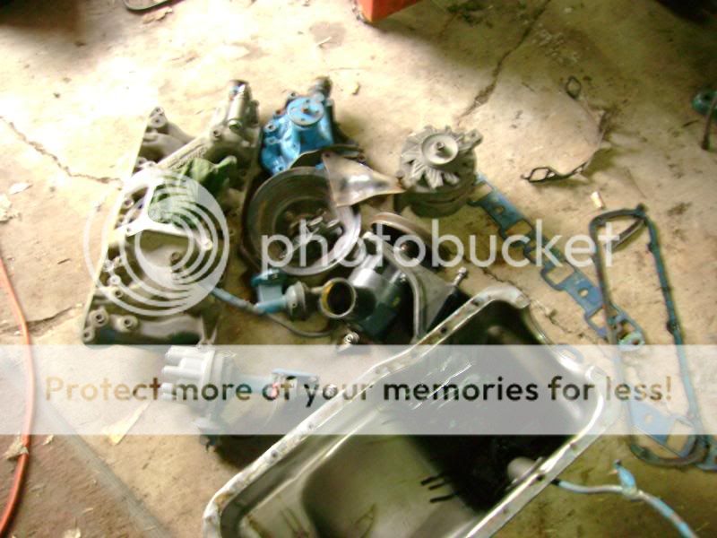

Got some more cutting wheels for the Metabo to finish cutting out the DS motor mount, but when I got to the garage today I got sidetracked. I started the teardown and cleanup of the 302 today. Everything is looking really good and clean with no marks on the cylinder walls, the cam looks superclean with no marks whatsoever and other than actually checking the crank bearings, I'm happy! I measured the rods as best I could without pulling the crank and they look to measure out right at 4.00" . I'm not sure what that means, maybe someone else (Troy?) can tell me if they are not stock. I will go ahead and pull the heads and check them too, maybe check the top of the pistons and cylinder walls from the top. I know on my V6 the pistons are stamped +.060, maybe these will be marked. If not I'll throw a set of inside mics on the cylinders and check them. I am going to have to clean and run a thread chaser in all holes. I found 2 oil pan bolts, 1 intake bolt and a water pump bolt that were not the right thread. 1 of the oil pan bolts was actually a sheetmetal screw! :shock: I am also going to need a new oil pan as you can see from the pictures below. It was cracked around the thread boss and someone just loaded it with RTV. I am taking quite a few of the pieces to work this week to be sandblasted and cleaned then the brackets and mountings will be powdercoated.
Staring the teardown and reassembly
Pile 'o Parts in the garage floor!
Oil pan that needs replaced.

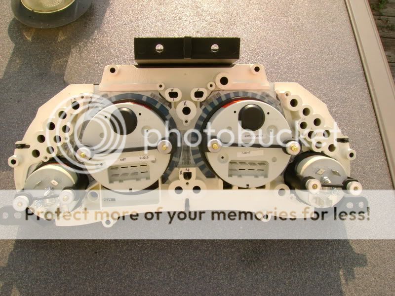

Got the speedometer mounted up in the dash cluster today. Now just need to decide how many and which of the warning and indicators I am going to use. I tried a small 12v 3/16" dia. push in lamp in the back of the dash and it works, I just need to figure out what colors and how many I need.
preliminary list:
---center of cluster -----
turn signals x2 = green
Hi beams x 1 = blue
low oil pressure x1 = red
trans temp x 1 = red
---left side of cluster---
roof lights x1 = orange
seat belts? naawwww
---right side of cluster---
4 lo indicator? -maybe- x1 = orange
fog lights x1 = orange
driving lights x1 =orange
lo battery? -maybe- x1 = red
Front, if you look close you can see which indicators are which.
Back, Yes, all electric gauges. The small holes are where the indicator lamps will go

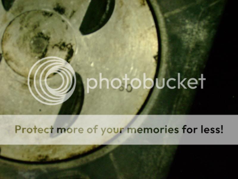

Pulled the other head tonight. Started cleaning head surfaces, getting old gasket material off. Got 1 side of the block done, I'll do the other tomorrow.
Piston tops marked .060

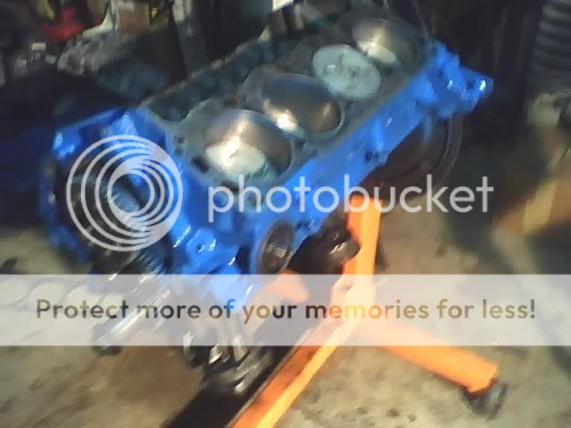

Cleaned the block
And Painted the block
Sorry for the crappy cell phone pics! :oops:

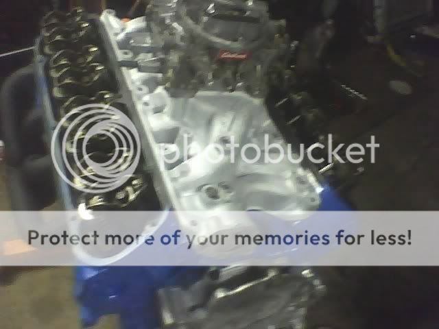

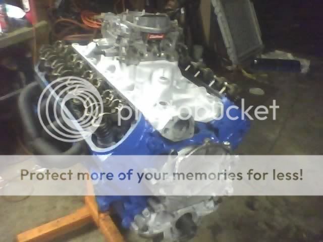

So ..... Stopped by Auto Zone and picked up a few things, stopped and picked up my trainee/muscle/copilot/18YO nephew Justin. Spent a little while tonight adding a couple 4' flourescent lights in the garage ( while he was finishing up cleaning the heads up for me :seuss: ). Double checked and wiped everything down 1 more time and set/torqued down the heads. Touched up some paint. Set the intake, headers and carb up for a photo op, then removed. Took an inventory of bolts for reassembly. I'm going to pick up new allen bolts tomorrow for everything.
more crappy cell phone pics
