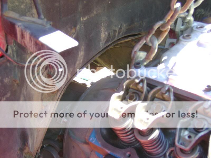

Lots of Firewall clearance! :SOMBRERO:
We located where the motor mounts could go, then where they should go, then where they needed to be. We ended up at the last one! It is going to be real close on the radiator clearance. We had lots of clearance everywhere else. Oh..... except for the stock crossmember. I am going to have to modify the crossmember, Thought it might just work, but I was MISTAKEN not wrong! :wink: The problem is clearance on the 1354 transfer case. The yoke for the front driveshaft doesn't have enough clearance. :banghead: So we will notch that part, reinforce it and drop that section 2".

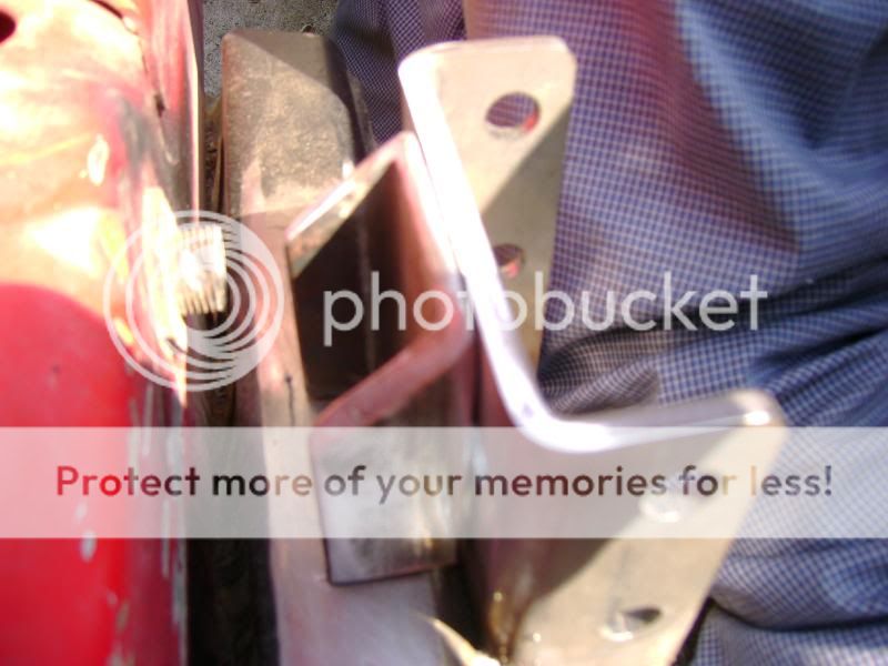

This motor mount is supposed to sit flat on a CJ framerail which is about 4" tall. Our cradle is only 2" so I cut some 3" C channel and we gussetted the back with that. It ain't goin' anywhere.

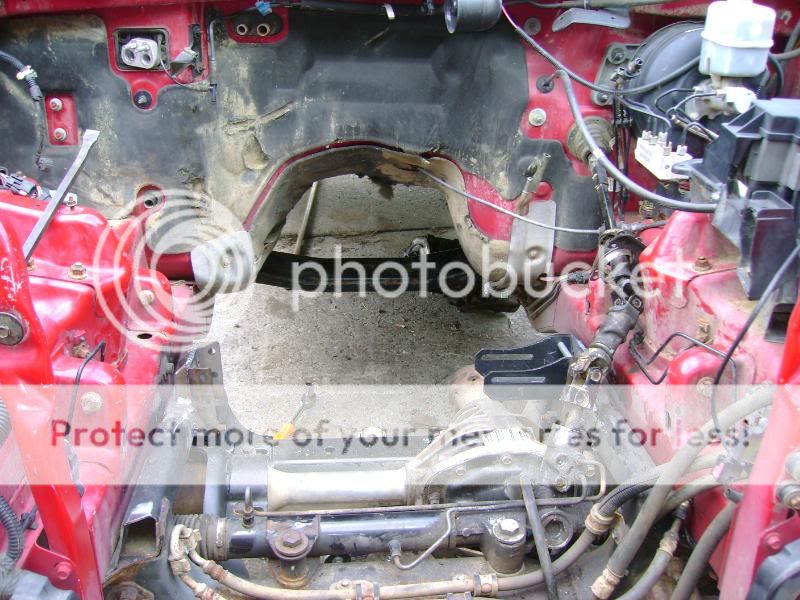

The trans crossmember is going to have to be modified rather heavily to clear the front driveshaft yoke. I am going to do the mods this week for the trans mount and then we will have to put the combo back in and out another time or two for those mods.

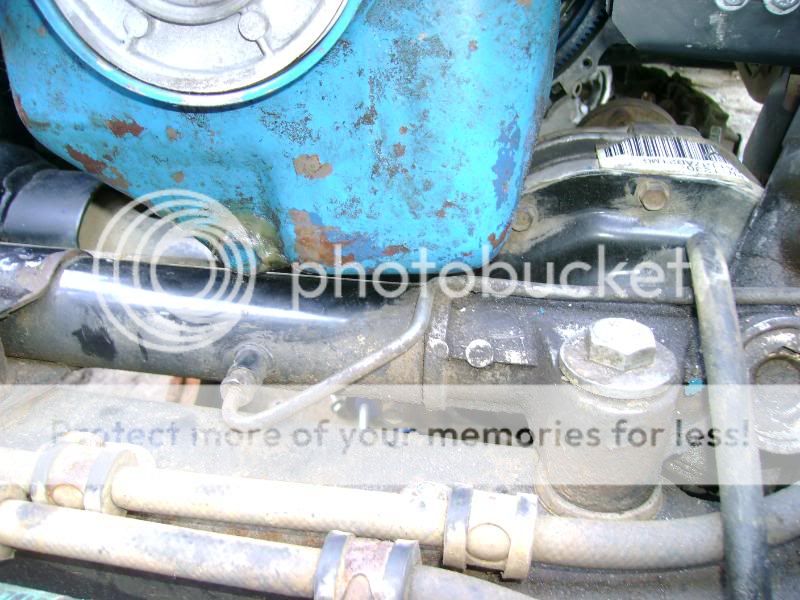

Oil Pan clearance at the Rack is close, but still about an inch away
We may have to modify the driver's side mount slightly for a little more clearance at the steering shaft where it meets the steering box.

Where's the pan drain plug since I take it the front one is now non functional?

It's getting a new pan, just using that one for the fabrication process. Since this motor is going in and out a dozen times, don't wanna ding up a new one now do we? There is clearance for pulling the drain plug there, and this is a "double sump" pan with a drain plug in both sumps. Gives me room to drop the motor a little lower too with the middle of the pan sitting over the front diff.
