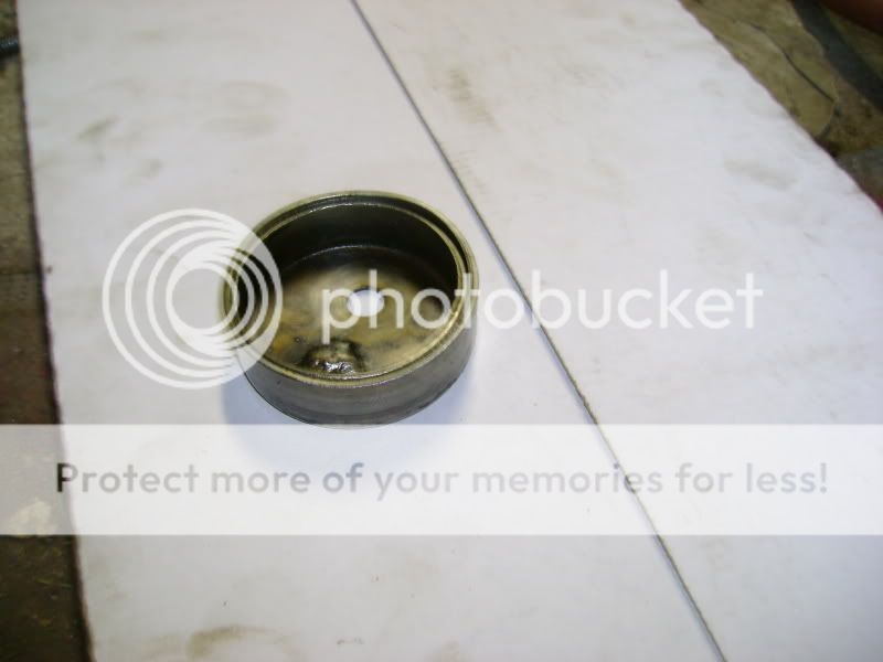

Well, didn't get it done Thurs, or Fri., so I went out this morning and took the waterpump and timing cover off. Made sure everything was cleaned off (I'm gettin excited) sorted out the gaskets, made sure I had all the bolts and laid them all out. Now I'm gettin real excited. Clocked the crank to TDC, Clocked the Cam to TDC, line up all the dots and marks and assembled the gear drive timing set to the front of the motor. Checked the clearances like the sheet said to and clearance was too much. Disassembled the idler gears and installed the longer idler pin that comes with the set, then reassembled to the engine and put the timing cover on. took the timing cover back off checked clearances .... perfect! Started to check the proper torque on the cam bolt with my Snap On Techwrench (ATECH3FR250) Torque wrench and got a code! :evil: ERROR 0 (it's digital) checked the book, gotta send it in, major error! :evil: Dam $500 Torque wrench anyway. Went back to my old school needle torque wrench and tightened the cam bolt, rtv'ed the gaskets and did final install of the timing cover and water pump. I may take the water pump back off and go another way but, for now, it's together. I thought!!!! :evil: Turned around and there on the work bench was laying this:
Anybody? ..... It's the cam follower for the mechanical fuel pump!! :evil: Now I have to take it all back apart, install the cam follower, retorque, get new gaskets, clean the surfaces again and reassemble!! :evil: It doesn't pay to get excited and in a hurry! :roll:

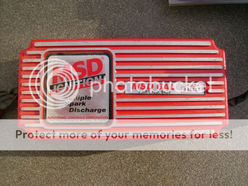

Got this.... an MSD 6AL ignition Box

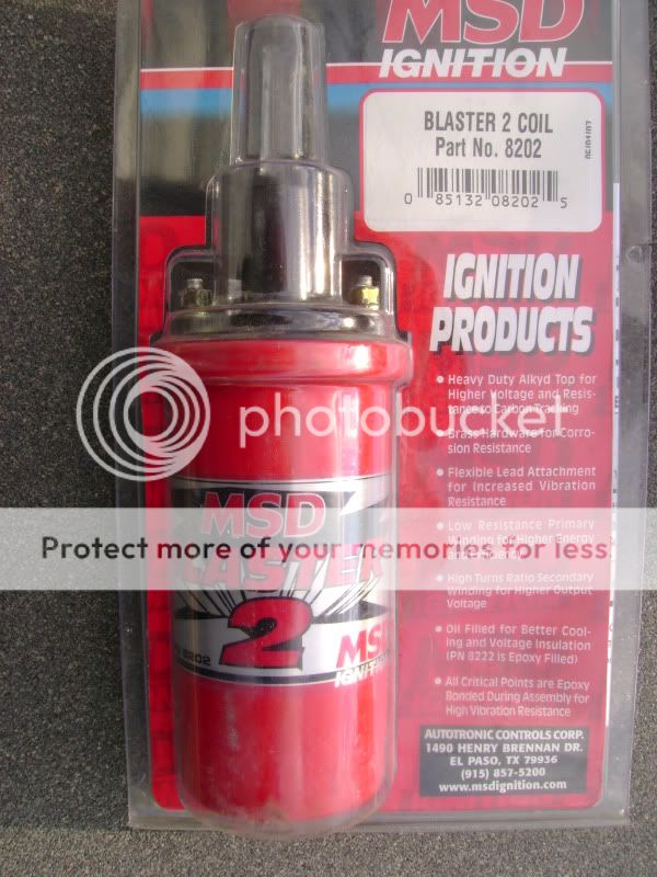

and I got an MSD Blaster 2 Coil

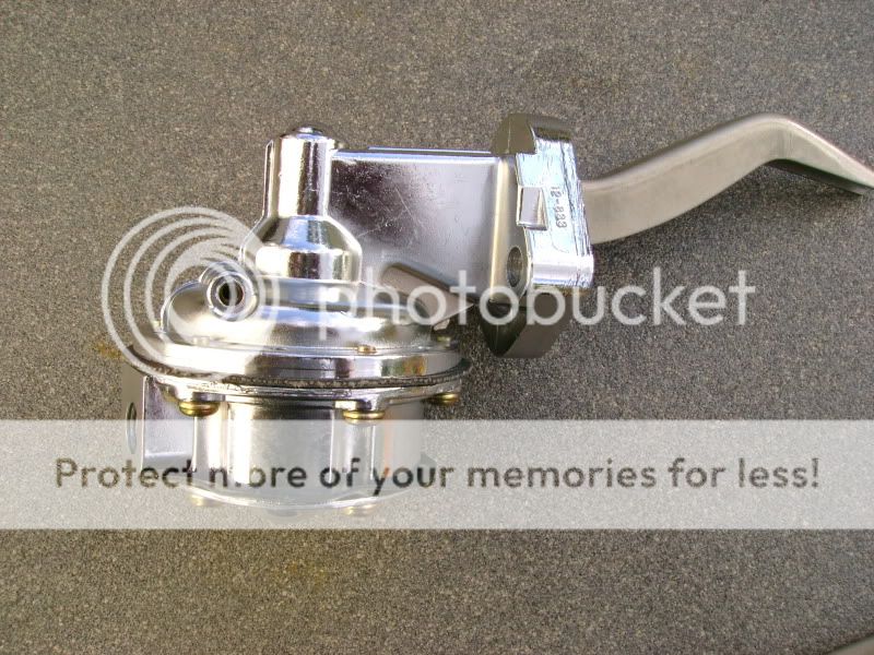

along with a Holley Performance mechanical Fuel pump, which I know will make me go faster, 'cause it says "High Performance" on the box !!! :SOMBRERO:
Here's the specs on the fuel pump
