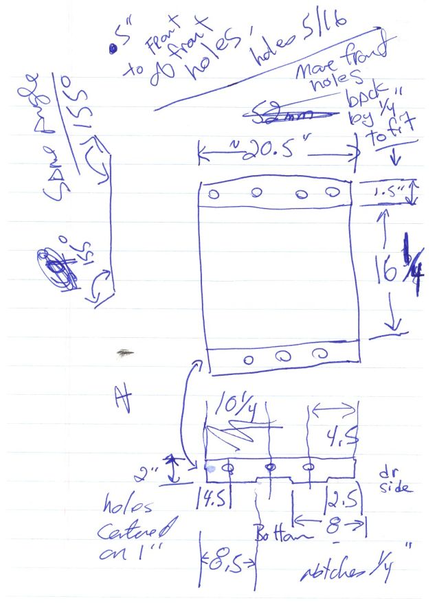

Here's another:
Can't seem to find a larger installed picture right now, but mine was built for use with an ARB and runs from predrilled holes in the bumper down to the factory front skid. Due to the way the arb sits and the fact I had to bend the plate at both ends, I think it's a lower angle than 501's as well but I need a better picture.
The plate is made from 10ga steel and the two bends have been welded for reinforcement.
I also have a very poorly drawn diagram with some measurements: http://www.ltlowe.ca/liberty/skid_plan.jpg
Todd

The pic of mine installed was pre-lift... (and all my skids are currently off because of my front drive shaft problems so I can't get you a new picture right away)
I'm not sure if I prefer the angle on mine, or the one on Tom's better, but his pics definitely show the clearance! Tom, does your's go straight back for a while before angling down or is it just the pictures?

I started out with it bolted to the front lip of the ARB then angling down to the front of the skid, lost way too much clearance, so it now goes back to the bottom of the radiator support ( the original pan from the ARB bolted on there as well) and then makes a sharp curve down to the front skid, I have it about two/three inches down over the skid and works good at keeping stuff out :wink:
