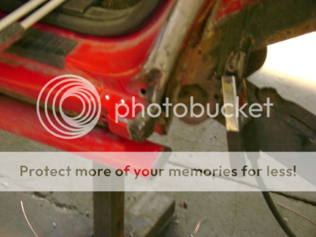

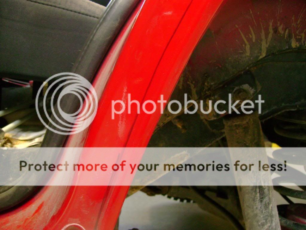

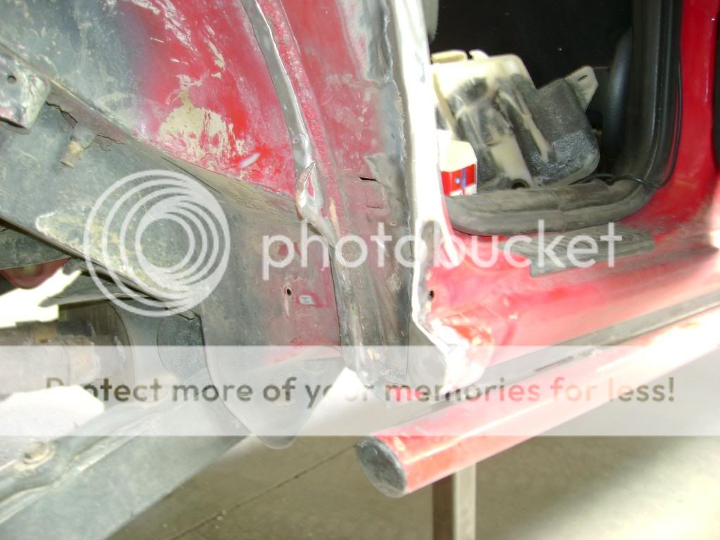

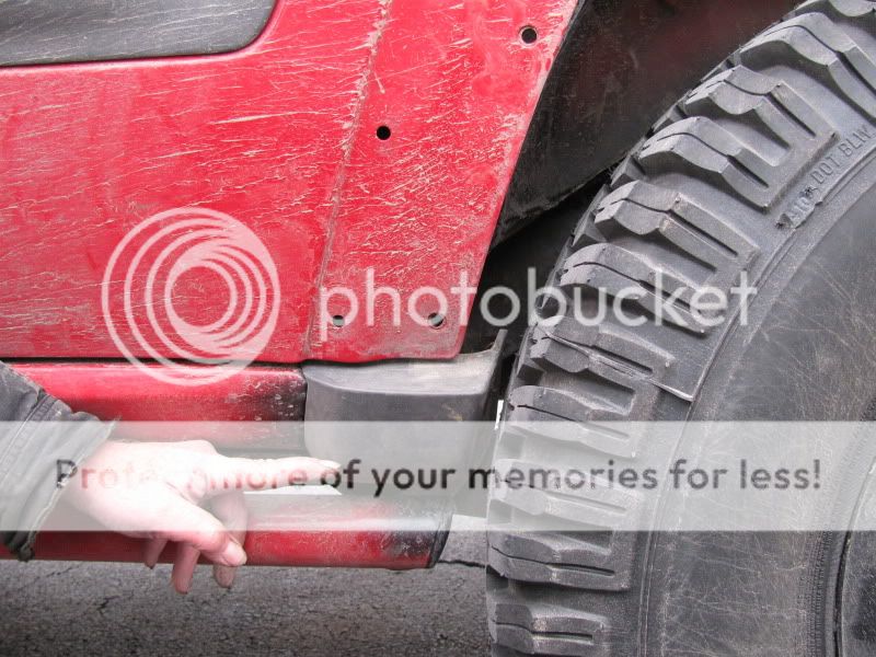

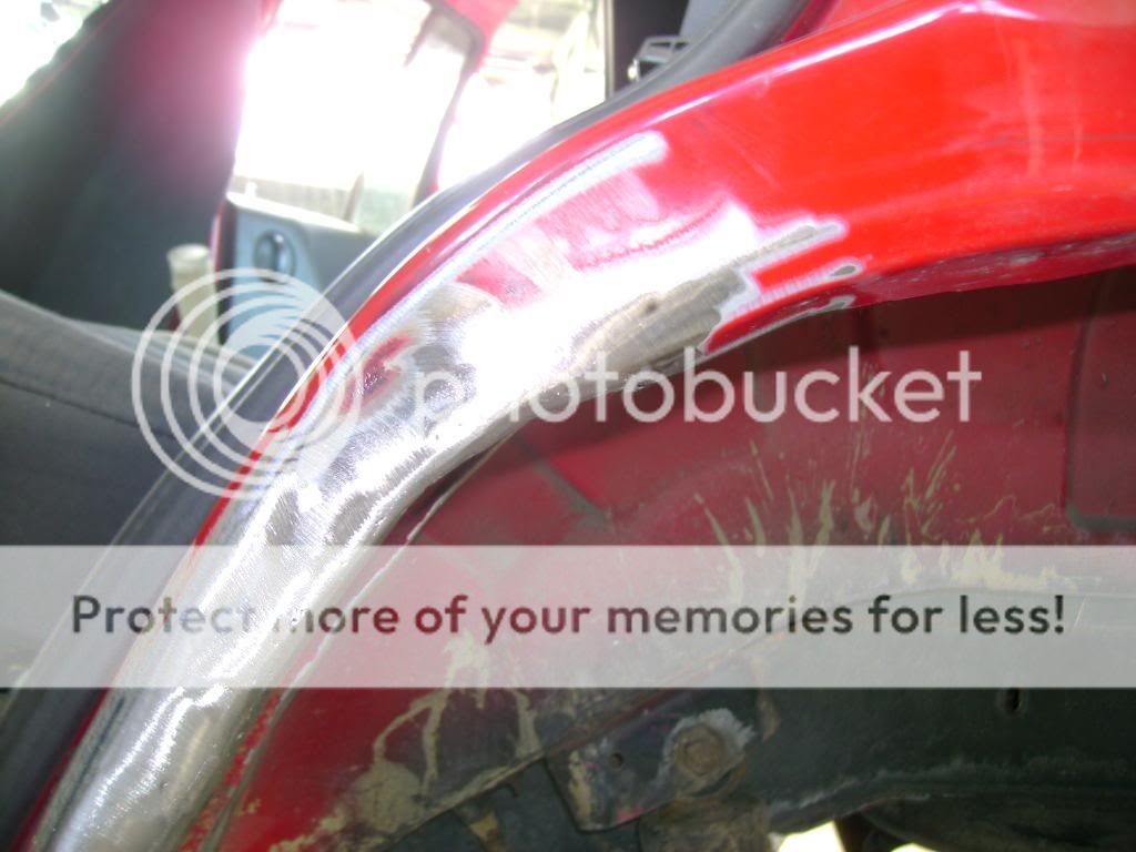

Here is the pics everybody has been screaming about
1 & 2 .this is the clearance you have if you're brave enough to try and fit 285/75-16 tires
3. First remove the flares, as you can see there is about an inch of body under and behind the curve of the door
4. I marked on the body using the door as a template. I didn't think I wanted to go any farther back than that.
5,6 & 7. You can see where I trimmed the body even with the door to about the second hole then curved out to meet the rest of the wheelwell radius
8. There is also a pinch weld in the front of the rear wheelwell that I pounded down.
9. I had a fabricator from work helping me with the welding. (This makes for a much nicer and cleaner weld :lol: )
10. Freshly ground and welded

Okay,
11,12 & 13. This shows the welded edge and again you can see where I pounded down the pinch weld in the middle.
14. Cleaning it up some
I will kindof lump the last pics together. These show how we capped of the end of the rockers and then cleaned them up.
And the Passenger side :
This last one from Tommudd actually shows how much sheetmetal was trimmed back in relation to the flare. The body used to be all the way to the end of the plastic.
And there you have it... who said 33's won't fit?
