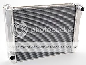

Just ordered my new radiator! :BANANA:
Jeg's - Ford/Chrysler-Style Aluminum Radiator Overall Size 26" x 19" Core 20.875" x 17.5"
Two-row 1" core
1-1/2" top radiator inlet, 1-3/4" bottom radiator outlet
Exclusive crossflow tube design dramatically increases cooling
Reinforced die-stamped tanks for added rigidity
Machined-billet filler neck for better pressure control
Brazed core for extra durability
TIG-welded tanks
$139.00 Shipped !!!! :BANANA:
Called to make sure on price, it's an appearance blem and there was only 1 in stock so I snatched it up! The guy said it was guaranteed just like all the others, just may have some welds that don't look perfect or maybe a scratch in the surface. :juggle: WTH! It's a Jeep, Right? Normally a $300 radiator! WooHoooo, couldn't pass it up! The only thing is, it doesn't have the trans cooler built in. But ...... digging around in the garage I found a NAPA Heavy Duty Trans Cooler . Wow, forgot I even had that! I hope that will do the job!
'05 WK Limited, Hers

I'll be using the stock water pump for now. I may need to fudge the radiator forward about an inch or so, but it should all fit!
