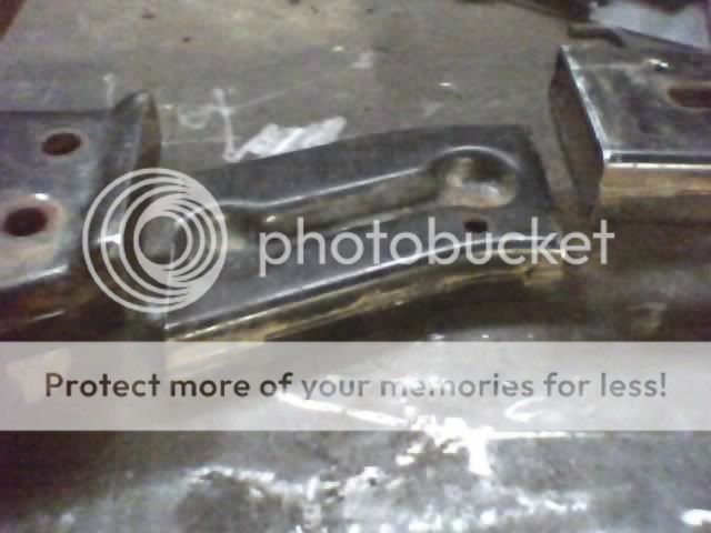

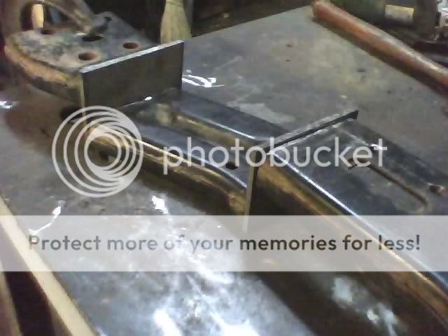

Thought I'd post some pics of what's going on with the crossmember now.

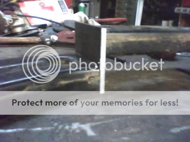

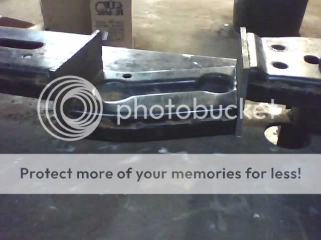

There was not enough clearance for the front yoke on the transfer case to spin so I am going to drop a section 2 1/2". I made my cuts after securing it solidly to a table.
Then I cut a couple pieces of 1/4" plate to 4" x 5-1/2" and slid them into place.

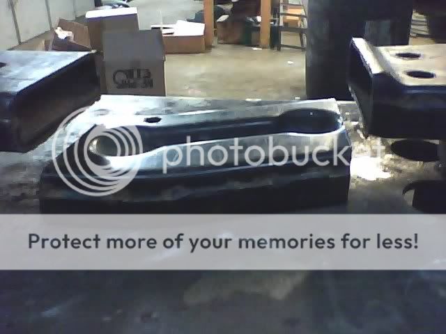

Now I just have to weld it all back together! I've got it tacked now, I'll try and do the real welding on it tomorrow at lunch.
And yes, if you are familiar with the underside of your KJ, you may notice that the bottom of the crossmember is now the top! The two drilled holes are for the C4 trans mount. I am also going to slot those just slightly to allow myself room for adjustment to line up the rear output yoke with the rearend, just in case our test fitment was off a little bit.

I assume that you also shortened the pieces 1/4 inch on each end to compensate for the added plates? Or is there enough room so that 1/2 inch will not make a differnce when bolting it back up?
What else are you adding to strengthen that area, forgot what you were discussing

Oh ... Coooooommmmme ooooonnnnnnn, give me just a little credit! Yes, I took the extra 1/2" out of the pieces! ...... I had to. The crossmember is solid to the table and the pieces wouldn't fit back together if I didn't! :goink:
Once I get the side plates welded I may go ahead and gusset it too. At least I listened to Hart and used the 1/4" plate instead of the 3/16 that I was going to use! :roll:

Wellllllllll, I didn't do the welding on it like I said I would today! :roll: After I unbolted and unclamped it to get to the bottom side, it looks like it pulled one way and bowed the other way just a little bit when I tacked it together! :evil: Not much ..... maybe a couple mils. (less than 1/8"), but when I laid it over on the table it wasn't flat! I swear that sucker was SOLID to the table!!!!!! I'm going to have to test fit ( again!!!! ) before I finish welding. I don't want to get it all done and then not have a bolt line up!! :roll: Once I make sure it still fits .... then I'll put my "bird droppings" on it (HART!) unless a better welder wanted to help me out instead of insulting me!! :ROTFL:

if ya got a set of those 1500 lb carpenter clamps and 2 pieces of flat stock scrap ya might be able to keep it from twistin, it's hard to keep stuff from drawin on the tacks though
you'd almost be better off bracing it flat in two pieces of large channel if you have channel big enough, much easier to tack against the brace force than it is perpendicular to it

Jeepin - No, it was snot square! :lol: But I broke loose the tacks and resnotted it! :lol: Now it's square! and straight and level too! :lol: Brought it home and threw it under the KJ and whadyaknow, it fit! I'll get it all welded up good now and throw a quick coat of paint on it and I can test fit the whole kit an kaboodle together this weekend! :lol:
