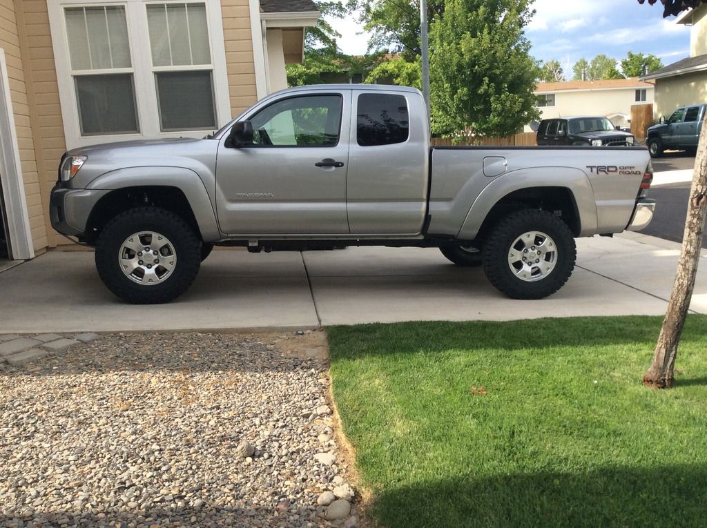

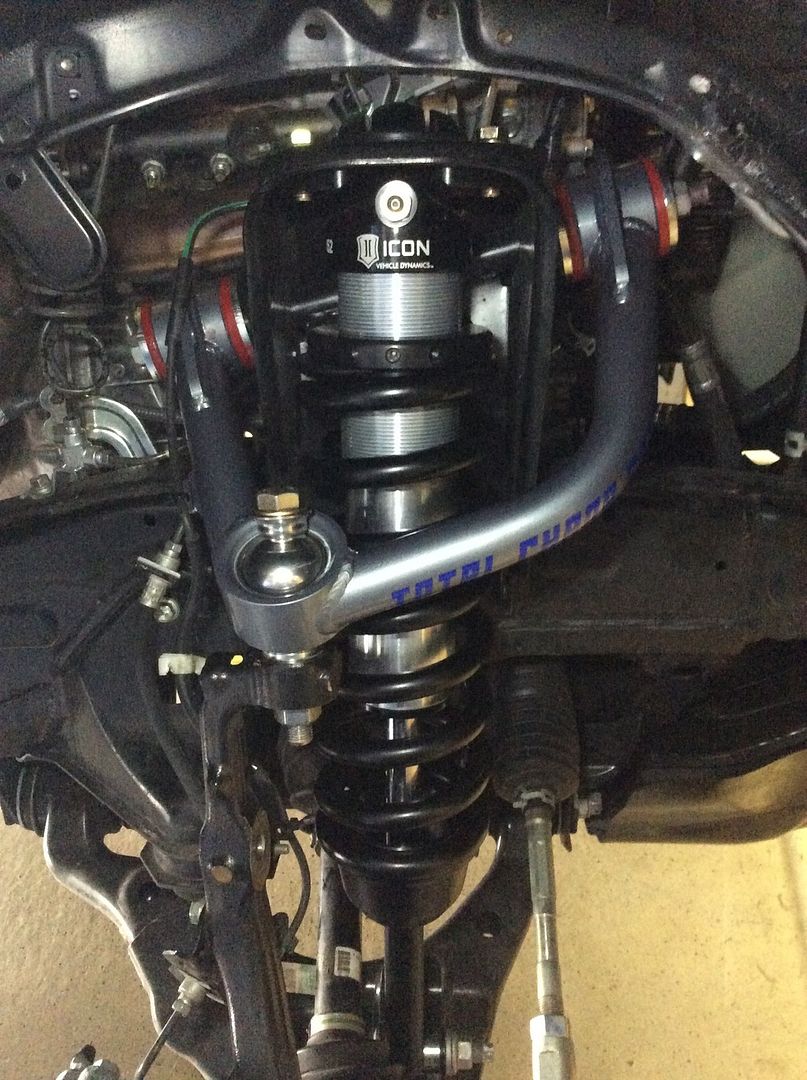

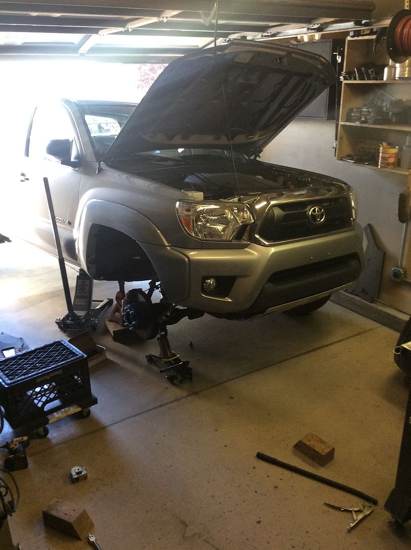

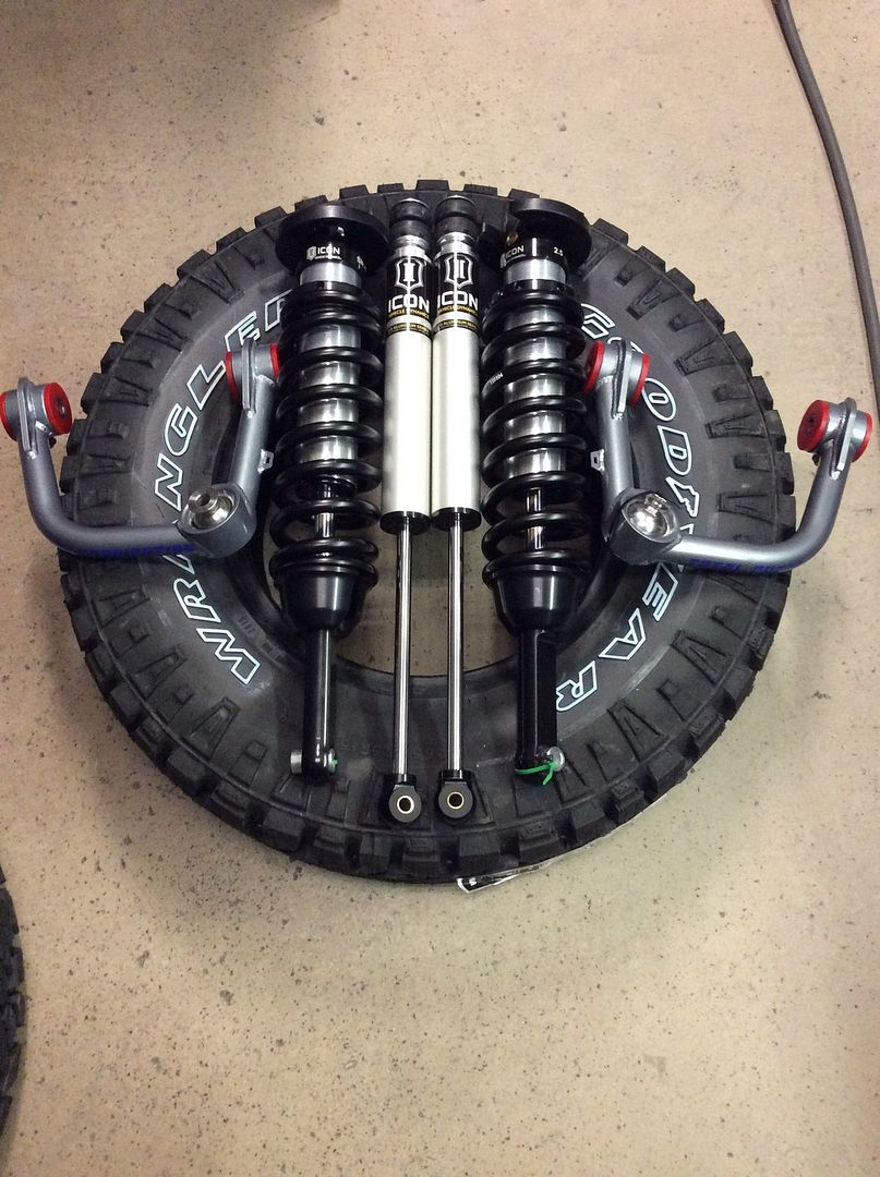

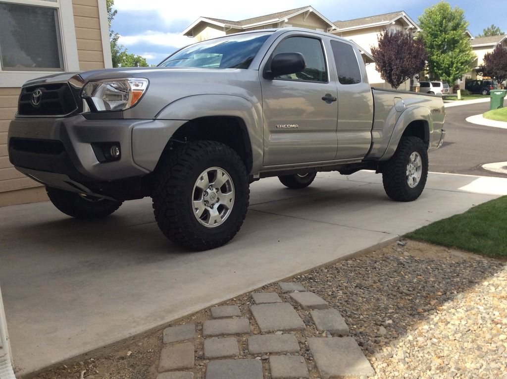

The last pieces of the Taco suspension finally came in and is getting installed tomorrow..
Icon extended travel 2.5 coilovers with custom valving, Total Chaos uniball UCA's, progressive 3 pack add a leaf, and 2.0 rear 10" shocks. 265/75/16 Duratracs too.....

Can't wait to see what she looks like. Are you sitting at 2.5 or 3.5 with your KK? I think a KK test fit of the 32s is in need :twisted:

I'm pretty sure 32s would fit in there with some minor trimming/pinch weld mod...the problem I have is I drive over a big arse mountain all the time. Even with the 245/75s the KK is power deficient haha. I'm at 20.75" all around, anything higher and my UCAs hit when wheeling.
Got the tires and alignment done on the Taco and it drives unbelievably nice and plush. Need to go brawl some desert now :SOMBRERO:

So far I'm really impressed with the ride as well as the quality of the Icon and Total Chaos components. I took it out and flexed it pretty good but forgot to take a tape measure to see what I got. I did remove the sway bar to get more flex and see how the handling is with the 650 lb springs... still on the fence about whether I want to leave it off or not. I'll wait for these tires to break in and decide.

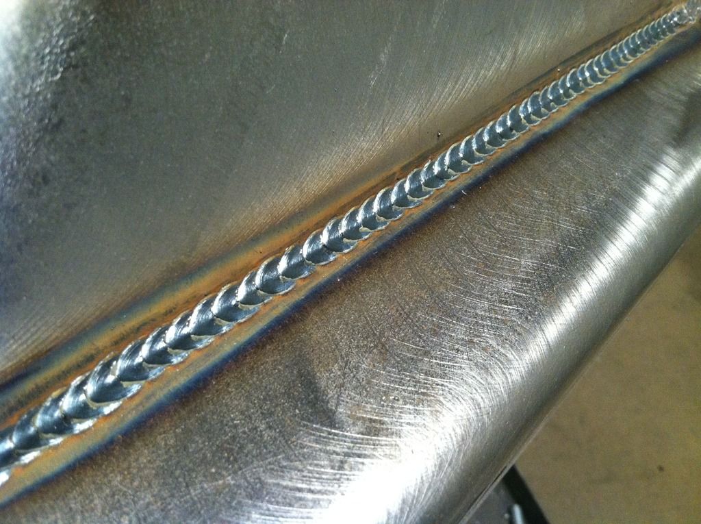

That'll do, pig.

Dat bead

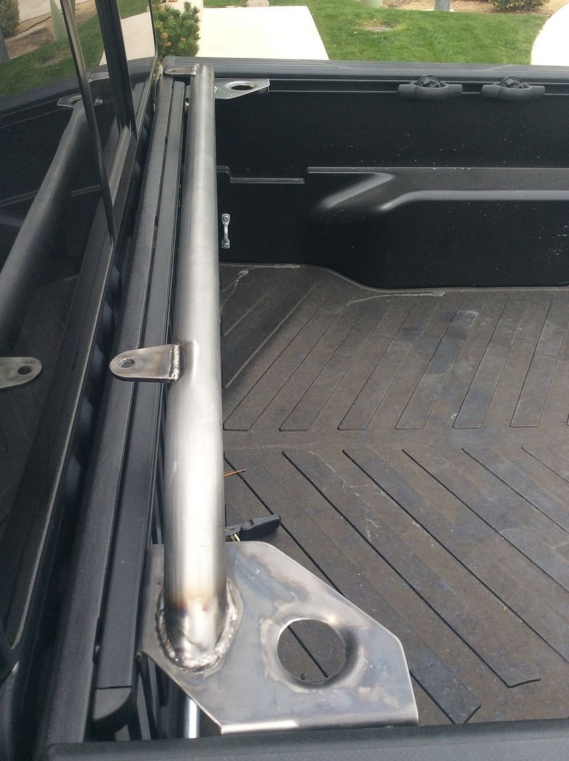

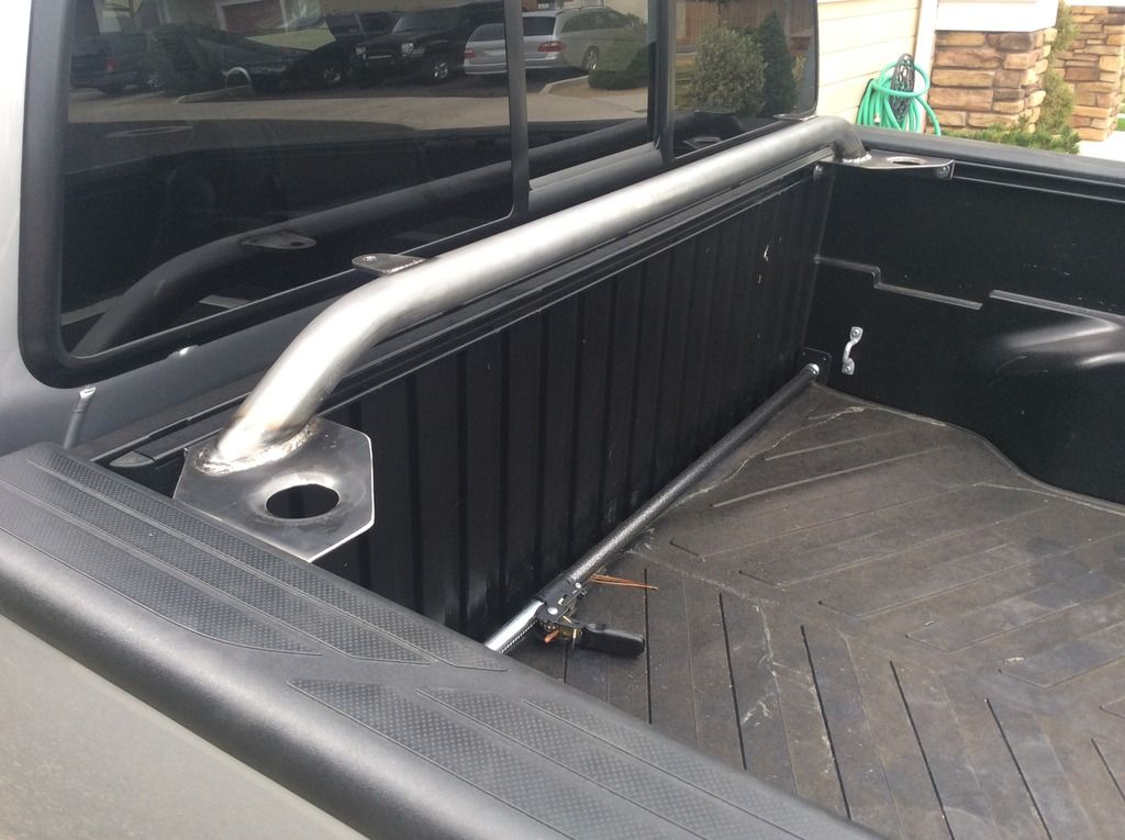

Whipped this up today..need some lights

That looks awesome, Morgan!
If you're a fisherman, I've heard fishing rod holders are pretty easy to fab up in case you need any ideas of what to do next.
