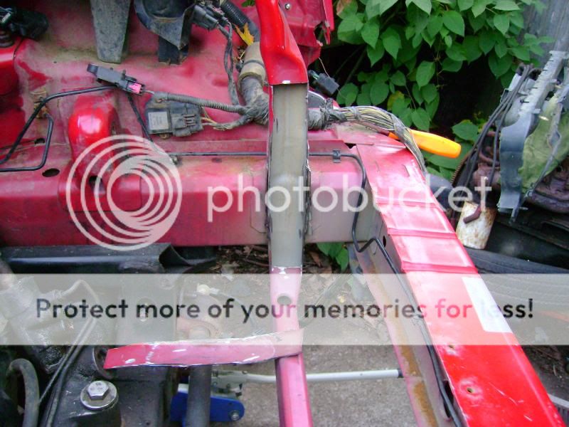

Today I test fitted and started engineering brackets for the radiator!

I went ahead and pulled all the old power steering lines off the body (been kinda working around them!). Got the driver's side radiator support cut for a little extra side to side room for the radiator. This will eventually be reinforced with 16 gauge sheet metal.

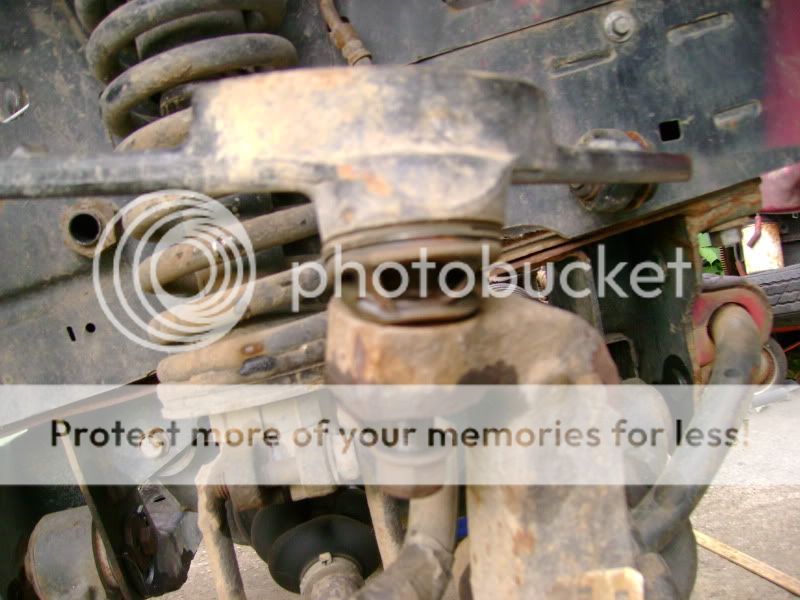

Tommudd came by and brought a small MIG welder for me!!! :BANANA: Everything has a price tho'! Started getting part of the front suspension torn down with Tommudd's prodding! :roll: In the process I discovered this:
Guess it's time for Al's Arms! :BANANA:

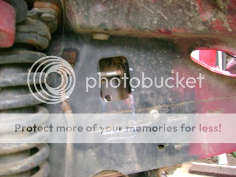

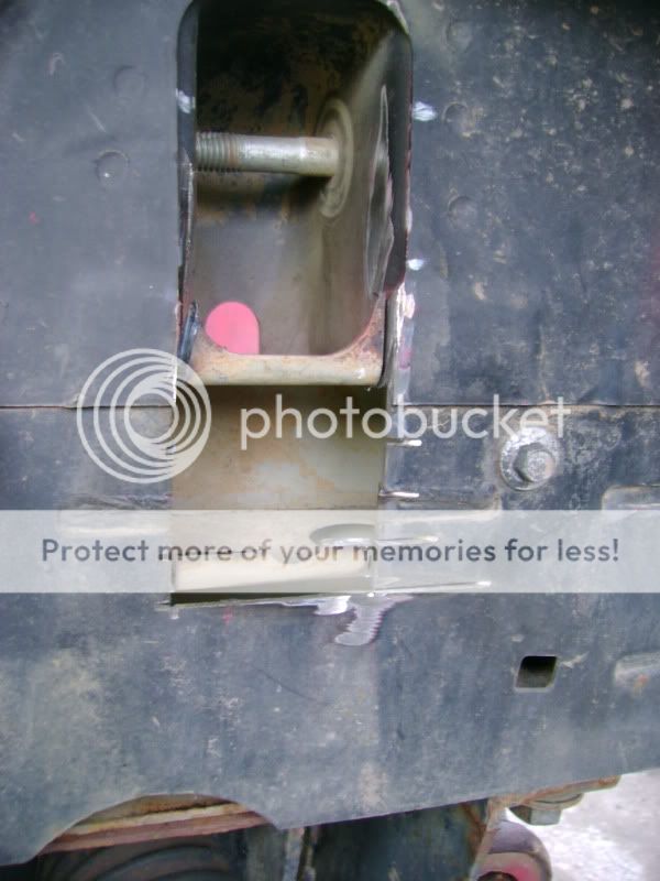

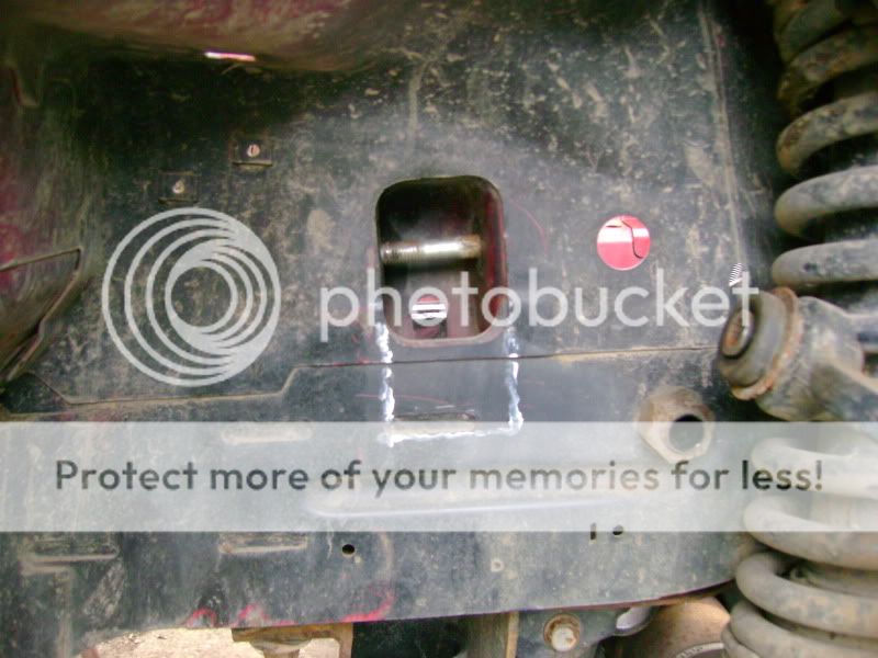

The stock A-Arms were bottoming out on the pockets so I started cutting them out also. I hope everyone knows by now .... even a simple mod like that takes on a whole different meaning to me! The bottom of the pocket will now be lowered 3-1/4" for the front and 2-1/2" for the rear arm bushings! The pockets will be rebuilt with 12 gauge sheet metal. There are some other things going on that prompted this mod............ but we'll talk about that later!!!!
Rear Pocket marked for cutting
Front Pocket marked for destruct ..... errrr ..... modification :roll:
After I worked on it!!
Closer Shot
