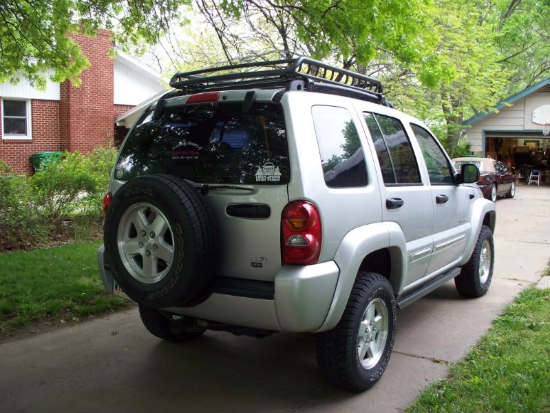

I'm with XC204. Using the clamps bought at Harbor Freight, and the 1.0 inch rigid conduit, you really need to put those bends in it to give adequate clearance. Now I just need to find somebody to bend those pipes.

since its just a small amount of bend you may be able to heat it with a torch at the bend point stick a bar or pipe in the end for leverage. Dont know how bad the galv. coating will mess up though. I wavent done enough torch work to know.

Anybody know where I can get a more oval shaped tubing than the standard 1 3/9" top rail? I don't think the shape of that tubing will work with the roof basket mounting brackets I'm going to have.

will this set up work with my renny roof rails? they are 2 1/8 in outside diameter and round. or is there another type of clamp i can use?
thanks in advance

I was looking on the web last nite and couldnt find anything exact but this site has some aluminum cross t's that have an inside dia of 2.375 that might work with a little cutting for slipping on from the top and over your rack but would need 1/8 rubber or the like that would take up the extra .250" in size I do this in the ones I made for the Sport racks. there is also a series 500 "T" fitting that bolts on that could be modifyed to work http://www.wagnercompanies.com/Series_500.aspx its for 1.5 sch pipe which is 1.90 " OD. I donot know how much thet would cost or where to get them though. hope this helps. http://www.wagnercompanies.com/domains/ ... ttings.gif image of bolt on t

Well, I went to Harbor Freight and picked up 4 Tee's for $2.00 a piece ane one 10 foot 1/38 fence post for $10.00, and built the cross bar set. I really like it! The only thing I didn't do was bend the bars. I inserted a piece of rubber inside each Tee aprox 1/4 thick that only wraped less than half of the railing to where the botten bolt is touching the factory rails . Between the roof and the front cross bar it has aprox 1/2 inch of clearance,(which is closer the the rear bar) I think I will be able to mount a rack using a thin U bolt style set up on the outter ends of the cross bars and still be safe from touching the roof of the jeep. Ill let you guys know when I get my Rola steel cargo basket! :D :D :D

Hey thats great! it is a pain to dig up a bender. Oh and I had a brainstorm/fart and figured out you can get Vinyl covered fence top rail from a fencing company or on line it was about $14 per 10'

As mentioned eariler in the post the crossbars dont have to be bent
If you dont have access to a bended or are leary of the whole heating galvanized pipe thing
My cross bars are flat and unbent and match up with the bottom of my black widow roof rack
I have no access to a wielder and didnt want to chance the whole poison galvanized fumes thing
So they will work even without bends to match the roof line

I guess it all depends on preference but without the bends, the 1" rigid conduit had less than 1/4 " clearance between roof and conduit. That's too close for me because I could push down on pipeand nearly touch my precious paint with crossbar. Fortunately, I found a Chicago bender and bent my pipes today. Will be finishing up this weekend complete with paint. Maybe even throw the BU light up there too if I can figure how to route and hide the wires. Look out, XC, mine may turn out as good as yours...thanks for the idea, finally materializing after 4 months of having those pipes banging around in the back of Jeep.

I routed mine inside the bar, out the clamp into the Pas. side plastic rack mount under the plastic molding strip then drilled into pillar wires and relay into area behind rear side pnl. used rear 12v outlet power .

Harbor Freight has discontinued the clamp-on tees; the ones in the store were clearanced. Unfortunately I only managed to get one of them.
There are other sources but all a lot more expensive. Not enough more to keep this from being a relatively inexpensive setup though, so I'm shopping for the best price on another three.
