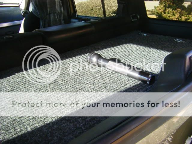

1 1/2" pvc pipe fits a "D" cell mag light really nice

I drop my maglight down in the little space to the left of the drivers seat. It is a 4D cell so if need be it can be used as protection and is in a convenient place. Going over bumps and stuff it doesn't move anywhere. I have a pair of leather work gloves there too so they help keep it settled down.

my 4D Mag is between console and passenger seat

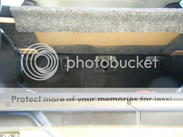

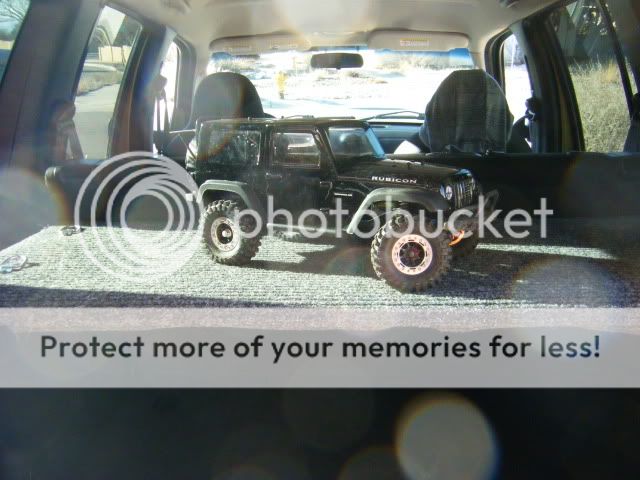

I made a shelf couple years ago. Used Steel Pipe as the rod in the back. Also installed my HiLift Jack right behind the head rests on the back seat. When seats need to go down and the Headrests removed... I drilled holes for the headrest bars so the headrests will just neatly slide down into the shelf and stay put.

darren/wayne - the headrest holes are a great idea.
however I'd reconsider the Hi-lift
in an emergency deceleration (i.e. wreck) -
the hi-lift could decide to join you in the front seat - making a significant headache
somewhere a bit more solidly mounted - would be a safer idea.

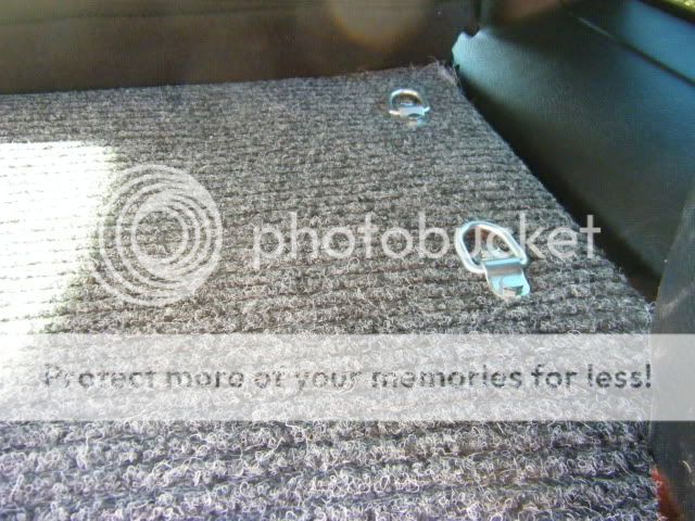

Here's mine, used door handles from Lowes for cargo tied downs and to give me something to hold on to when I pull it out.

Fire extinguisher doesn't interfere with anything; since I took the pic though, I have cabled it using a carabiner from the extinguisher neck to one of the tie downs on the shelf. I don't trust that plastic bracket to hold in case of a rollover. The taplight I used has keyhole slots in the back so it's mounted with two screws. Summer heat here in NC makes me avoid anything using stick on tape, velcro, etc. like the plague.
