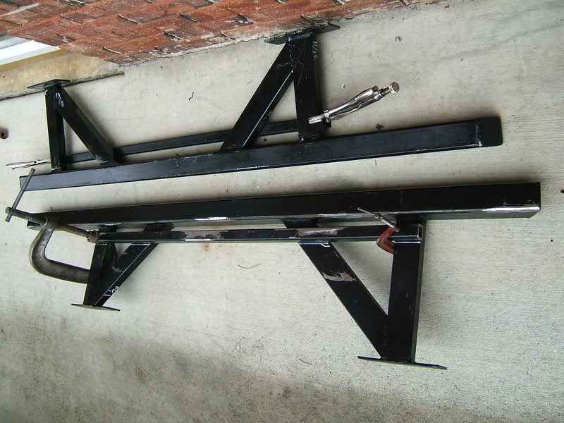

Here is what I had to work with:

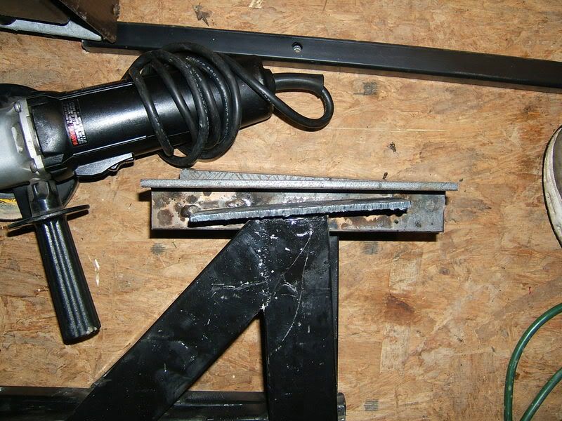

As you can see, they didnt even fit between the pinch seem and the frame. You can see the supports hanging down. The 2x2 hung down entirely to much also. :?

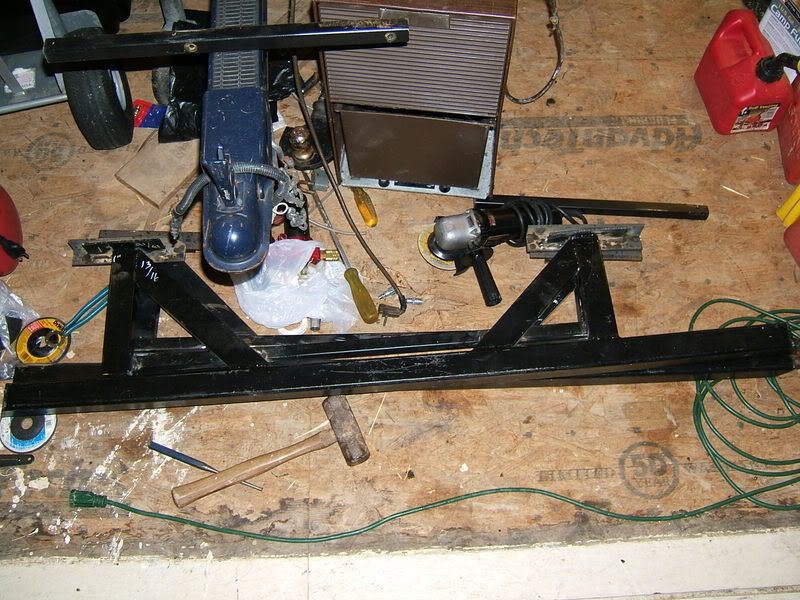

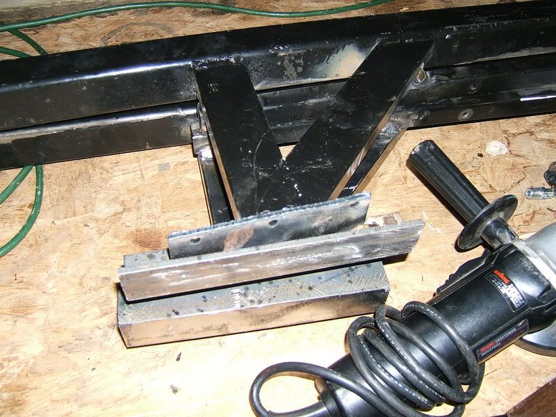

So I got the angle grinder out and put a cutting wheel on it. I cut the 1x1 off the 2x2. If it would of fit, there is no way the welds on the 1x1 would of held it on the 2x2 if I beat it hard. It was only welded to the corner of the 2x2. :shock:
Anyway, I cut that off and decided to move it down on-top of the 1x2 so it would raise the 2x2 up and move it closer to the pinch weld. The only problem with that, the 1x2's that went back to the frame, were now to short. And to top that off, the plates that bolted to the frame were not square with the frame.. The only thing we could think of was to weld some angle iron onto the plates so it would reach the frame, and we could also square it up with the frame.

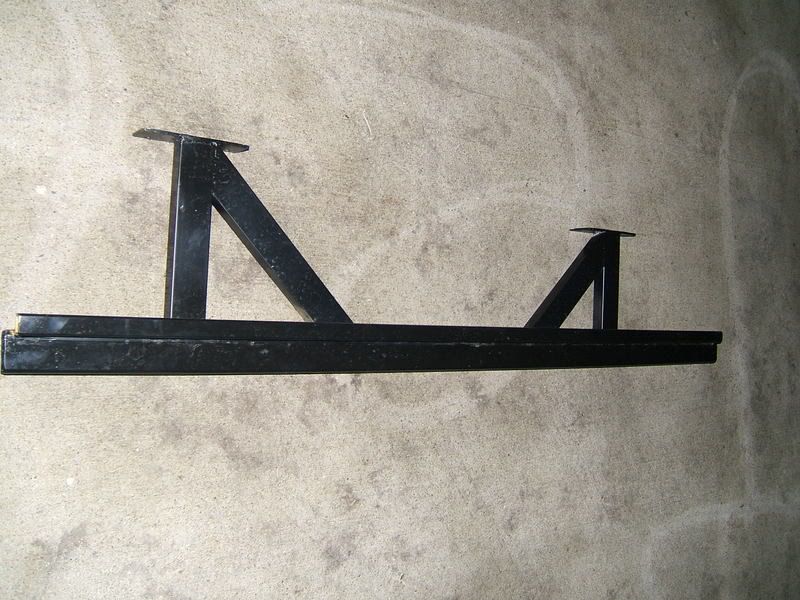

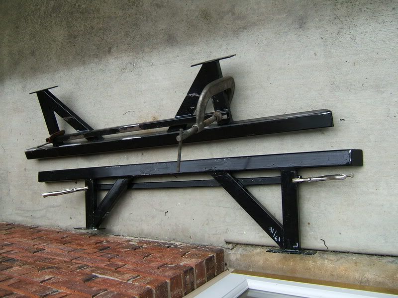

We measured the distance that the angle iron would need to fill, and clamped the 1x1 on the 1x2 where it needed to be:
It seems like they are going to work out perfect. I only wish we could of done something alittle different with the angle iron so it looked better. :?
The angle iron is welded to both sides of the plate and is also welded to the 1x2.. Hopefully it will never cause any problems. I do not plan on beating the snot out of them so hopefully they will do just fine. :)

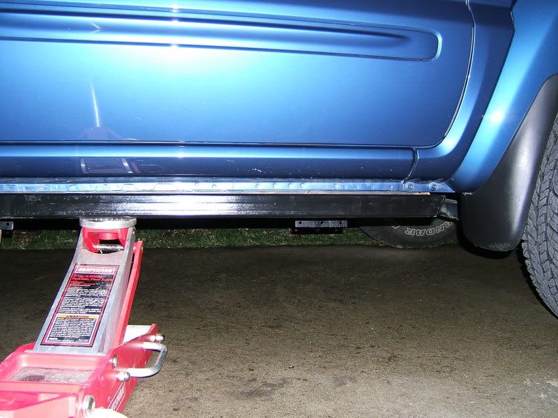

Now Ive got to get them put on and get ready for Livingston on Feb 17th!! 8)

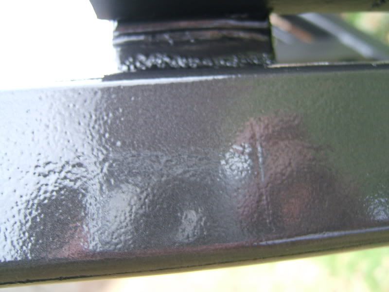

Sanded that paint off and painted them with some Rustoleum Hammered Look Black paint. Really like the look and texture of this stuff. 8)
