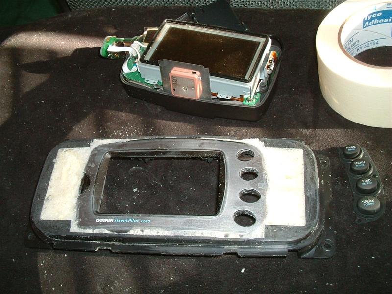

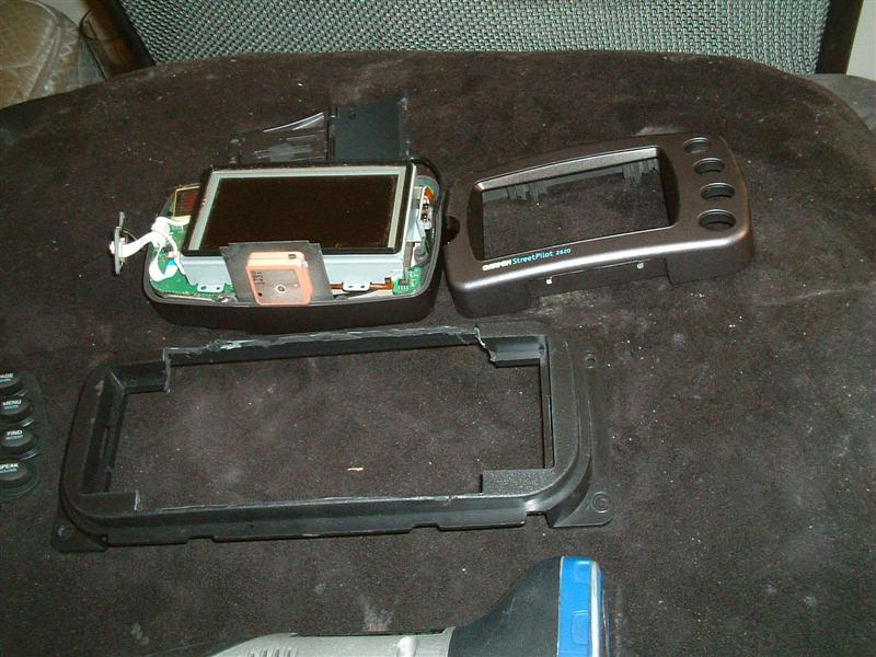

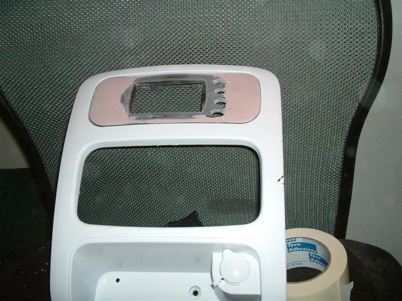

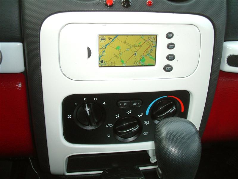

This is my first time using Bondo, so it isnt perfect.
2004 Silver Jeep Liberty
Pictures Are Here

Does it have to be centered for clearence issues, I know you centered it for looks, but I believe either Serius or XM make a controller that is only 4" wide, just wonde if there is enough room on the side to install that in the same hole?

PostPosted: Mon Dec 19, 2005 3:57 pm
Joined: Mon Jul 11, 2005 11:44 pm
Posts: 160
Location: Seaford, NY, USA
There is only a little over and inch of clearance on each side. Garmin does makes smaller units that may make it possible to put both.

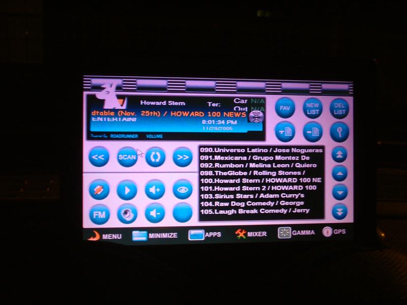

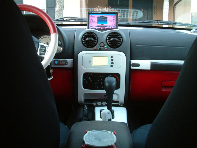

Here is a full view of my dash.
And Sirius..
Pictures Are Here
PostPosted: Mon Dec 19, 2005 11:58 pm
You have a plant growing out of your dash and pc or are those sparks flying?
Seriously, what is up with the speaker in the center console?
That is the speaker for the GPS.

PostPosted: Tue Dec 20, 2005 12:27 am
I'm interested in the screen and PC setup... Looks good
I think he means the plant that appears to be coming out the top of the screen...

Oh, the one outside of the KJ, lol.

PostPosted: Tue Dec 20, 2005 12:42 am
yup just got done looking at them as you posted that...
what screen did you use ??
does it go into the dash or stay that way all the time?
Mike

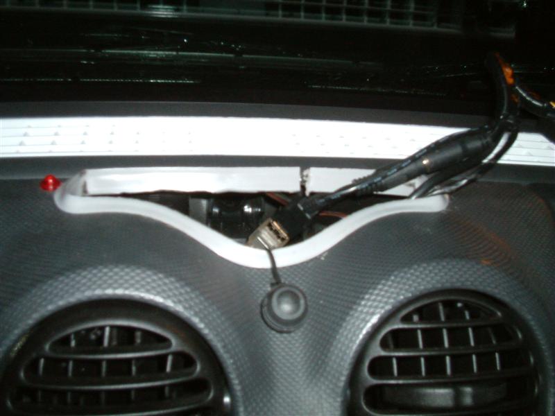

PostPosted: Tue Dec 20, 2005 12:51 am
Posts: 160
The screen is the same as this one http://www.mp3car.com/store/product_info.php?cPath=25&products_id=47. I got mine off of ebay under the brand name TVIEW. It stays in that position. I would have to reposition the vent ducts to allow for room for it to go up and down.

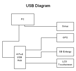

Impressive fab work. Could I get some more info on the PC install and what software you're using?

I just added some specs to the top of my website http://www.inmyhappyplace.com/jeep/. Let me know if there is any specific information you need.

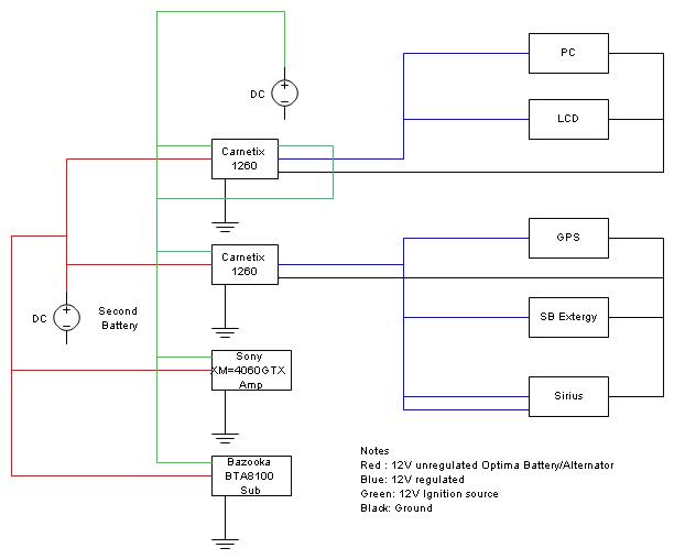

PostPosted: Sun Dec 25, 2005 4:15 am
Joined: Thu Jul 07, 2005 8:48 pm
Posts: 861
I'm actually looking for some details on how you have it wired up. Does it power up when you turn on the Jeep and shut down when you turn it off?
How exactly did you mount the screen?

PostPosted: Sun Dec 25, 2005 1:50 pm
Posts: 160
I have two Carnetix 1260 DC to DC regulators. They have the ability to turn the PC on when they receive power. I also have seperate Power ON and Reset buttons mounted in the dash. The screen is just sitting in a hole i cut in the top of the dash.
