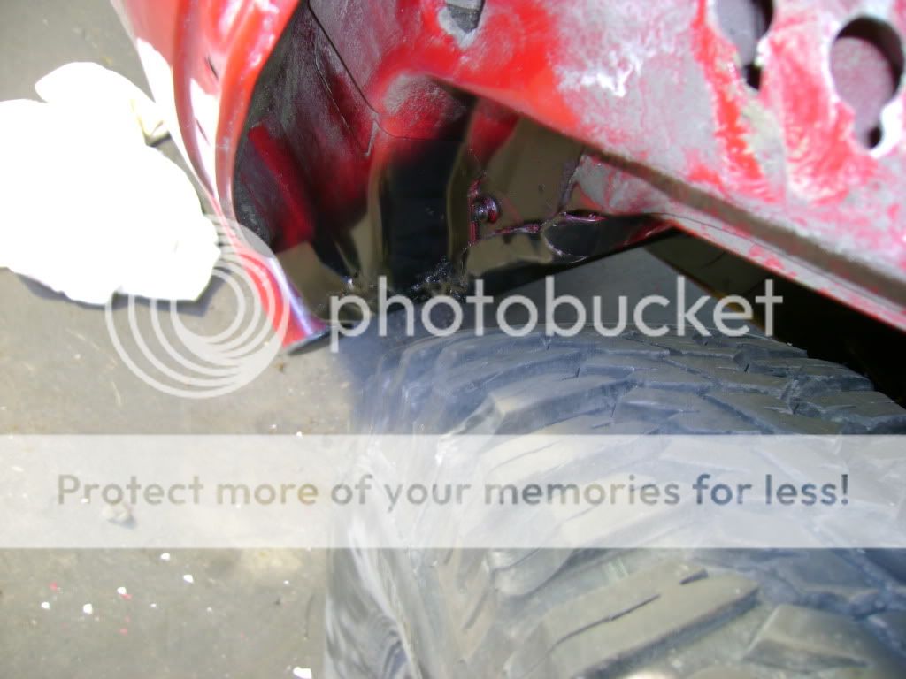

Ended up with tires that rubbed a little at the rear of the fender well. So I decided to do something about it. Pulled it in the shop at work and got together the 6" grinder w/cutting wheels, dragged the MIG over, Got it in the air on stands puleed the tires and then.............. Sat my butt on the floor and stared for 20 minutes :shock: That first cut was hell on the nerves :roll: .
So I cut up a small opening to see in behind the first layer.
Then peeled it back. It looked clear so I went to town on it.
I trimmed back horizontally underneath 1.5" and then brought the cut line around the side and up
I then found an inner fender skin from a Tahoe ( We assemble and weld together body panels for GM, hoods,doors , fenders, trunk lids etc. for factory repair parts ) and cut it to fit with a couple inches left over and started welding it back in to the new opening.
As I got it welded I kept trimming it to fit and welding and hammering.
Then it was time to clean it up a little
I also trimmed the factory Mopar rails back to match the new body line. About 1.5"
BEFORE
AFTER
Oh by the way, here's the tires
Took me about 6 hours of farting around, working, drinking coffee, working, looking, thinking, working and I'm done with the passenger side! :lol: Hopefully next Saturday will go better now that I know what I'm doing :roll:
