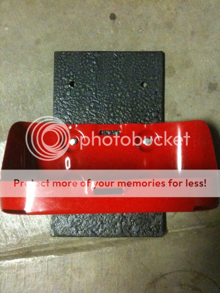

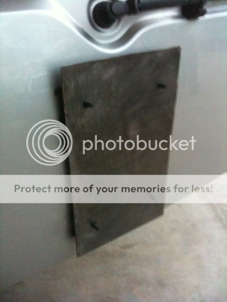

Ive had this jerry can sitting in the back of my jeep for the last month since I got it from a buddy for my birthday. I wasn't sure how I was going to go about mounting it until I decided to put my tire on my roof rack and use the existing bolts to mount my can. It turned out pretty well I think...

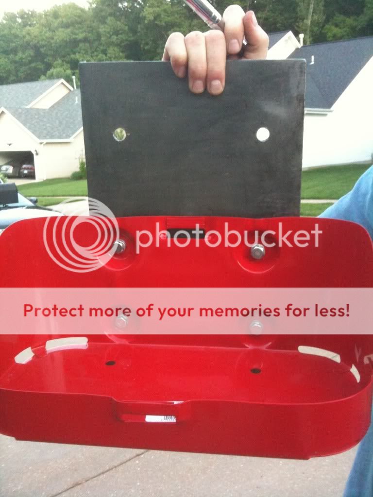

Used a drill press in my garage to put the holes through the 1/8" steel plate I cut to fit
I used 2 washers per bolt and 1 rubber grommet per bolt to keep it away from the body and paint of the jeep, no un-necessary scratches here!
Here it is all bolted together, just needs some Truck bed liner paint!
Painted and ready to mount
Heres the finished product, I just need something stronger than the bungee cord to keep it still!
Let me know what you guys think! Its my first fabrication besides the roof rails so go easy! :JEEPIN:
