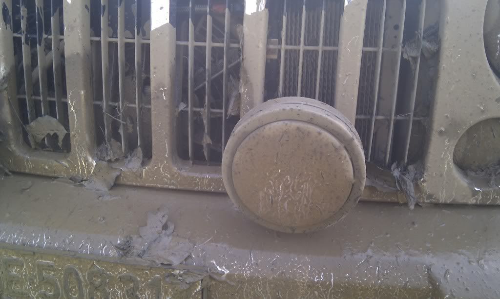

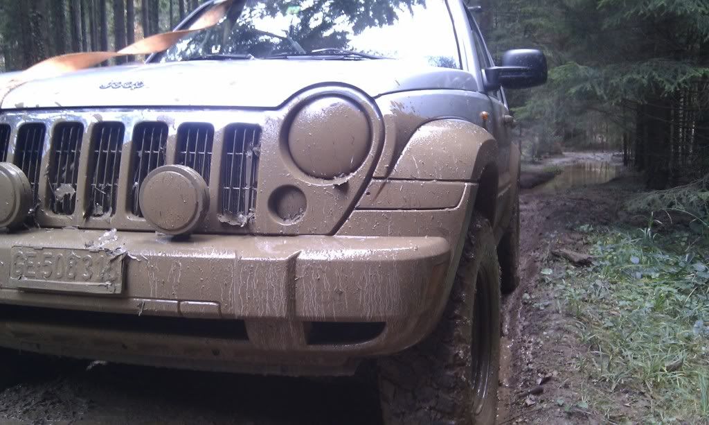

Here are the pics:

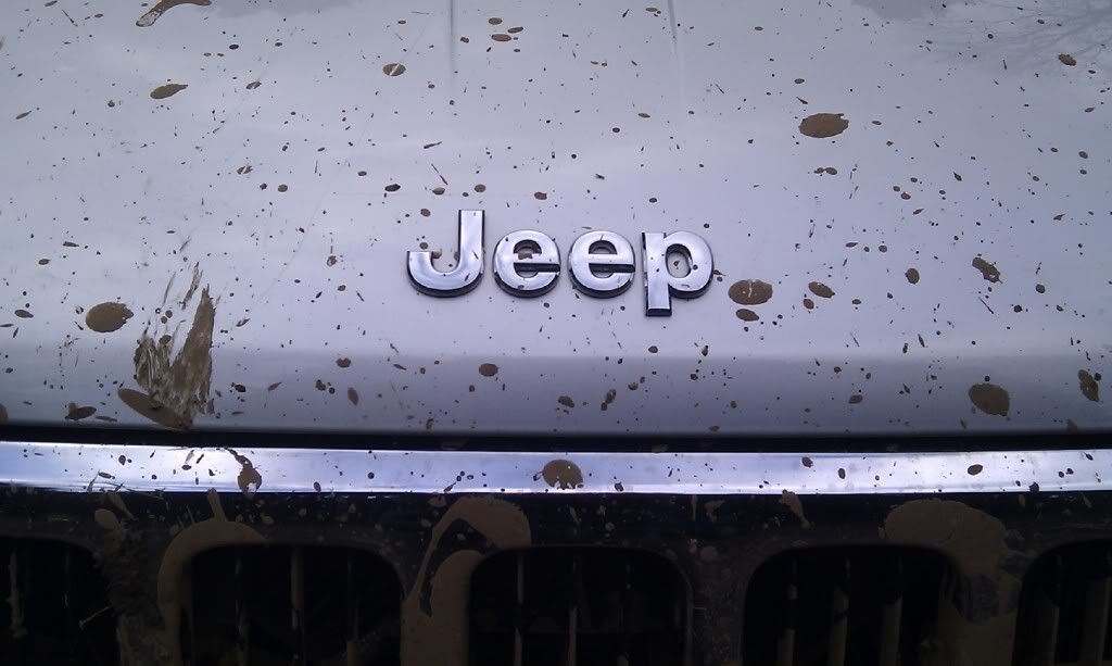

and one for the Brand !!
yes, there was a bit of noise from the leaves and branches stuck in the fan.... :SOMBRERO:

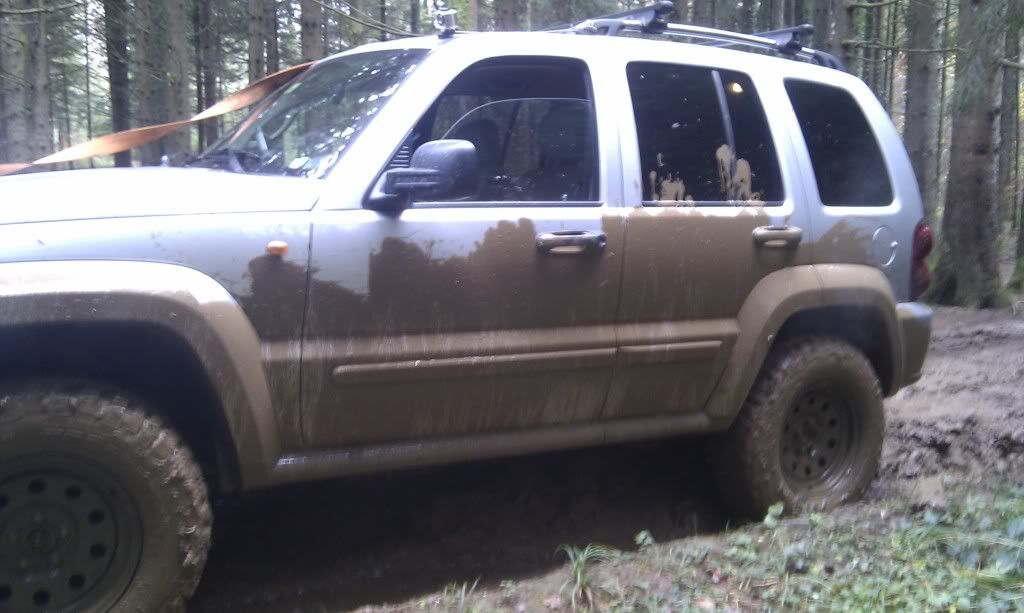

Here you can see better how high the mud was....
