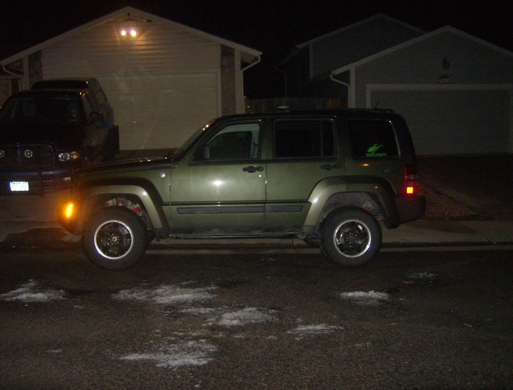

PostPosted: Wed Jan 14, 2009 10:40 pm
JBA 4 inch
The 09 i was next to only had 2400 miles on is, so it is still sitting a little high
PostPosted: Wed Jan 14, 2009 10:49 pm
Digger I have to say I don't really like KKs (ugly front end )
BUT
yours I like !!!!! :wink: Looks a lot better than stock for sure

PostPosted: Wed Jan 14, 2009 10:59 pm
BUT
Doesn't look like its dragging its spare now does it :twisted:

PostPosted: Wed Jan 14, 2009 11:10 pm
that looks killer Digger! now you just need bigger wheels and a bumper.

PostPosted: Wed Jan 14, 2009 11:18 pm
Yeah, I'm hoping the great eagle will doo doo in my mail box this year so I can get some tires
