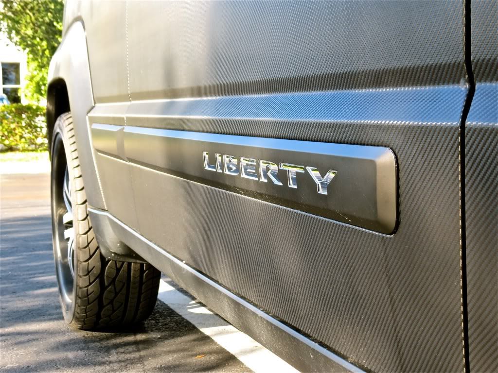

you need to change the "Liberty" on the side of that sexy b*tch to a custom trim that says "Giggity".

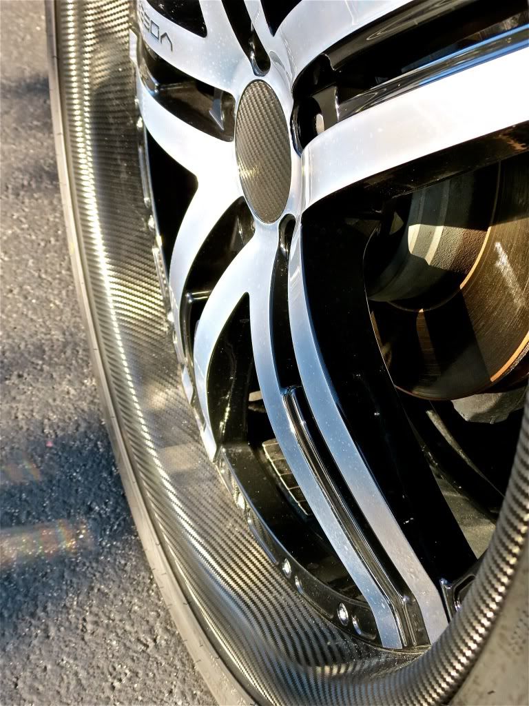

What size are the tires?
Tampa, FL
 Post subject: Re: Introducing the 2011 Jeep Liberty Carbon Edition
PostPosted: Tue Mar 20, 2012 5:26 pm
Posts: 1257
Location: Pembroke Pines, FL
265/35/22 Goodyear Eagle GT

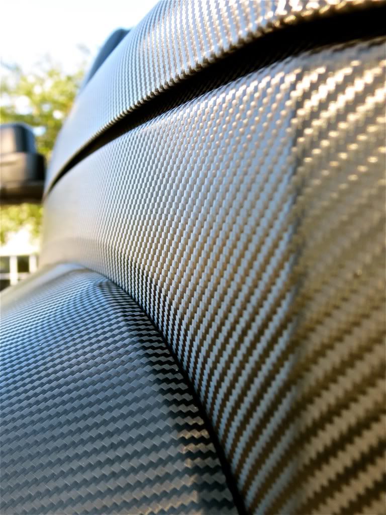

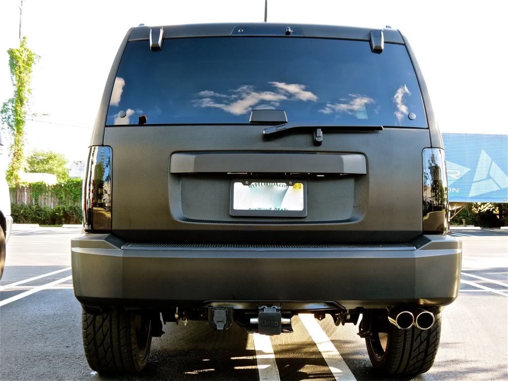

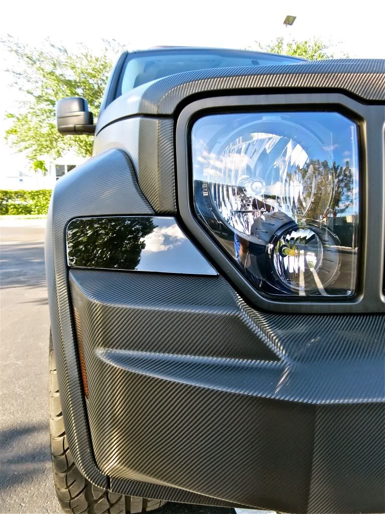

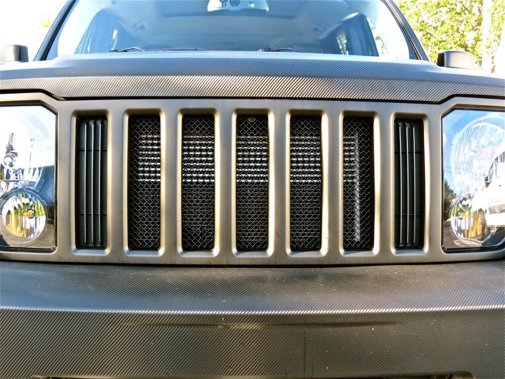

Here are some new pictures

Hey I was just sort of curious about this. I am an engineer for an auto manufacturer and they do vehicles in vinyl for events. Looks like you and your friend did an extremely good job on yours. Actually just as good as if not better than what I see here. My question is how well this stuff holds up over the years. I see some of ours that get heavy use starting to bubble up in spots that get a bunch of sun exposure. It looks sick by the way...very original.
PostPosted: Wed Apr 04, 2012 10:30 am
Posts: 1257
What materials are you using? How long it lasts all depends on how good of an install job was done and the quality of the materials. If the vehicle wasn't prepped properly and the material wasn't applied properly you will get bubbling over time. We took a lot of time and care in making sure the car was extra clean and all the wax and road grim was removed before we applied the vinyl. We also made sure to "set" the vinyl after the install. Setting vinyl is just going over it all again with a heat gun and making sure everything adhered to the truck. A lot of people will skip the "setting" step because it takes extra time and we all know time is money. We went for quality over time and price which why when you look at my truck close up it looks like it came from the factory that way. Hope this helps, if you have any other questions just ask!

Is that vinyl the sticky stuff like what bumper stickers are made of? How hard is it to get off if you want to do somethine else later on? What did you put on your lights to darken them? I love the look of carbon fiber, nice job.
PostPosted: Mon Apr 23, 2012 6:11 pm
Posts: 1257
It actually peels off very easy. It will leave a light residue behind but it comes off very easy with a little bit of alcohol and paper towel. It does not damage the paint. As far as the lights go I had them sprayed at a body shop. They sprayed them with tint spray and then clear coated them just like they would clear coat a paint job.
PostPosted: Mon Apr 23, 2012 9:14 pm
still amazed by how good this looks. However i think you should've had the body shop put flat clear instead of shiny clear on your lights. That's what i did with mine and they turned out great. or maybe a semi-flat would've looked good. the shiny lights still look great (dont get me wrong) hahaha.

They were originally done in flat but I didn't like how it looked. I like them shinny because the rest of the glass on the truck is shinny also lol Also I didn't want to have to do anything to the headlights and felt that if all the lights were flat the headlights wouldn't really match.
