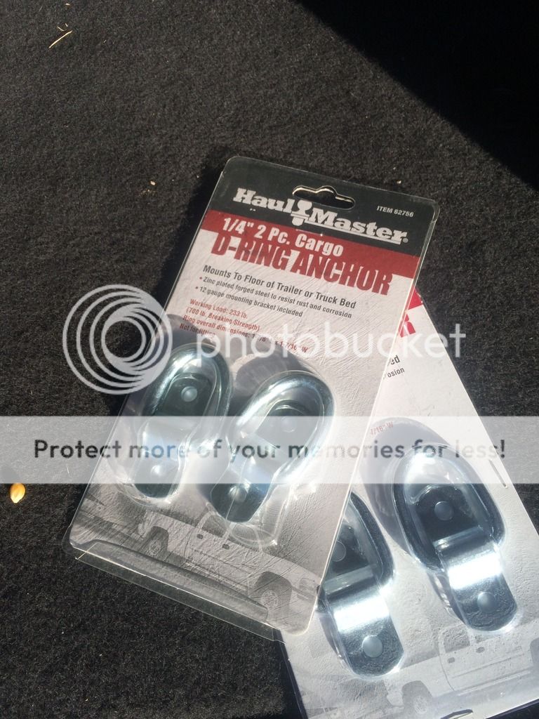

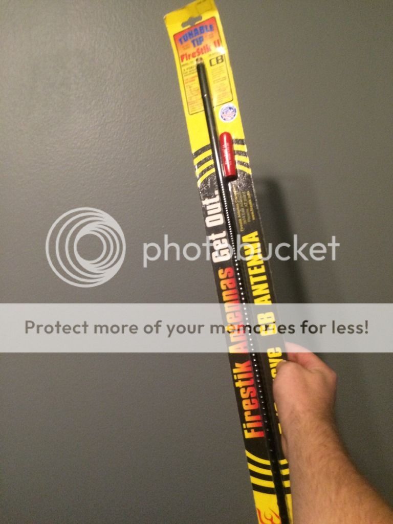

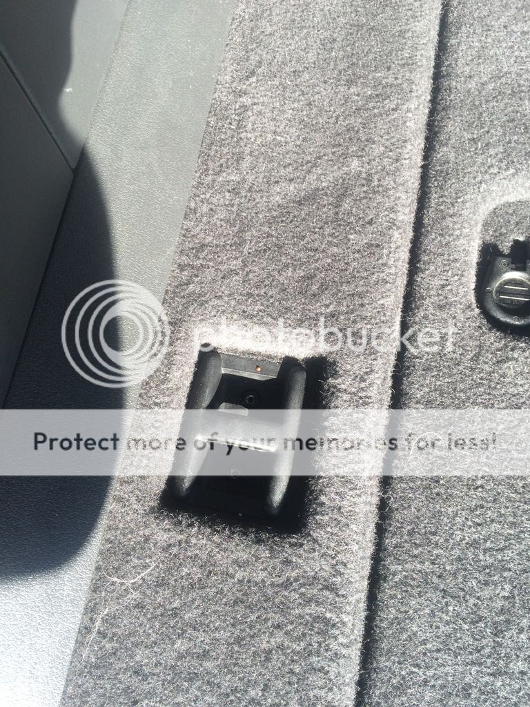

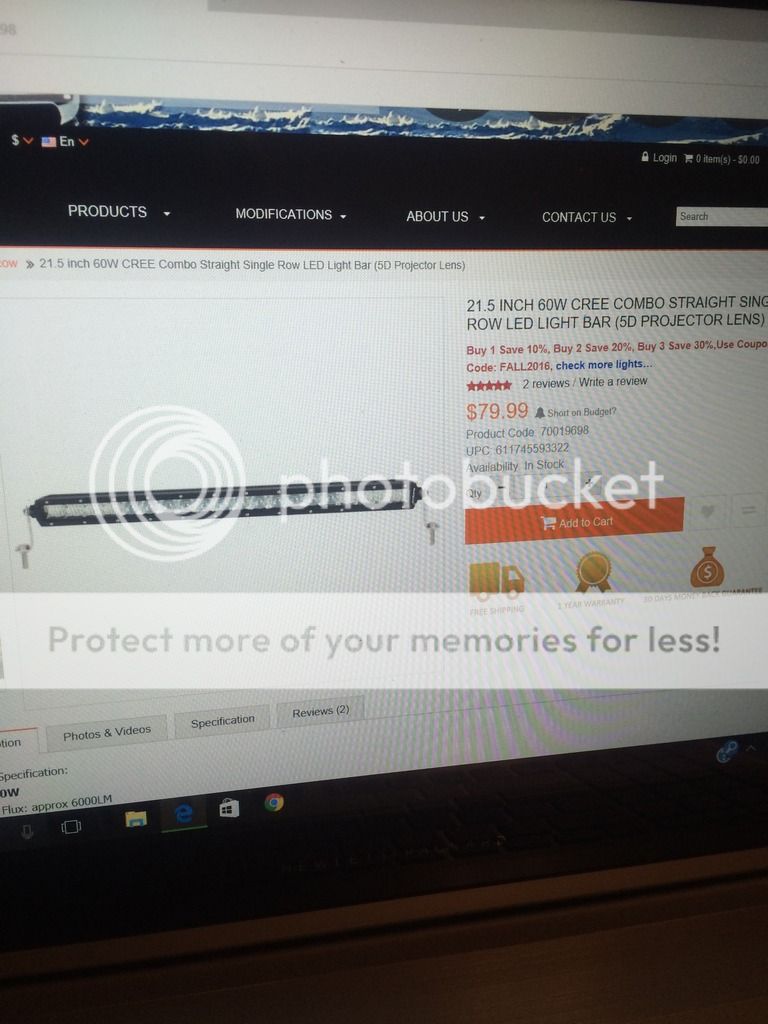

Picked up a 3ft firestik and ordered a light bar. Suggestions on what CB to order? Trying to figure out how to remove the plastic tie down points so I can throw the metal ones in though. They don't unscrew so it has to be a rivet of sorts.

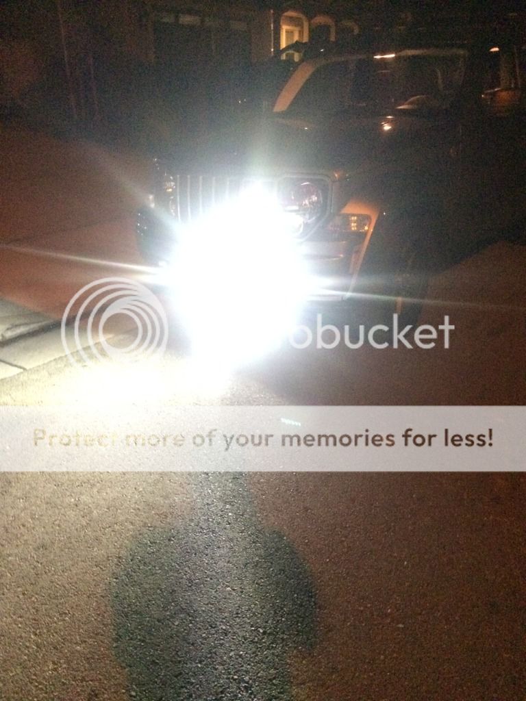

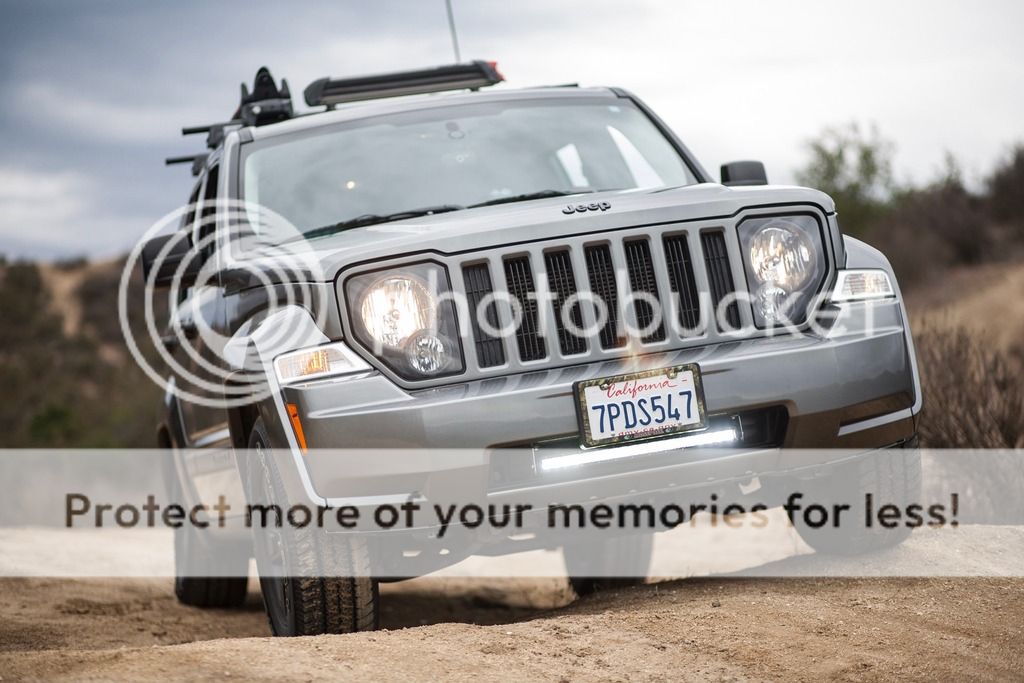

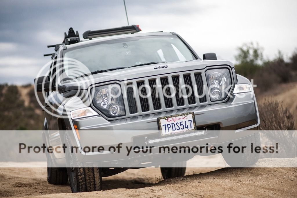

Light bar installed in lower grill. I believe i'll still have enough room for recovery points
Edit:
Couldn't resist adding this, lightbar lit up fields great for filming friends :BANANA:

Sean, I did the trunk anchor mod a little over two years ago now. Just drill out the rivets with a 1/2" bit and using some 1/8" toggle bolts and some washers you can mount them in the drilled holes. Easy day haha.

Thank you, that'll probably get done this week then.

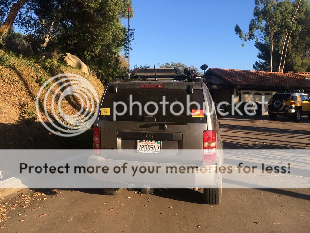

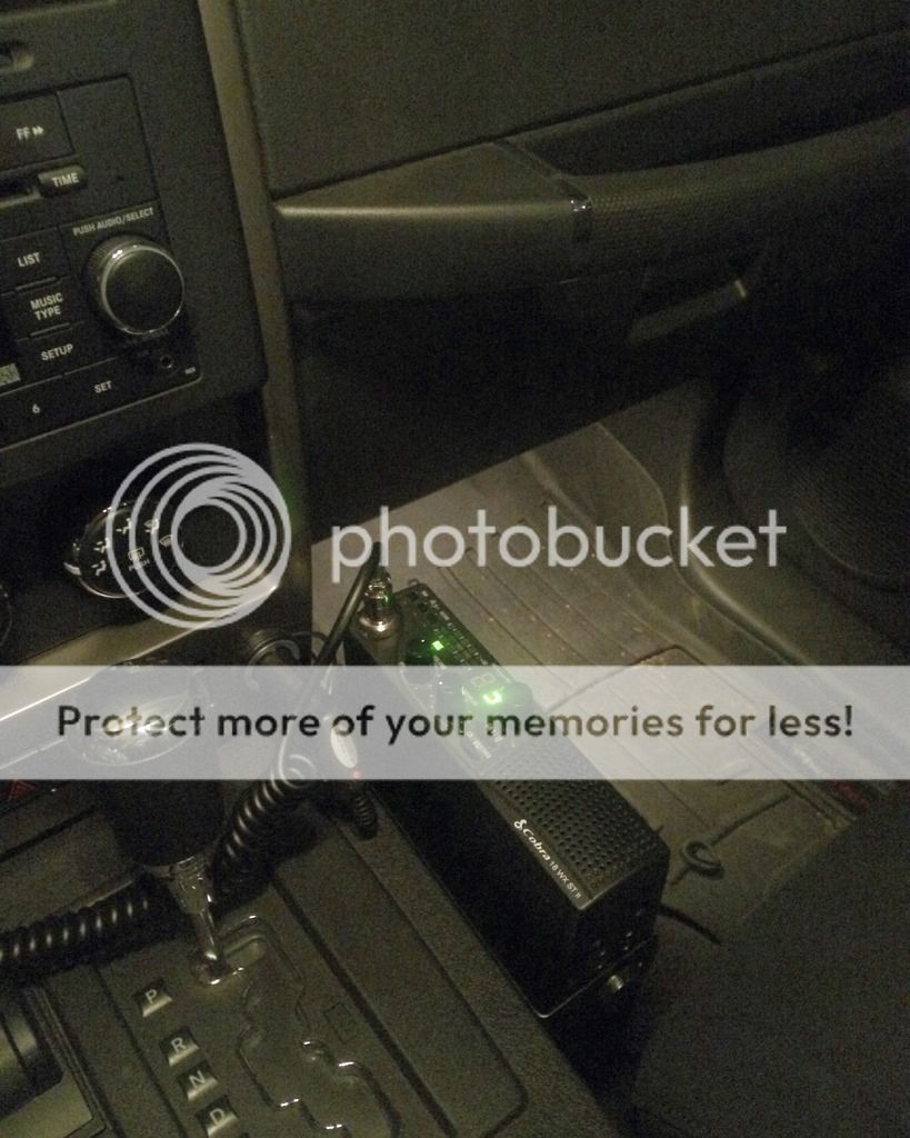

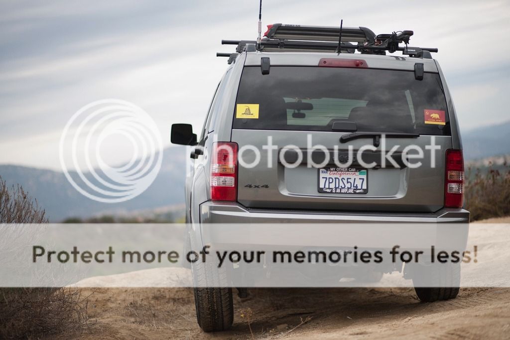

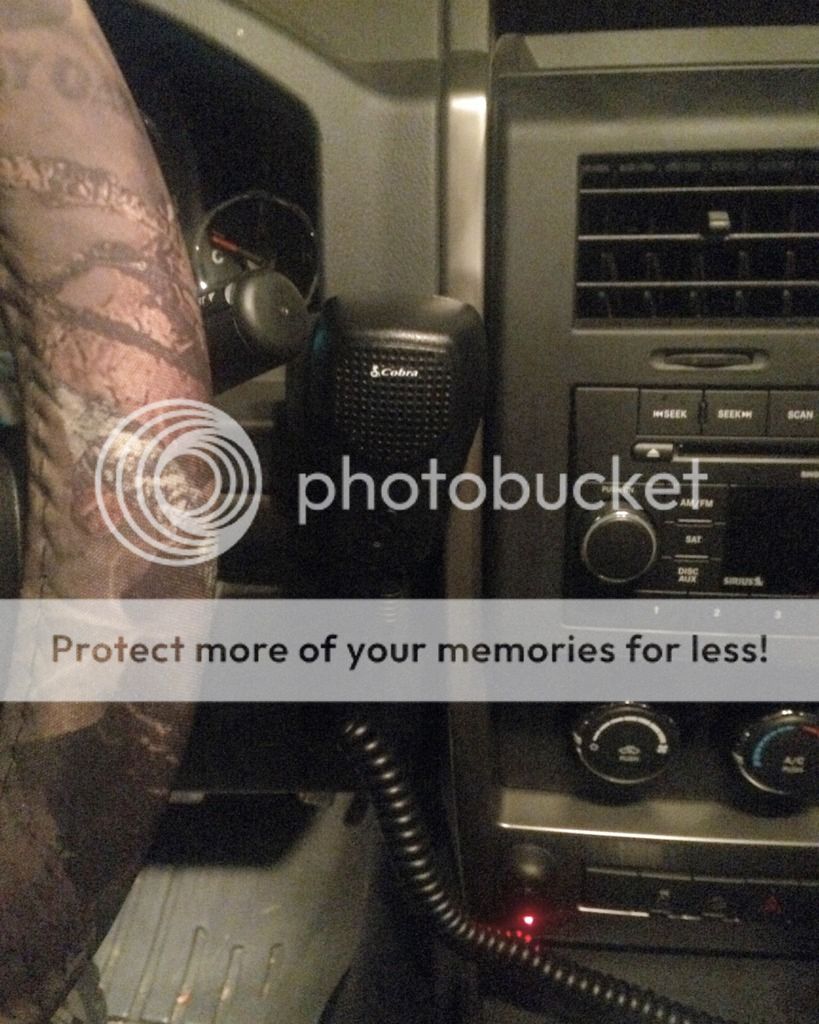

CB is in. Firestik 3' mounted on the crossbars, currently not on until the spring comes in, threw it up in the pic just to see how it looked. So far I'm happy I did it.

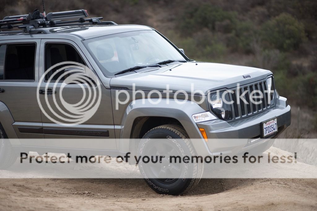

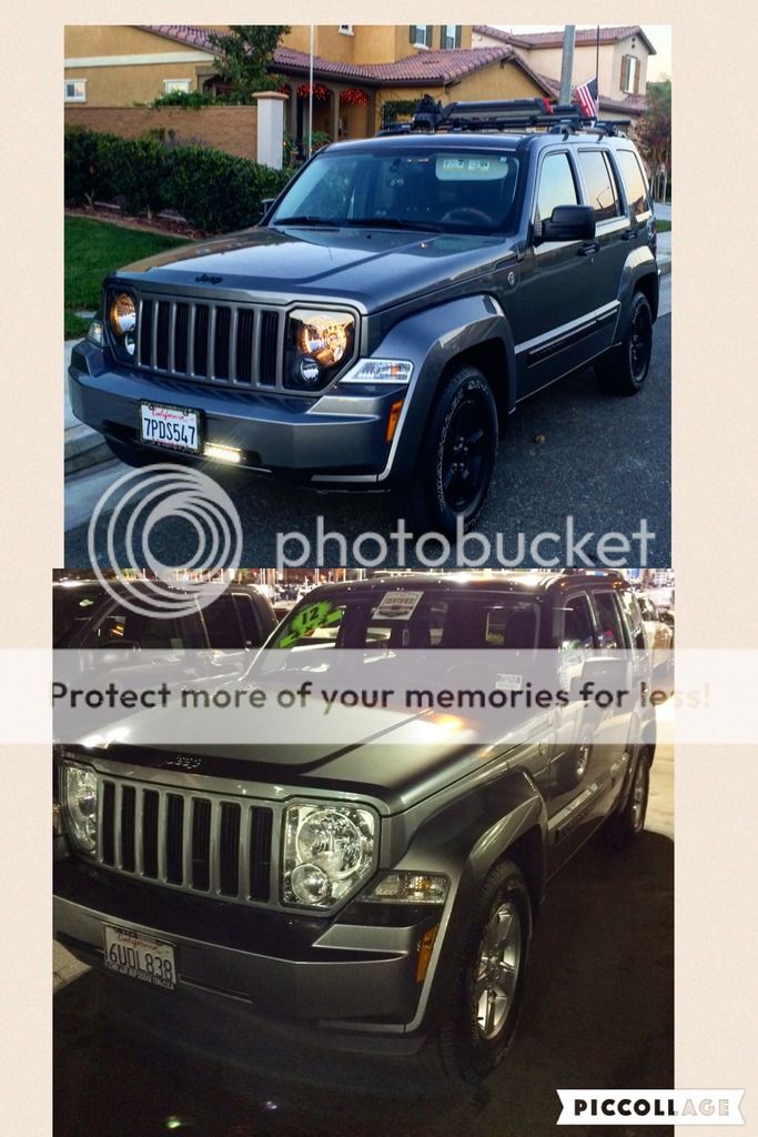

My buddy got some good pictures yesterday in between thunderstorms 8) plus a transformation pic

Beautiful shots of your KK! You've done a nice job with your rig.
