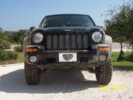

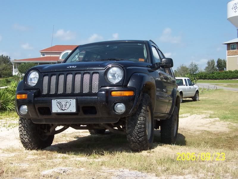

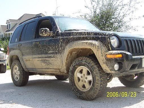

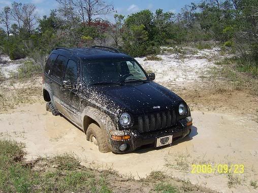

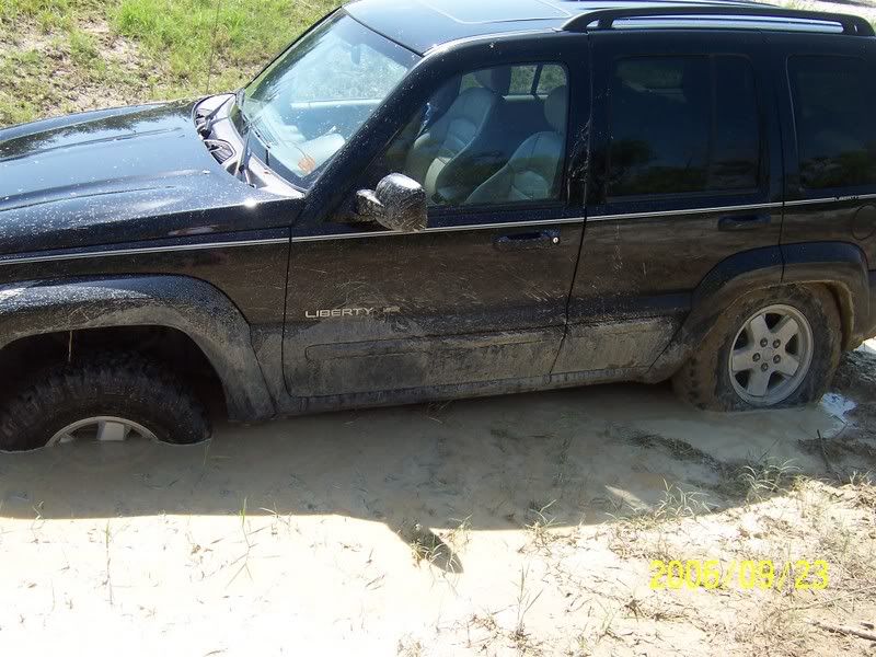

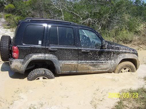

Ive been on the website for little over a year now and it has influenced many of my mods. and purchases ive made for my kj. as of right now i've got a rough country 3" lift, 245 75 16 mtr's, custom back-up lights, 22in dual air horns, highland floor mats, custom grille insert I made, genuine steel black tail light guards, dual air intake ( I had to get it to make room in engine compartment for the air horns, and it does work, i went from avg.16.2mpg to 18.4 mpg). And what is waiting to get put on is an Arb bumper, Warn SDB-210 lights, Warn M8000, 160-amp alternator, and an arb air locker in the rear. here are a few pics of my rig right now.
before i got stuck
when i was stuck
After i got out.
Image[/img]

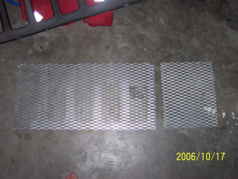

I would love to share. Well i saw some mesh at auto zone and I got to thinking about it, so i went to lowes and bought 2 sheets of expanded sheet metal. i took off the front end and removed the normal grill insert, i then layed it out on the work bench and layed in the sheet metal, i had to take some wire snips to trim to fit exactly, it only takes about 1 1/2 sheets or exp. metal then i had to trim some on the front end in front of the radiator (plastic) then about 2 days later i noticed it had rusted already and not even any rain! i took them back out got the rust off and rattle canned 2 coats of primer, and some high gloss chrome spray paint, 3 coats off that and 24 hours of drying and there you have it. grille insert with about 35 bucks. if you need any pictutes off the pieces i trimmed i will take some... just let me know.

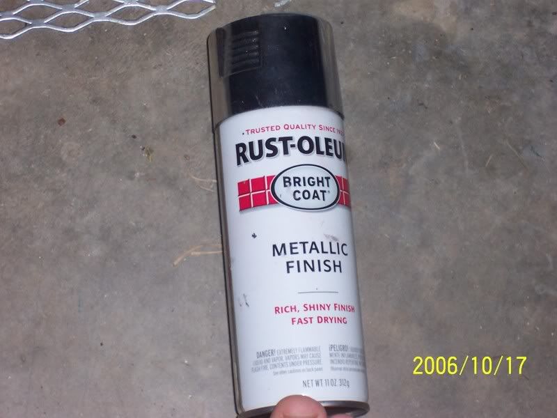

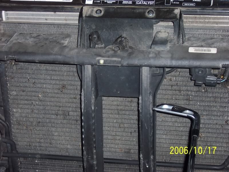

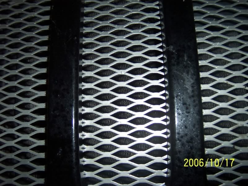

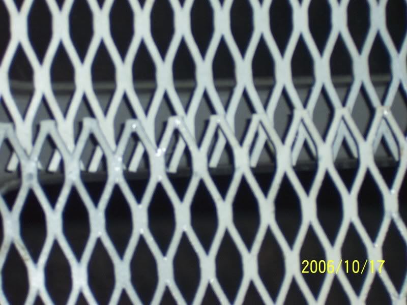

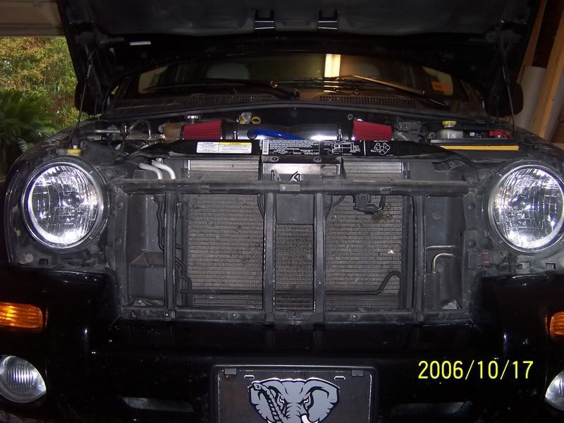

OK. now Ive got pictures so it should be more clear, keep in mind this is on a 2003 limited 3.7l i dont know if it changes anything. this is how i did it.
1. Make your jeep look like this ( remove 4 screws above radiator, and headlights)
2.grind down plastic on grille insert supports ( 3 plastic protrusions(?) on all four supports) edge of golf club.
3.trim your expanded sheet metal to look somethin like this. with wire snips. and prime it with kilz or other primer with 3 coats. then 2 coats of rustoleom metallic finish.
4.what i used
5.overlap them so that where they meet is behind a grille colum.
6.You will have something like this left over. . ( it's For sale! )
7. you should have a finished product something like this.
any moer questions just let me know
