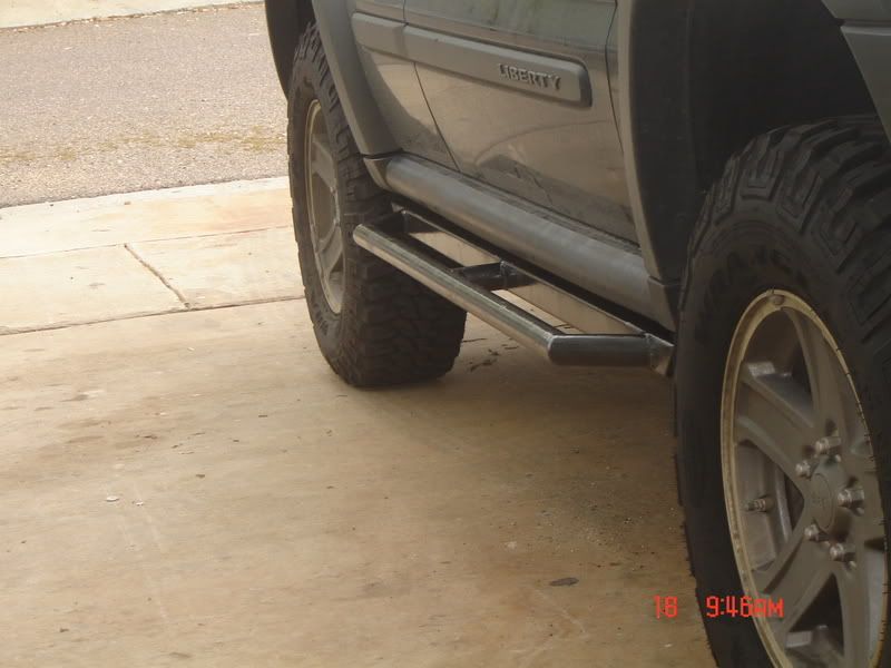

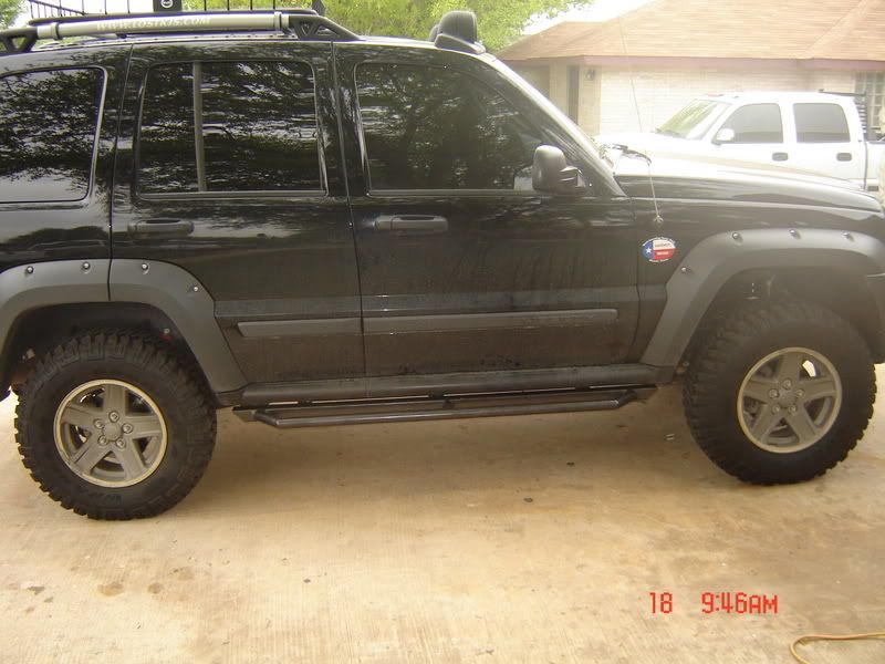

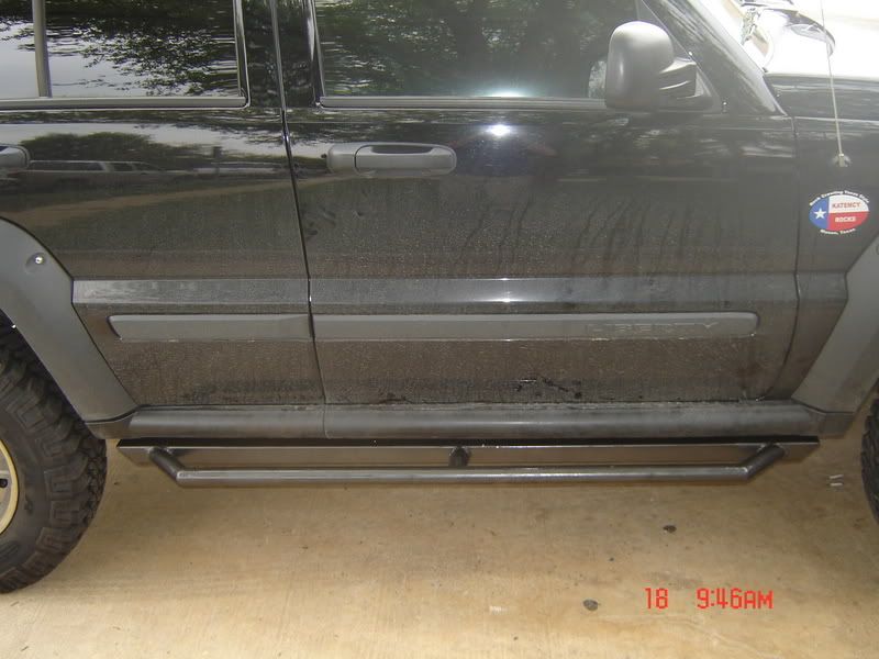

Hey Guys, My dad and I made these this past weekend. I like how they came out, not bad for our first time.

Nice work! Got pics of the mounting?

Looks great! I bet they weight alot though.. Thats some big tubing!
Do you have any pics of the underside/how they mount to the pinch seem and frame?

Thanx for the compliments everyone. I'll try to take some pics of how they mount tomorrow. We bolted and welded the brakets to the frame and bolted to the pinchweld.

I can speak for alot of people (who weld) when I ask if you have any measurements on those... You should get some pics and come over to the Hobartwelders.com board and show those off in the 4x4 section or the projects section...
I'd really like to see the measurements though as I soooo could make those... and would... and hopefully will!!!
PM me dag nabbit!
hehe
Actually I have the Nerf bars installed so I'd just use the same mount points... but I'm more interested in the size of tubings you used and the guage.

looks like 2" square tube and 2" round tube, i'm guessing 1/8" wall

I used 1/4in on my 2x2. 1/8in would bend very easily. I wanted 3/16in but they didnt have any.. :)

main bar is 2"x2" square tubing 11 gauge
Arm bars are 2"x1" rectangular tubing 11 gauge
step bar is 1 3/4" round tubing 1/4" thickness(i think)
