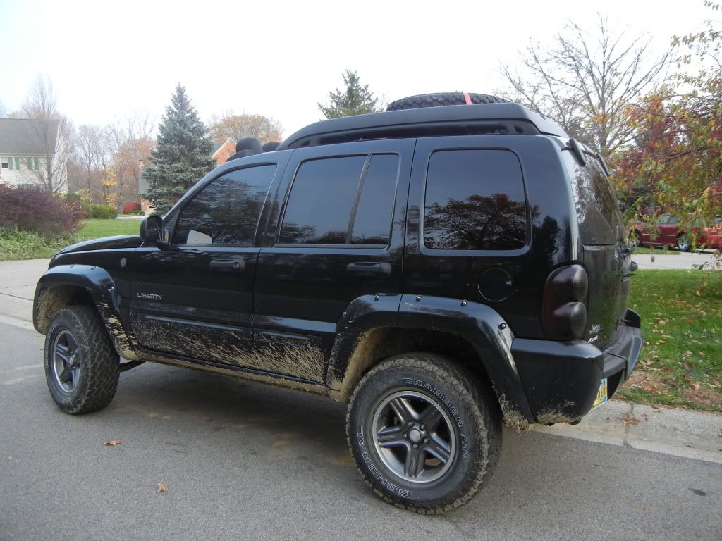

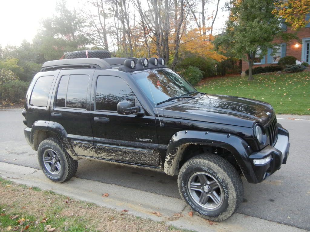

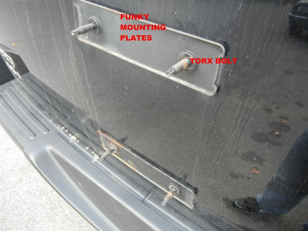

Does Anybody Have A Picture Of a KJ with a tire mounted on the roof? I've been contemplating doing this but I'm not sure yet. Thanks for your pictures gtommec ! Also, can it be done with a 31" tire on a Renegade roof rack? Yes.I mounted it with red ratchet straps today just to see if it works, I will eventually change them to black. However, I wasnt able to get the bolts out of the back or those funky mounting plates off (pictured). How do you do that? Do you go from the inside, behind the trim? Or does some kind of special torx tool get them out? :banghead:

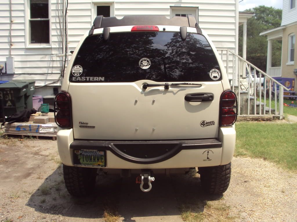

245/75R16 (Measures out to 30.9 inches) It wasn't really mounted per se, I just threw it on the roof and strapped it down.
Why would it be too heavy for the Renegade Rack? A 31 inch tire on a rim doesn't way 65 pounds which is the stated max load stamped on the Renegade Rack, and even that rating is only because the Renegade Rack is foremost a Roof Basket where you put the cargo on the actual roof of the Jeep (not the Rack) and they don't want people overloading and denting the roof.

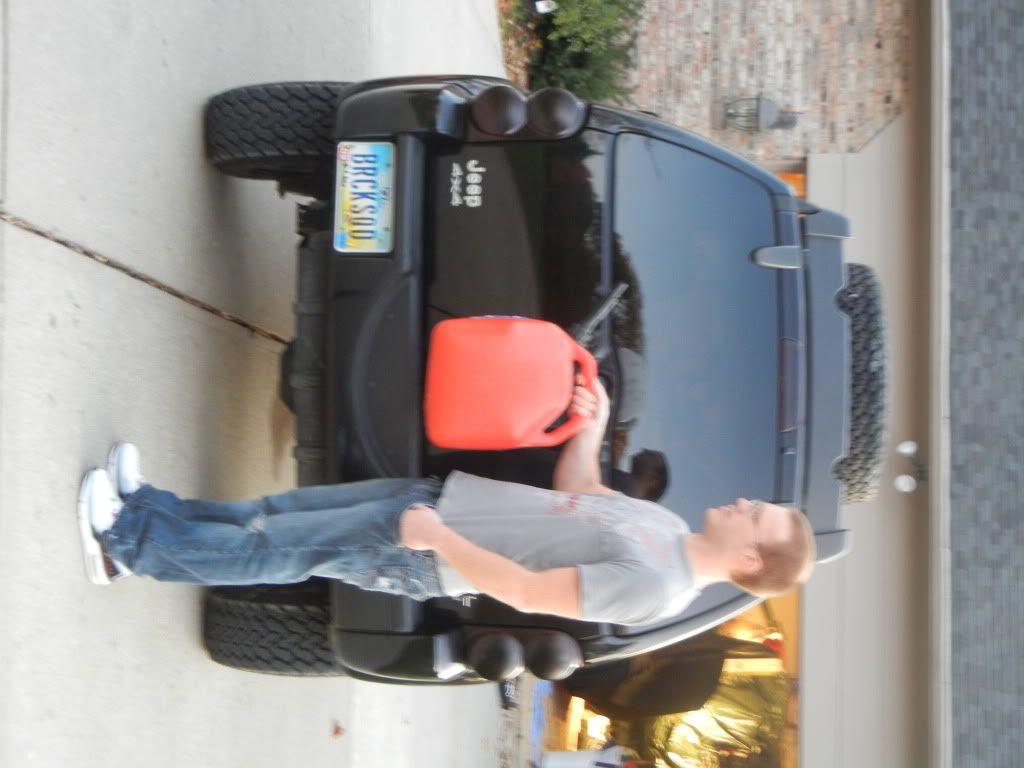

That doesn't look too bad! I think I'm going to mount a Jerry can. How did you get those bolts through the swing gate? Did you take the trim off from the inside and do it that way?

Once I took the E-Torx studs out of the tailgate I just bought some bolts that were the same thread and screwed them into the tailgate (the nuts are welded on the inside)

I just threw the thing up there to see what it would look like.
Jerry can mount :-)r
I think its pretty bad@$$ looking.

The correct way is to get a set of External Torx sockets and just back them out just like a normal bolt, the studs hold the black plates on. I have also seen people use vise grips but they will most likely damage the studs.

Don't cut the rear tailgate bolts off....
...like someone did...wonder who that could be? Poor Tom had a time with them getting them out the person KJ :ROTFL: :mrgreen:

I used a regular 1/4 socket and they came right out, just start off gently.
I've done it a couple times now, and nothing is messed up.

heres another way to remove, take two of the nuts and install on backwards the other one the right way , ( run them back on about half way. Take two wrenches and tighten them together, now put the wrench on the nut closest to the gate and turn out. No special tools, no rounding off the ends etc

So put the first nut on backwards and the second nut on frontwards?

yes install them back to back
tighten together
turn the rear one and it will turn the bolt right out
old trick :wink: been using it more than likely double the time you've been alive :lol:

That's right then put your wrinch on the backwards one and back it out. The two nuts together is creating a jam nut this alows the first one to back the stud out and not unscrew off the stud.

Double nuts...saving knuckles for decades :lol:
