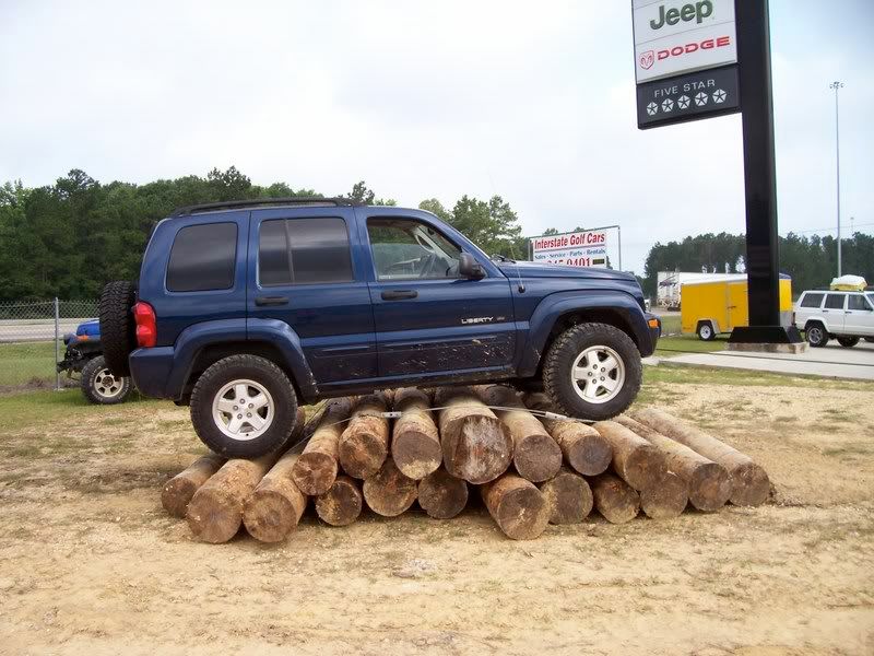

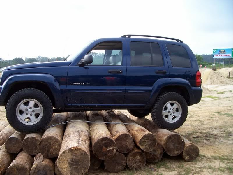

here are the only 2 I have of the KJ post lift
OME 245/75 mtr

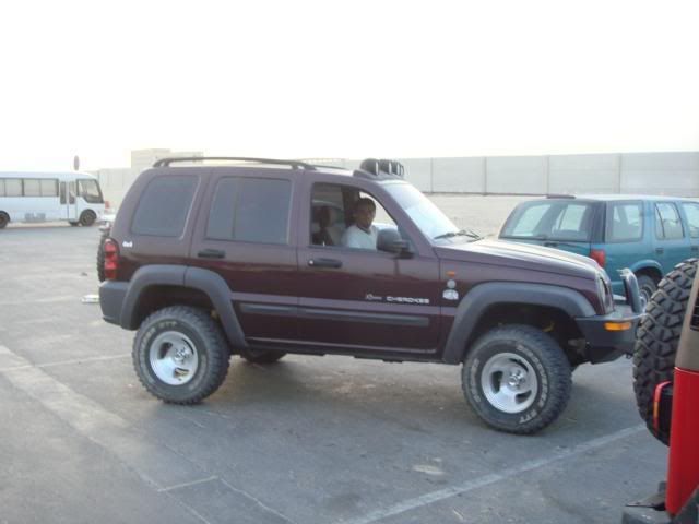

here is mine

bigmd wrote:
what is the actual amount of lift the ome springs give?also,will they level out the truck or is the front still going to be lower?
the amount of lift will depend on how much sag your jeep has over ,or rather under stock
we netted 2" after 5-6K on the lift
we had 36-38K on the KJ when we lifted it
It will not sit level it will keep the factory rake
how ever a small clevis lift will level thing out

ya jjay im curious too about what your lift is and what size tires and rims those are.. that is one mean looking kj

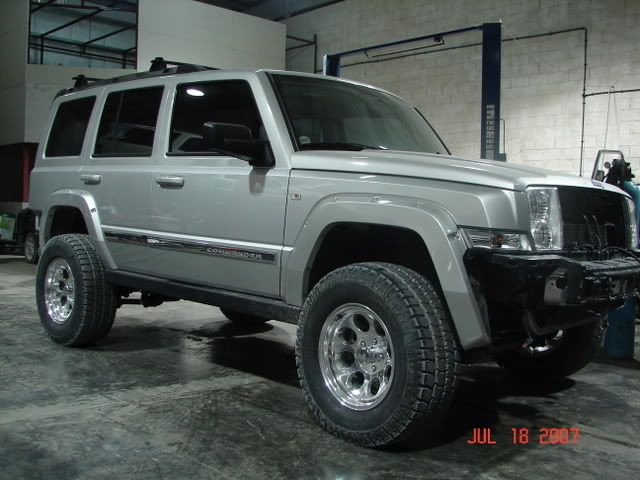

its a standard 2.5'' OME, but jeep guys added something on top to lift it to 4''. Then I got jeepinal upper arms which where reinforced at the welding point. Also fixed moog ball joint. its been 3 years and no probs
I know the usual question is cv joint...well no worries so far, but im working on custom made lowering kit...yet again I say ive done so many jumps in the last 3 years and nothing broke...except for side fenders :roll:
ive got 31''cooper al terrain, rims are 15 but 10''wide...no spacers involved. I can go up to 33s but desert driving includes good jumps on top of dunes ending with nasty rubbing...31s are doing fine
check out what my mechanic did for the commander...same way...cost heaps more but proper...mine is all experimental :cry:
Hemi 5.7...5.5'' lift

tires on commander are 33''
