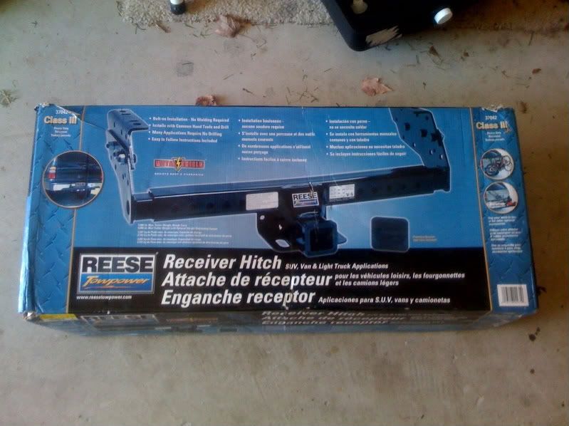

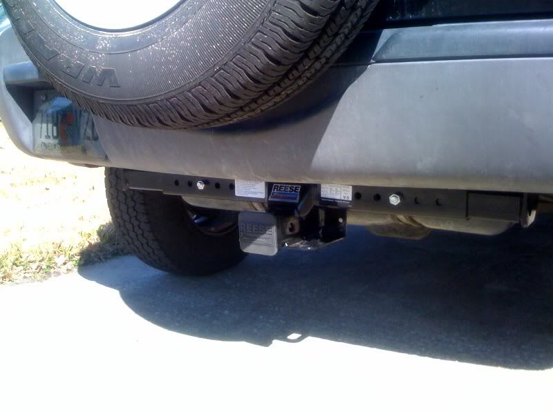

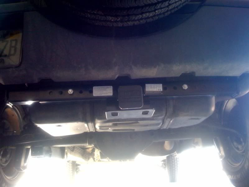

New mods!!
A hitch!! Rear recovery point ftw! :D

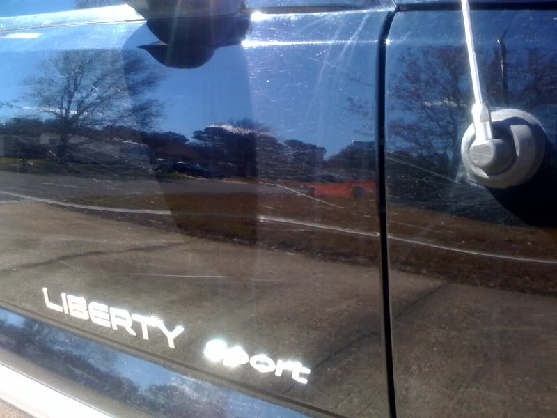

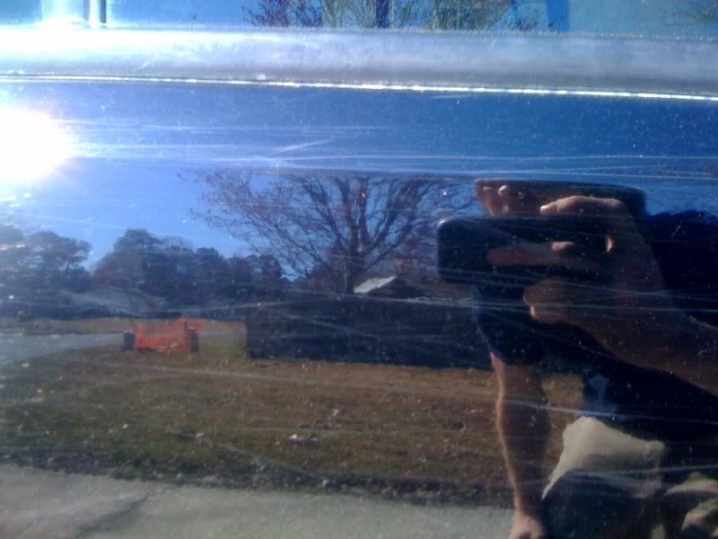

And some organic pinstripes, Courtesy of Ocala Ntl. Forest. :D

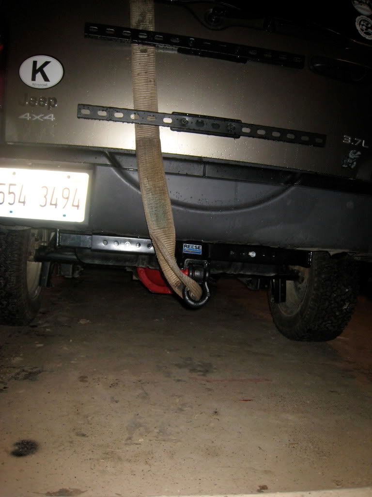

budke, take it off and then move those brackets 3 holes higher...thats what i did with mine and it sits higher
before (notice u see the whole thing)

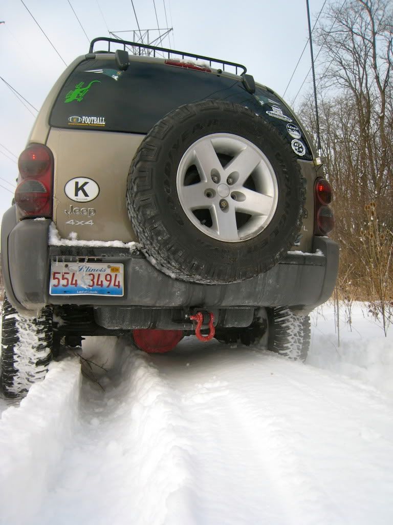

after (cant see the bar, just the receiver hole :) )

Sweet.
I'll have to do that when my weekend starts on wed.

yup, just make sure that you put the 3 torque bolts in the same holes on the part thats connected to the hitch, move them up 3 on the L bracket pieces that bolt onto the frame :D

sure no problem...its pretty straight forward...i was just getting pissed of getting the hitch caught up on everything, it sits at least 1/2 inch lower than gas tank, once i raised it, it was all good

Is that unistrut I see?

lol, yes...was used for a jerry can mount till i got rear ended and it ruined the cans..back to the spare :/

darn those trees raped your paint.

i know. :shock:
And I didn't even have ANY before that. hahah
