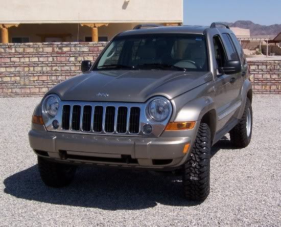

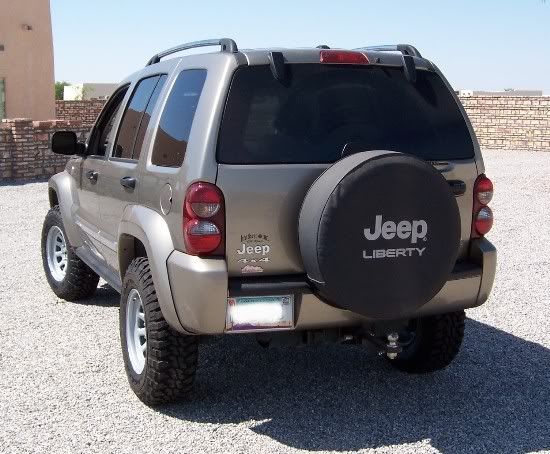

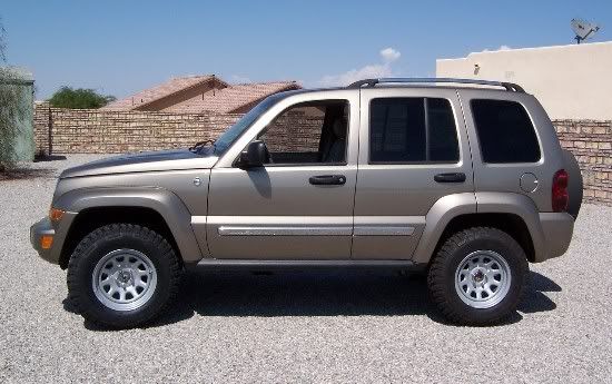

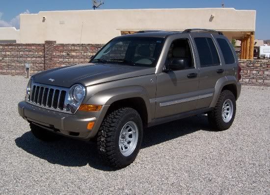

Cooler weather is just around the corner so we've been geting ready for our off-roading/prospecting season.
The new tires and wheels are on. Goodyear MT/Rs in 245/75R16 on Crager D-Windows, 16 x 8 with 5 inch backspace. We didn't have to touch the pinch weld. They do rub, very slightly, on the front plastic inner fender liner. But, as one member put it, "The tires are a lot tougher than what they're rubbing on."
The Super Skink sliders should be here in a couple weeks. Then, we'll be set for winter.

so what color did you paint the wheels? looks good!

Tom ~ I didn't paint them. That's Crager's version of silver.

Lookin good! Like I always say, they should come from the factory like that!

Well........ after letting the suspension articulate a little bit, I did some trimming behind the front bumper and knocked down the pinch welds.
I don't mind taking the razor knife to the bumper now that the Mrs. has approved a new front bumper. So, I emailed RL and asked him to put me on the waiting list for a Rock Monitor bumper. I'm hoping that with an expected weight around 60 pounds, I won't need to change my front springs. I guess time will tell.
