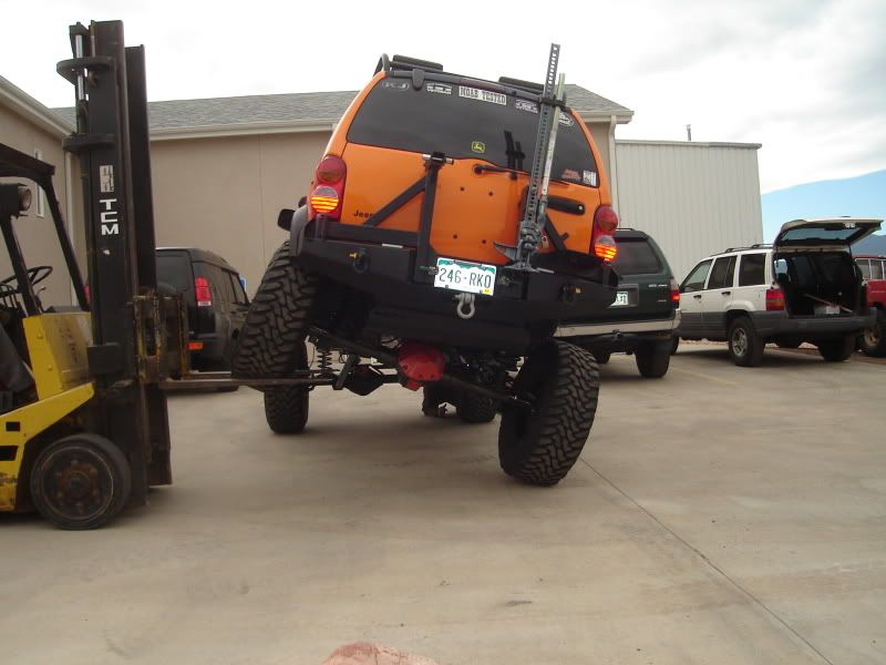

Well just decided to post some pics of the KJ flexing,just getting the last few measurements for rear shocks and front bumpstops.The below pics are not at full flex yet due to the wrong shocks on the front(which the upper coil mounts will be made to so those shocks will be right).
The above pic the rear bumpstops have yet to touch but due to the front shocks being bottomed out didn't want to flex it anymore and ruin them.
Above shows not impressive flex but again when the mods are done will net about 2.5"-3" more down travel on front passenger side and the same amount of droop on the drivers side.

The shocks that were on the front are the ones I will be running,but a brand new set,and will have to adjust some things(at a later date) to make them work(I like the ride).Oddly enough(and pissed me off) was the temp rear shocks that I have on,and removed for the flexing to measure for rear shocks,ended up being the correct length ones,all that work for nothing.
