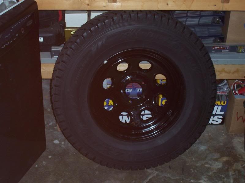

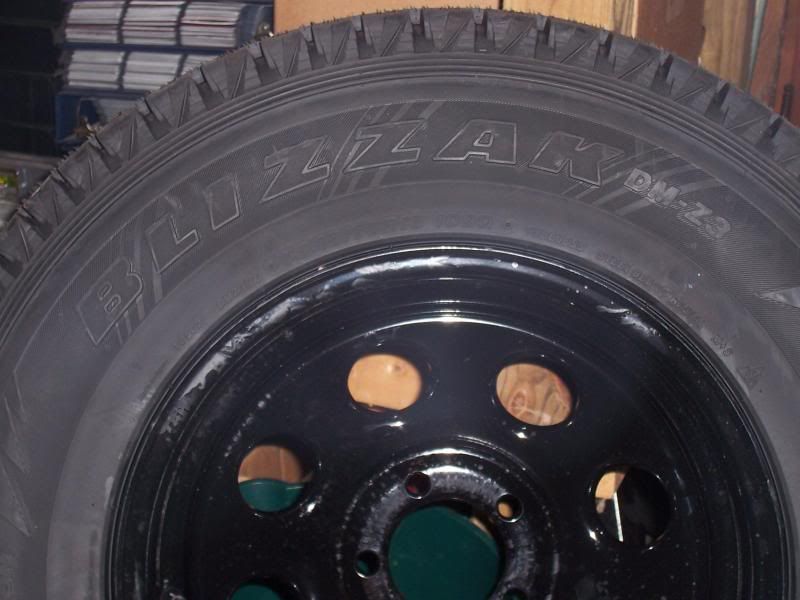

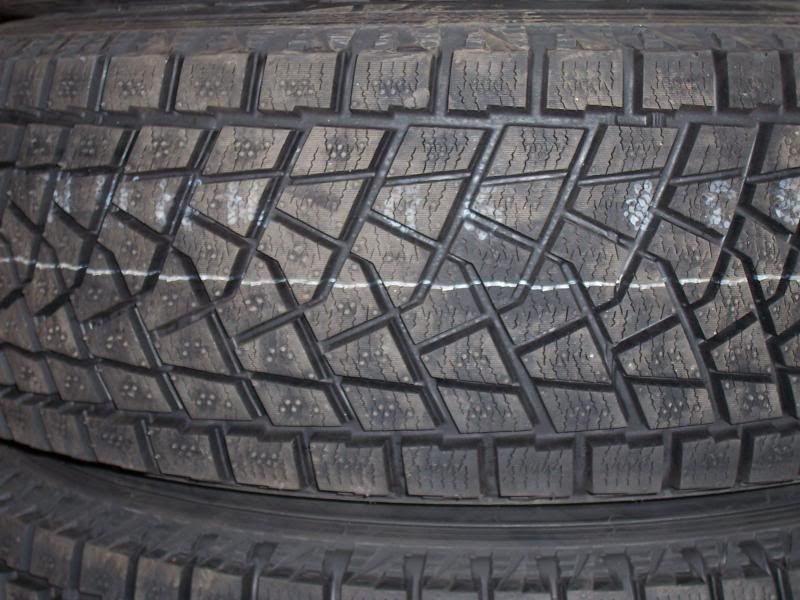

They are 245/70-R16 Cooper Discoverer CTS. Around Thanksgiving I'm going to get an "after break-in" alignment and put my snow tires on. I have 245-75-R16 Bridgestone Blizzak DM-Z3's with Cragar Soft 8's.

Heck yeah! Looks awesome! Your gonna tear up the snow with those tires. 8)

Those snow tires and wheels are awsome. They are going to look great!
