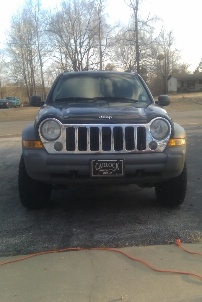

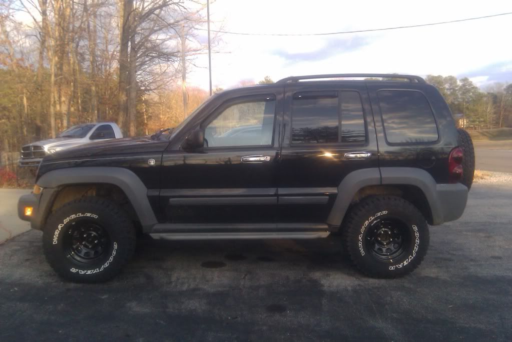

Went to my local 4Wheel Parts and came away with this, and a new Detroit True-Trac front diff!!!
Before
After

They are Procomp 15x7's w/3.75"bs
And now, about those door handles.......This thing had alot of chrome on it when I bought it used. Took off and sold the brushguard and step rails, left the chrome grill overlay when I seen how scuffed the factory one was underneath, and the door handles are glued on or something, so those also stayed.

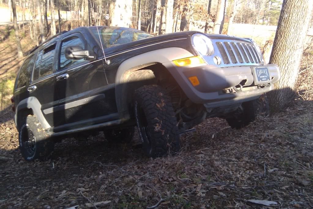

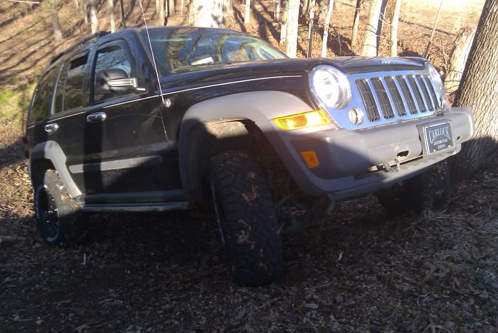

I have a very slight amount of rubbing still on the lower front fender lips/air dam that I'm just gonna leave it at that. Onto the rear pinch welds; I still have a bad rub in full-lock turns when the suspension cycles downward at the same time even after most was smashed flat already (all but the very top 1" of the seam), so there's a little more work to do there also.
A couple pics flexing things up on a little trail next to the house to see were the tires rub.
