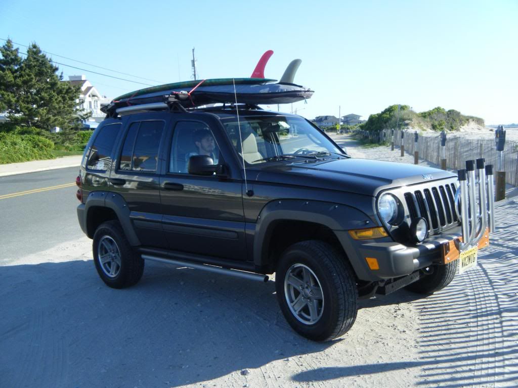

She's not a rock climber or trail blazer, she's a beach buggy that takes me fishing and surfing.....
2005 KJ Renegade
3.7 Lt. V-6
2.5" Daystar Lift
Thrush Welded Muffler
K&N (Poor Man's) cold air intake
Goodyear Duratrac 245/75-16

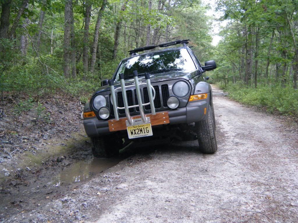

I like the mounting of the rod holder. Have any more detailed pictures of that?

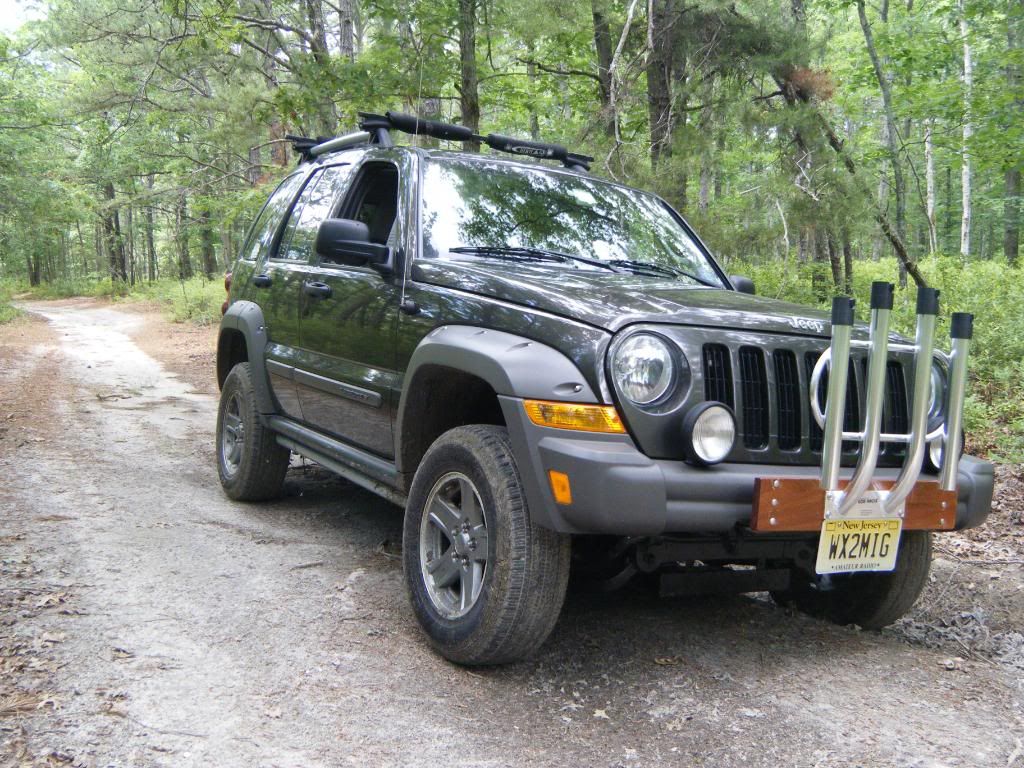

Dan.... I bolted two 10" heavy duty "L" brackets between the tow hooks, and tow hook brackets, a piece of 5/4" X 6" mahogany deck wood carriage bolted to the up right ends of the "L" brackets, and the rod holders are bolted to the mahogany that has several coats of spar urethane....

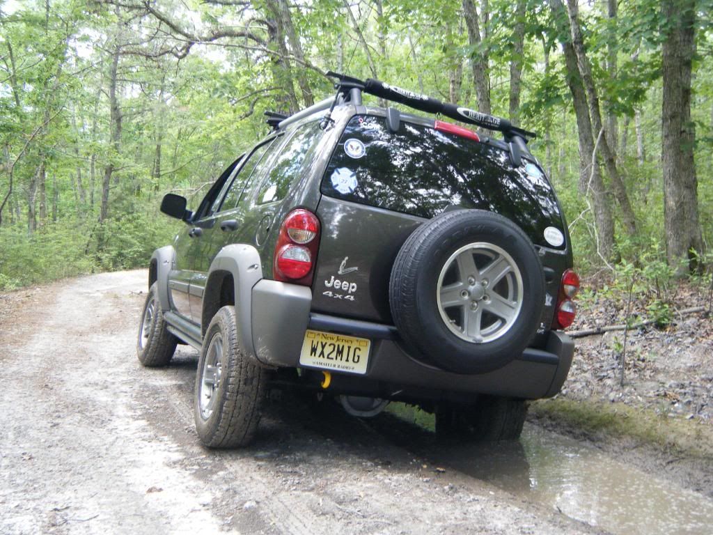

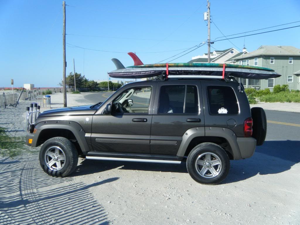

Here's a couple more shots of her on the beach.....

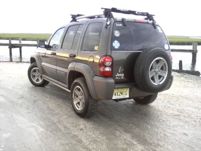

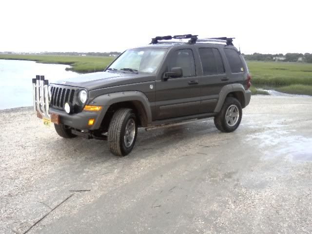

Took a couple more of her while checking out an old dirt road access to a back bay fishing hole......
These can also serve as my "before" photos, after I get my 2.5" Daystar lift kit installed I'll snap a few more off for "after" photos.......
