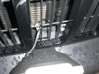

The two lights, their wiring is zip tied to tyblocks I placed behind the grill and forward of the condensor/radiator. It came out nice I think. I was worried that with the style connectors I used, I would have trouble with shorting to ground when it was wet, but I havent had any trouble yet, if I do, I will seal the back of the connectors with silicone.

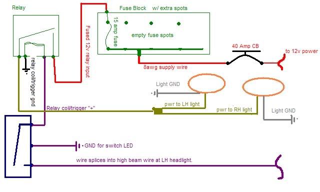

Heres the basic wiring diagram. I left out my connectors, mainly to be less confusing, and because paint isnt the easiest thing to draw schematics with. I used different colors to make it easier to read the labels.

Sweeeeet, wish my setup was this neat!
I am now ashamed of my setup, lol.
