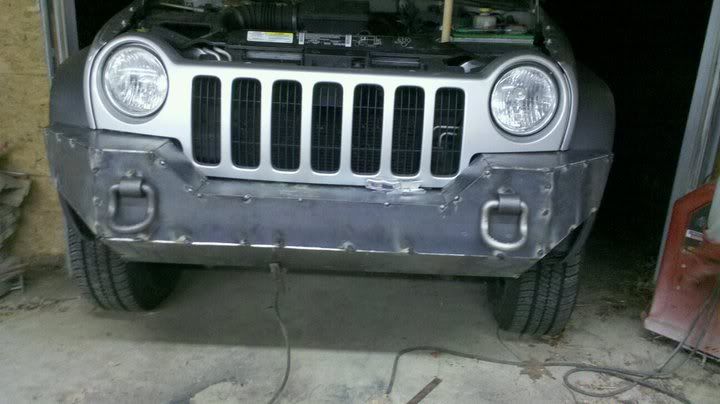

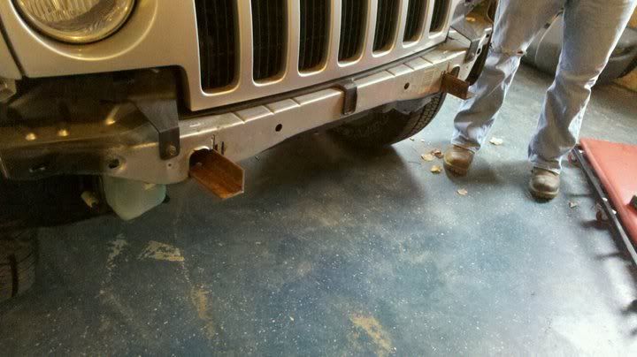

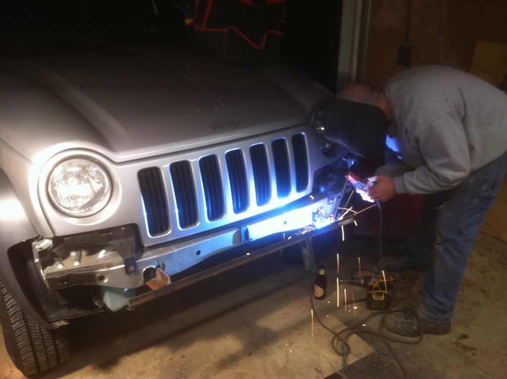

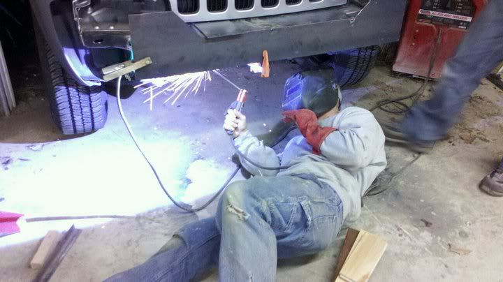

My bumper is actually completely custom... We welded that sucker with 3/16" steel and mounted those shackles for some "adequate" front tow points. Came out a little better than I had hoped, so that was nice. Here are some pictures of the bumper build:
Our place to mount:
Our 2 mounts with the crossmember:
Mock up with 3/16" Foam Board
Tacked together:
Bumper w/out lights:
Finished bumper w/ lights:

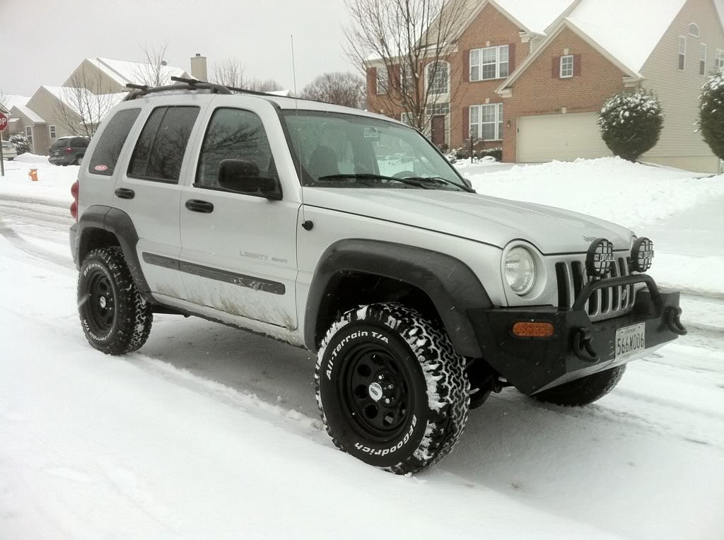

Out having fun in the snow:

Noting you have done most of the work yourself, how much do you have invested?

Including everything listed in my signature, probably about 2k.

I like the beer in the second picture. nothing like a little slag in your brew. :ROTFL:
That looks like a new castle to me, excellent choice!

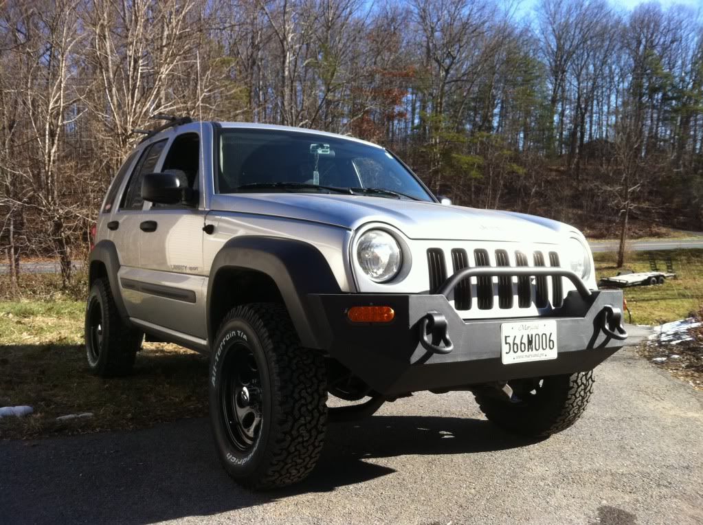

I thought is would post a few more pics:
