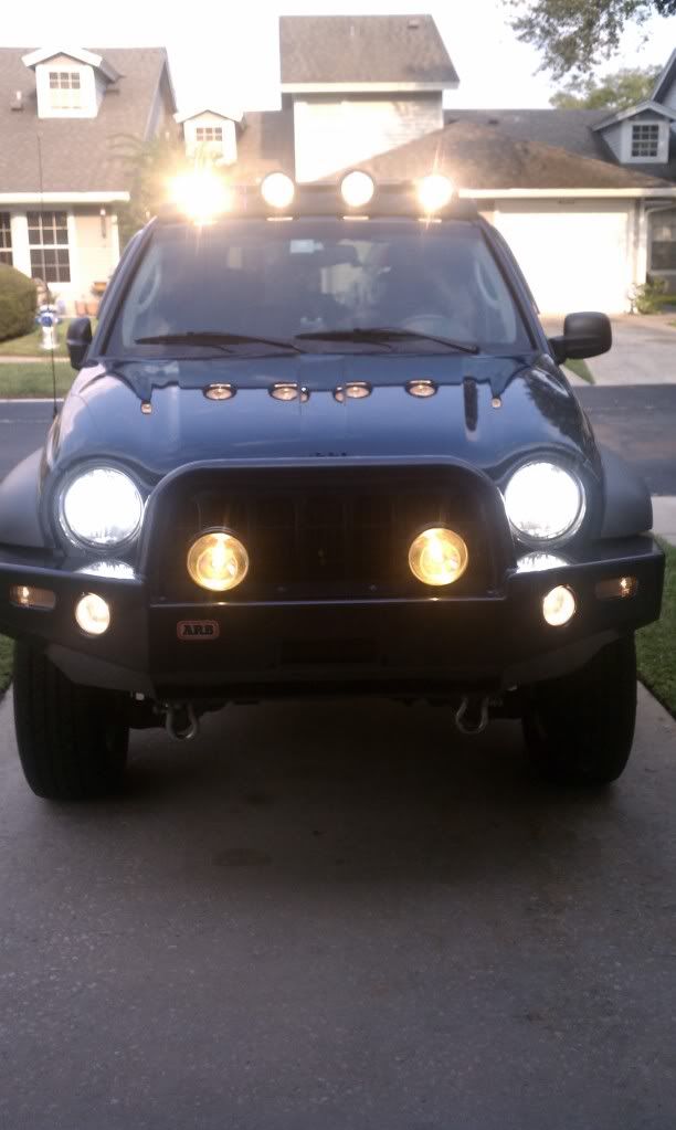

 Post subject: Lightbar = Installed
PostPosted: Tue Sep 20, 2011 5:16 pm
Joined: Thu Oct 07, 2010 8:58 pm
Posts: 38
2006 KJ 3.7 4x4 Selectrac / OME Bilstein lift + isos + 3/8 top plate/ ARB Bumper / RL Sport Gecko rack / Rene light bar / Spidertrax / EVIC /
 Post subject: Re: Lightbar = Installed
PostPosted: Tue Sep 20, 2011 5:18 pm
By golly you are right
its installed :wink:
looks good

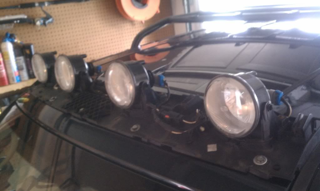

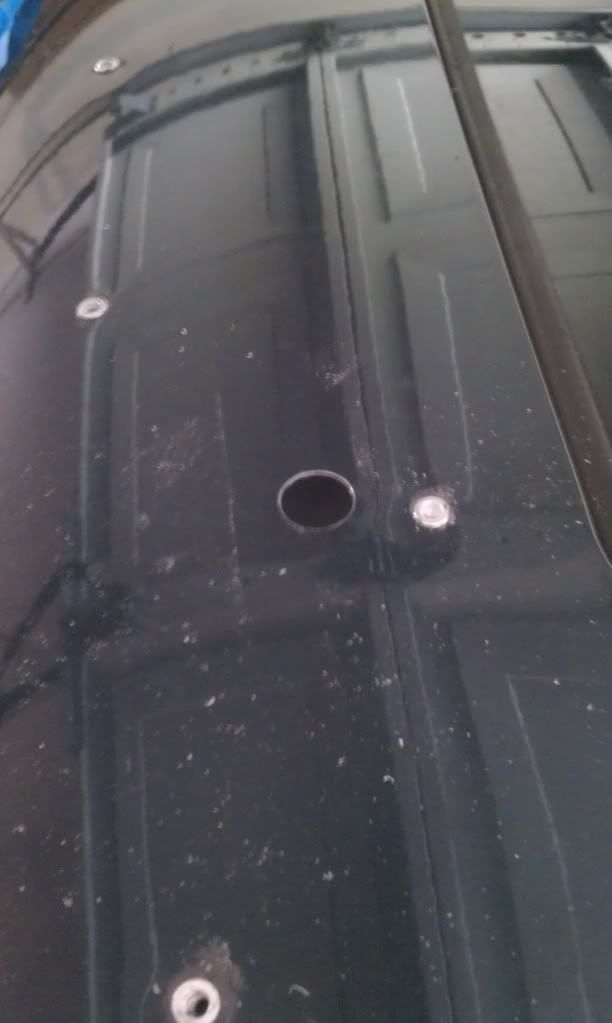

Very simple install,just make sure you RTV all the holes very well!
PostPosted: Tue Sep 20, 2011 5:31 pm
Posts: 38
Been a few days since the install.. used plenty of RTV.. I've washed it and it has rained already.. No leaks!.. So far...
Didn't have the wiring. . so I just used a 40amp relay and a switch with some 12g wire.. works like a charm.
