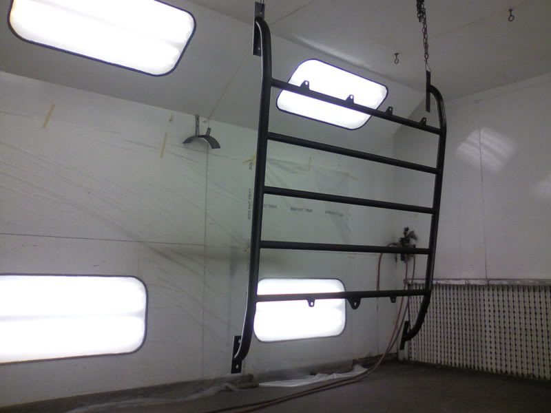

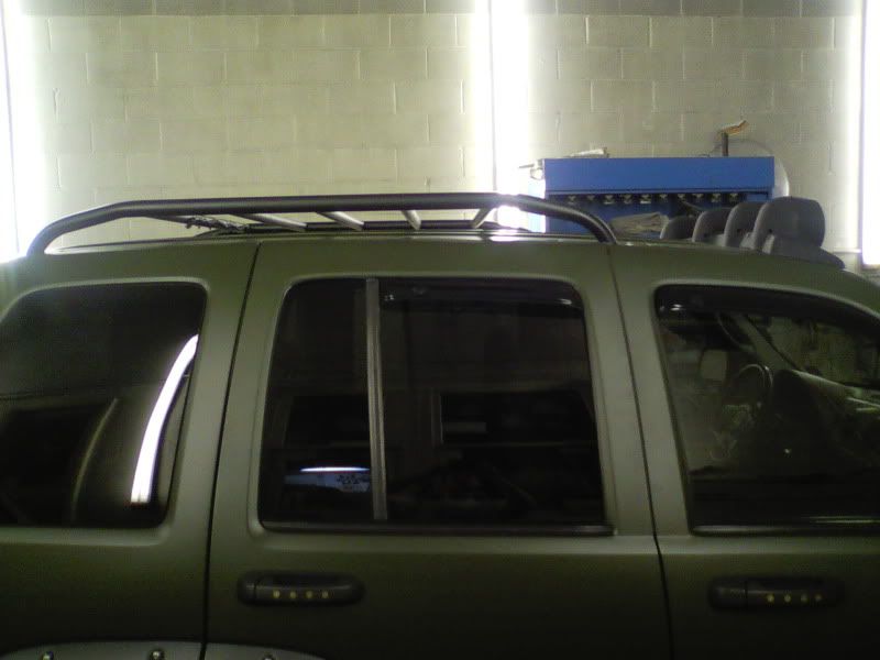

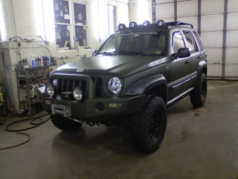

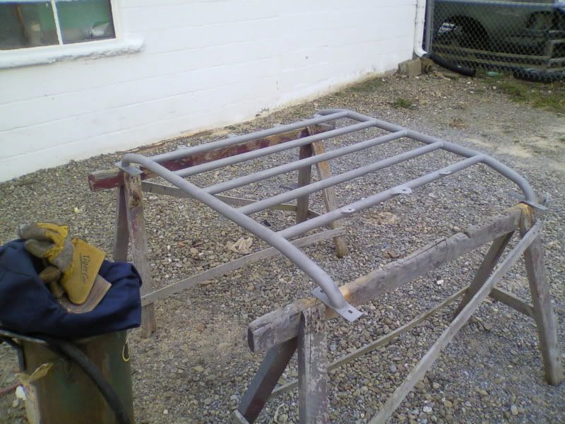

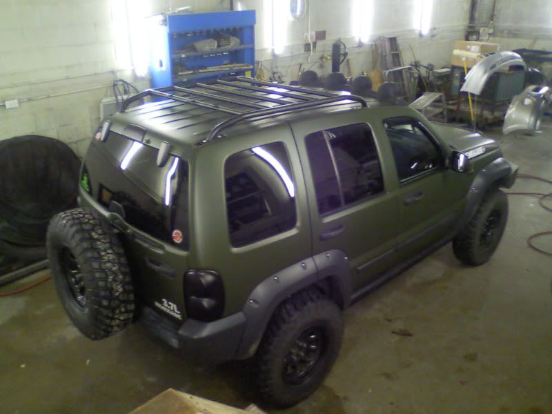

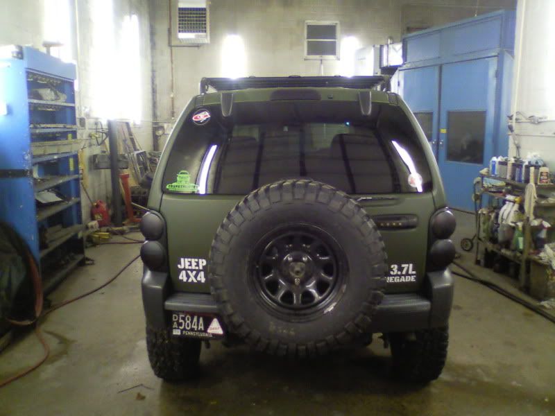

RL roof rack and some in-channel vent visors! sand blasted the roof rack.. then 2 good coats of black DP90 epoxy self etching primer, then flat clear coat. :twisted: :BANANA: :BANANA: :BANANA: :JEEPIN: That system is very nice because i didnt have to touch sand paper at all. you can DP90 right over sand blasted metal, and can clear right over DP90 8)
Takes a while to get a RL product.. but worth the wait. outstanding quality.

Wow, looking great! I had to drill out the holes a little bit on mine to get it to fit right.. any problems with yours? What size tires are you running?

mine took a little stretching of the holes to fit as well. Then some larger washers for the bolts. tires are 265/75/16's

like tom said yes it for sure will! in fact... it comes with 4 light tabs on the front cross bar and 2 light tabs on the back bar (as well as a CB antenna tab). Also i just drilled the bottom one mount then the side of the side bar to run some wire through my roof for some back up lights i have on my roof basket.
and a spare tire wouldn't be a problem. this rack is crazy strong. i wouldnt think twice about putting 4... or 10.. spare tires up there haha. i think the nutzerts in the roof will give up before the rack does. and that would take a lot.
also thank you for all the compliments! the jeep is still a work in progress.. its come a long way from stock.. and has a lot further to go
